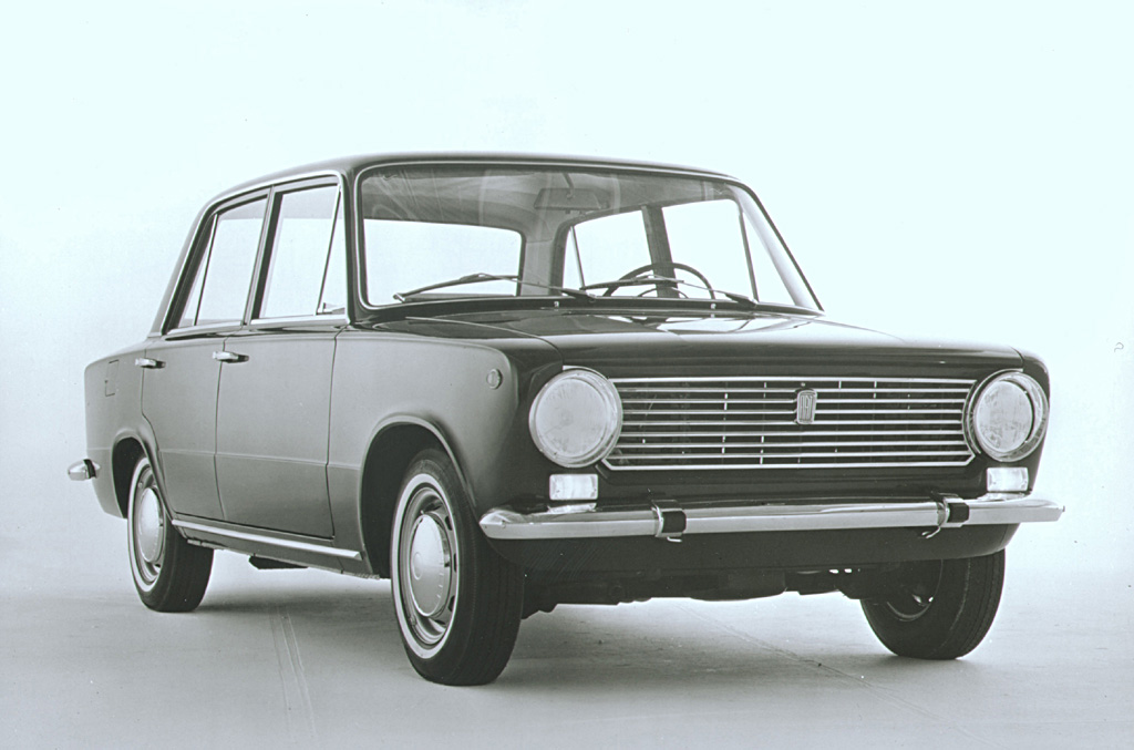

                    Woo! That is a neat little car. Looks like an Italian Datsun 510. Which came first?
                      The 128 design was derived from the 124 berlina. Which was designed in 1964 and first sold in 1966. The first 510 came out in 1968.
                      Many Japanese GT's of the 60s and 70s were styled after European cars. There are also a few Bertone , Pininfarina and Giugiaro designed Japanese cars.
                      This is the 124 from '66
                      This is what I get for working at a vintage Italian car restoration shop. lol
