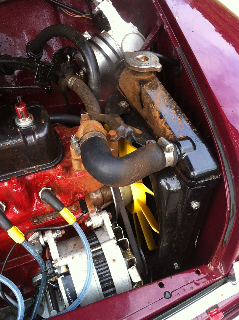

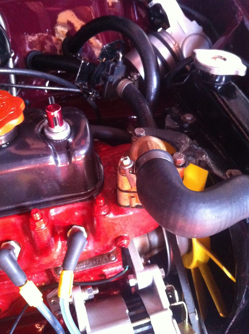

Today however! Since the weather was amazing I thought, lets take the Mini to work! Then as I was burbling along, it came up to temperature.....and wouldn't stop rising! Pulled in to steam billowing from the bonnet. Oh dear! Turns out the top hose jubilee clip had worked its way loose and spewed the contents of the rad all over the bay. Lovely rusty water and antifreeze all over my clean bay.......
One naughty Mini......
One dirty bay....
Nursed it to the BP filling station and my dad came to the rescue in the Honda, we topped up the rad and swapped cars so I could get to work. In the 2 minutes we were there a woman came over saying how she had one years ago and the top hose was always coming off and her fan belt snapped in the middle of nowhere and she used her tights to fix it. Proof that it works! Then a tanker driver said he had one and had 3 gold seal engines for it over his ownership. You dont get that chat with a 'eurobox'!
And whilst I was at work dad cleaned it all up. The antifreeze has damaged the paint on a couple of bits but nothing a lick of paint wont fix again! Thankfully the body colour paint is fine!

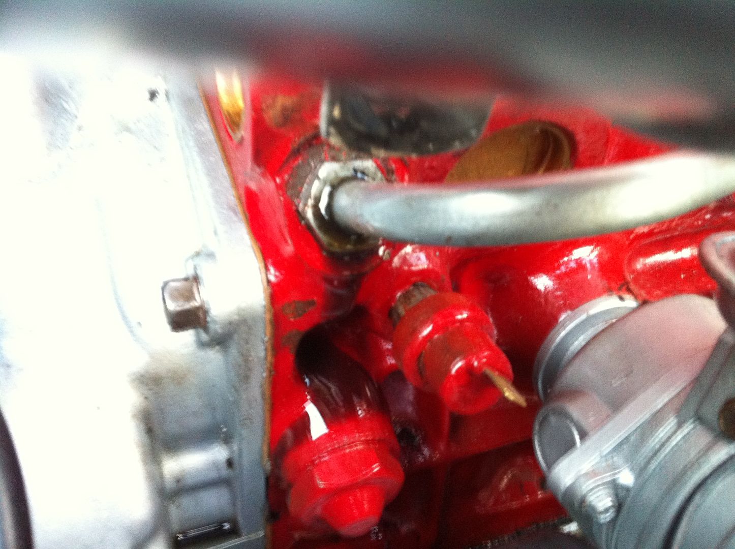

So as some may remember the car leaked a fair bit on the run to and from Tain. Thought it was the loose oil filter (it was to a degree...) but it was still leaking. Couldnt think where from until i noticed tonight there was a lot of oil firing out of the oil pipe going to the filter housing......
So for now, I've tightened this up, cleaned and thrown in some instant gasket. Sourcing a braided replacement with proper unions instead to prevent the leak reappearing though.
