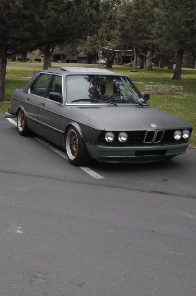

    i need to do some coilovers bad. but as far as the front bumper, I like it. I do think it kinda needs some type of moulding though? I'm currently working on a project similar to it but used the stock mouldings
    welp, I was going to do "eurobumpers" but I just decided shaved would be better, I didn't like how the mine were turning out. yours look to be coming along nicely though in fact from what I see your automobile looks great!

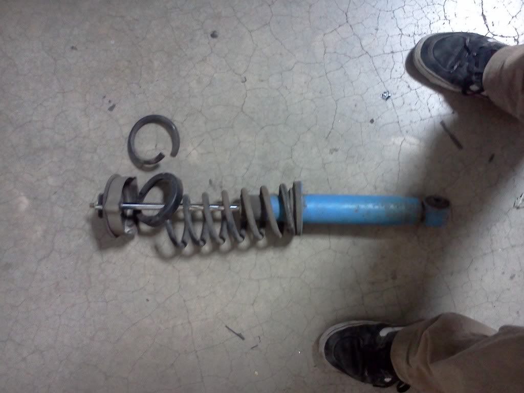

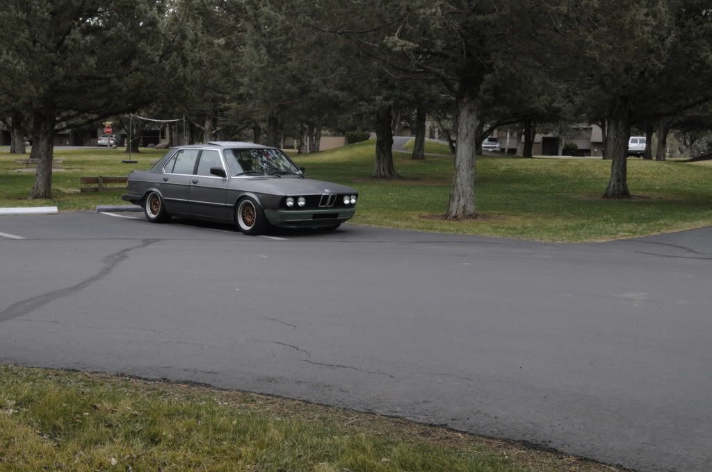

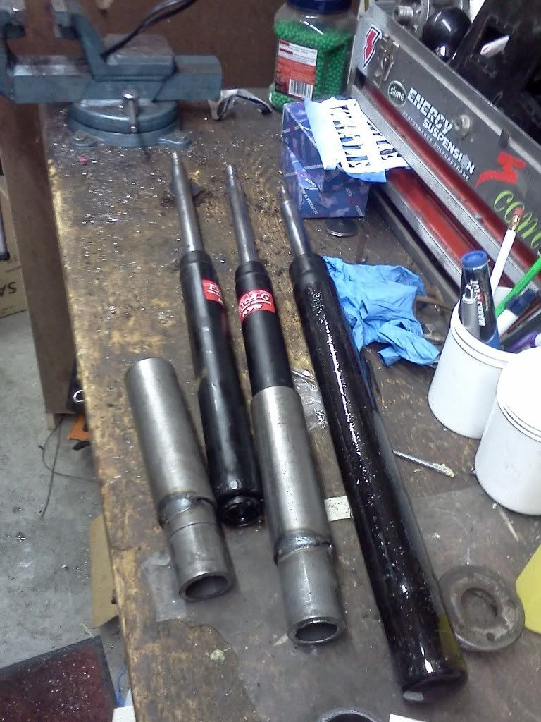

    Hey it's been a while.
    Sooooooooooooooo I got tired of SLAM SLAM SLAM SLAM SLAM, because I had about 3 coils left, and no bumpstop, so with the help of Dave's muffler and more, devised a way to use mk1 rabbit strut inserts on the e28, much thanks to Dave for making sexy time with my struts, and The Fit Garage, for supplying the goods.

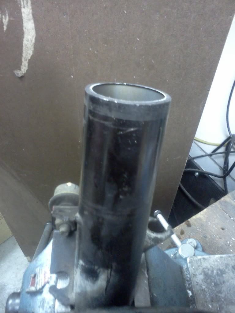

    Shortening the housings 2 inches.......hand slipped.
    whoops
    Photobucket
    Little Adapter sleeves for the struts Dave does awesome work!
    Photobucket
    OLD vs. NEW
    Uploaded with ImageShack.us
    shortened housings
    all done! Oh! and I have bumpstops now off some coilover set up! Thanks Sean!

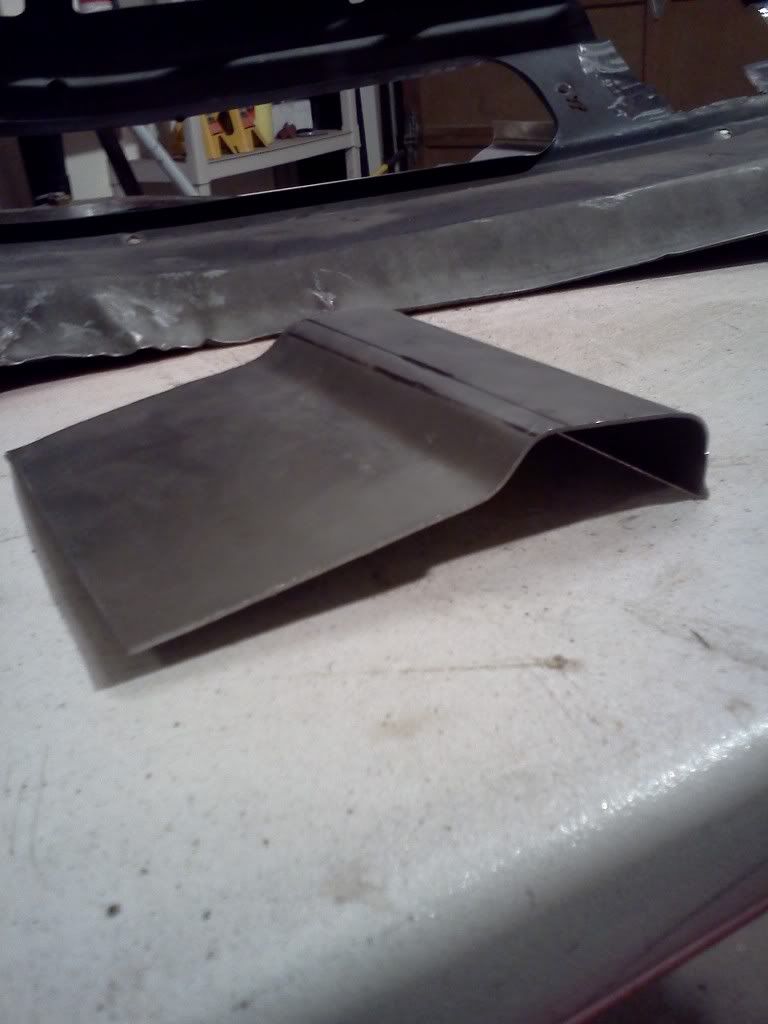

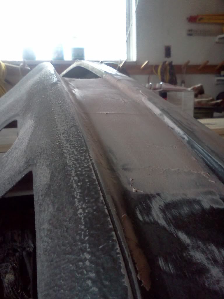

    And shaved the bumper by using this plate
    Photobucket
    Photobucket

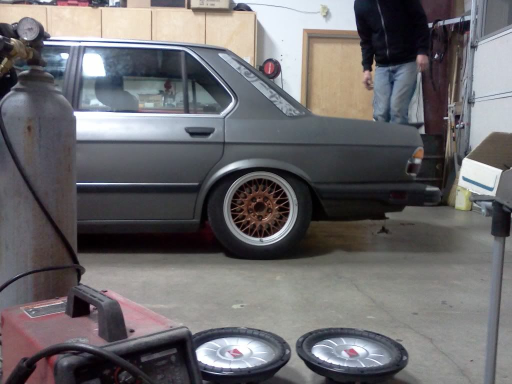

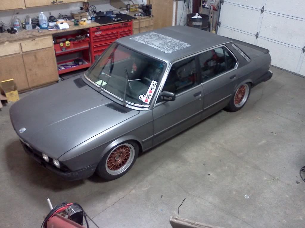

    still not finished with the body work, but I threw some paint on it so I could drive the car on the rabbit set up. MEEEEhhhrrrrR I will finish it later.... maybe.
    I used a generic coilover sleeve style set up without the adjusters just the spring. I am going to cut the spring for more lows this weekend, but it sure is nice to not slam on everything, and the car turns in so much better with this set up. I'm a happy camper.

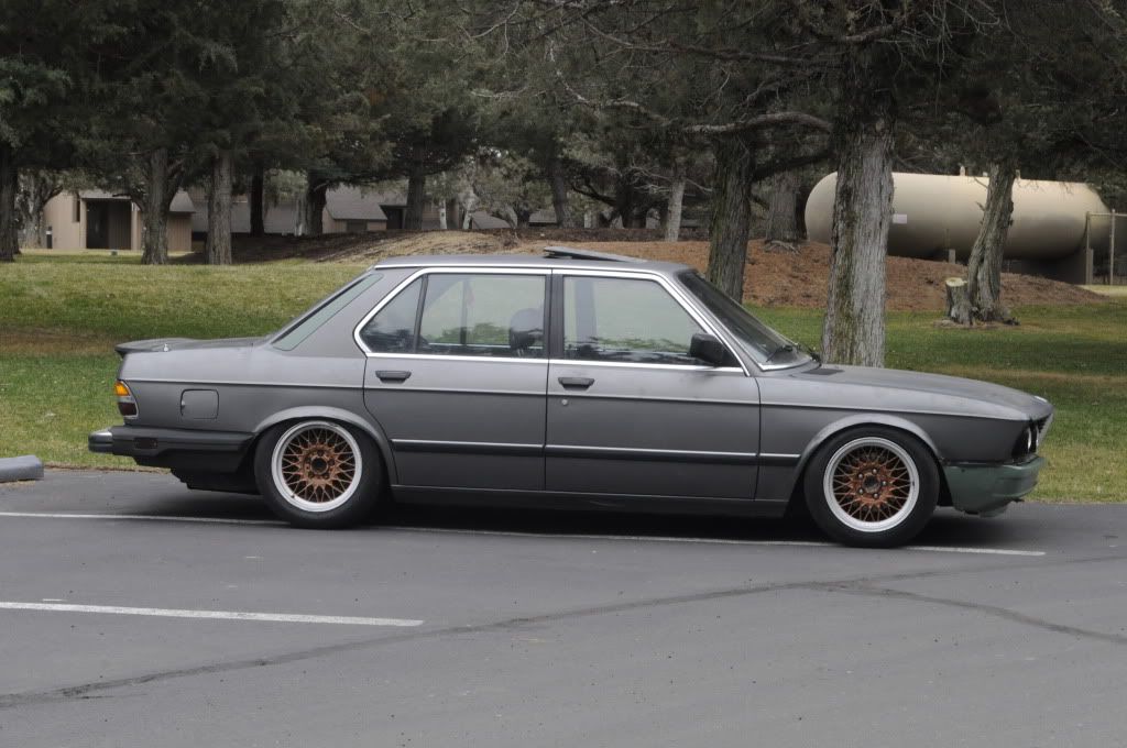

  • E28stoff
    replied
    great looking e28 man
