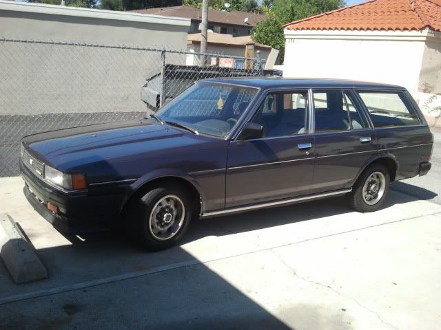

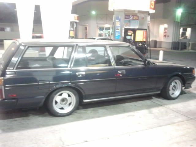

    This is my slow build of my 1985 Cressida wagon (MX72)
    After I got it and swapped out the ugliest set of steelies I could find to give the owner his wheels that came with the car:

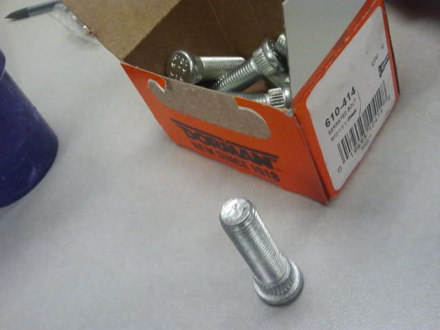

    Bought some new studs 7mm longer:

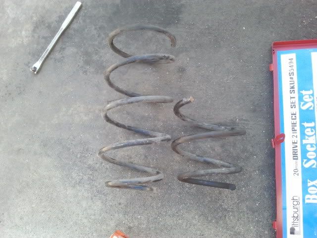

    Back to approximate stock height with a slight drop (cut 1.5 coils up front and 2 in the rear:
    After I cut 1.5 coils (left) what the previous owner was riding on lol (right). It looked good, but damn was the ride horrible.

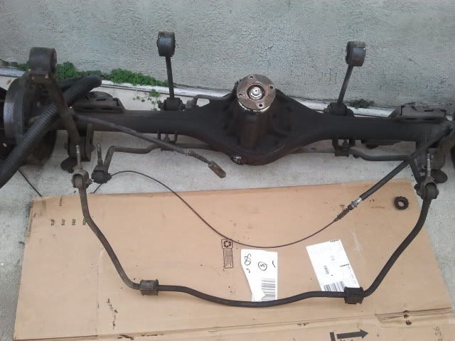

    Took off my rear end for a mk1 supra rear (3.73 ratio, disc, & lsd), much better option for the w58 in it.
    Old rear:

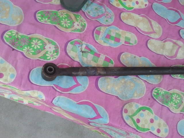

    Cut and had a solid rod welded into a portion of the panhard bar to meet the .5" extension required. (Bar was cut, then a 2" slice was done on each side of the cut, rod was welded on those lines, then fluxed on that actual space... looks like shit, sturdy as can be).
    What I cut in the rear:

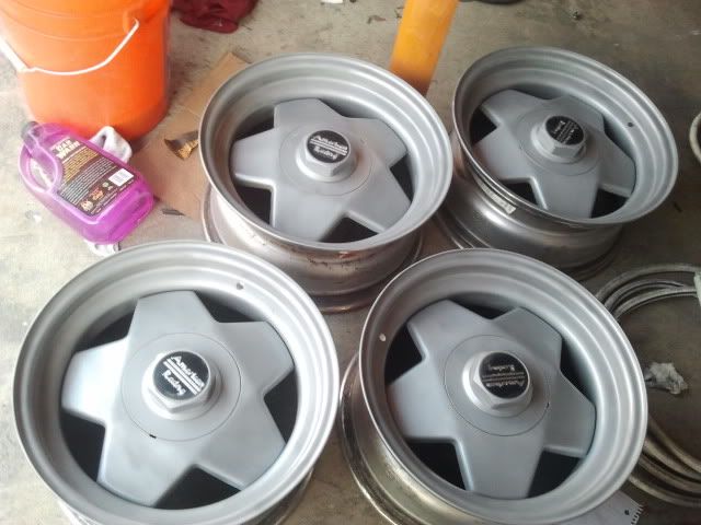

    Painted some cheap wheels (these are actually steel lol)

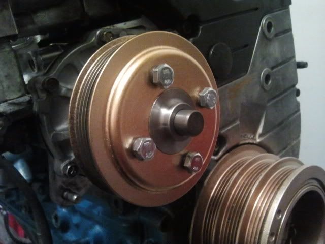

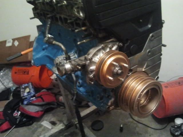

    No big updates, just painted the block, the pulleys, and installed the new water pump.

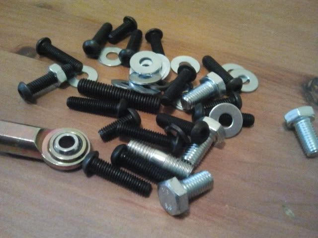

    Went fastner shopping yesterday; God it is so satisfying lol.

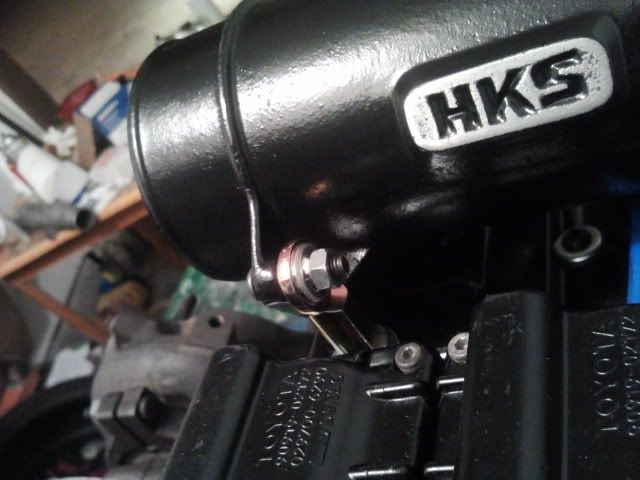

    Spherical rod end mounted to the coil pack stud/grommet to have the HKS pipe as a TB/intake piece (and cut off the other mounting location so it can sit flush).
    Studs replaced with bolts/locking washers on the water pump since I will be running MSII (electric fan).

                LOL I got the headgasket in the rebuild kit, but I am leaving that and the timing alone at this moment. I want to get the motor up and running, if it needs front/head seals I can replace after its in the car. Wheels are 15x7 et0, I can easily fit a 15x9 et0 in the rear comfortably, no camber though since I am live rear axle.

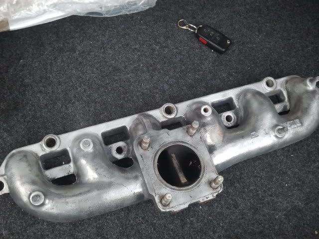

                  Not much of an update, I got a little more done with the engine, and I ended up having to helicoil 5 out of the 7 exhaust manifold studs:
                  LOL the aluminum is so soft!
                  After:

                              Originally posted by a3 german View Post
                              its safe to cut (so much) the coil?

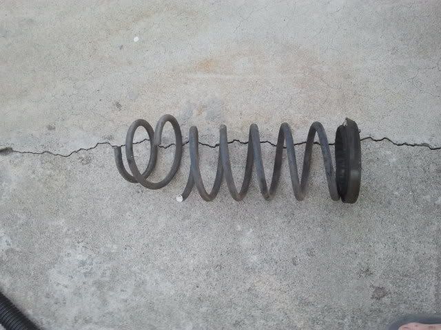

                              How much I cut is perfectly fine since even in the air the spring is never free, the way the previous owner cut I am pretty sure was not nearly as safe. Also cutting in the rear of mine helped since the mk1 supra springs I used were approximately 2" longer, but rates were different since it weighed less than my wagon.
