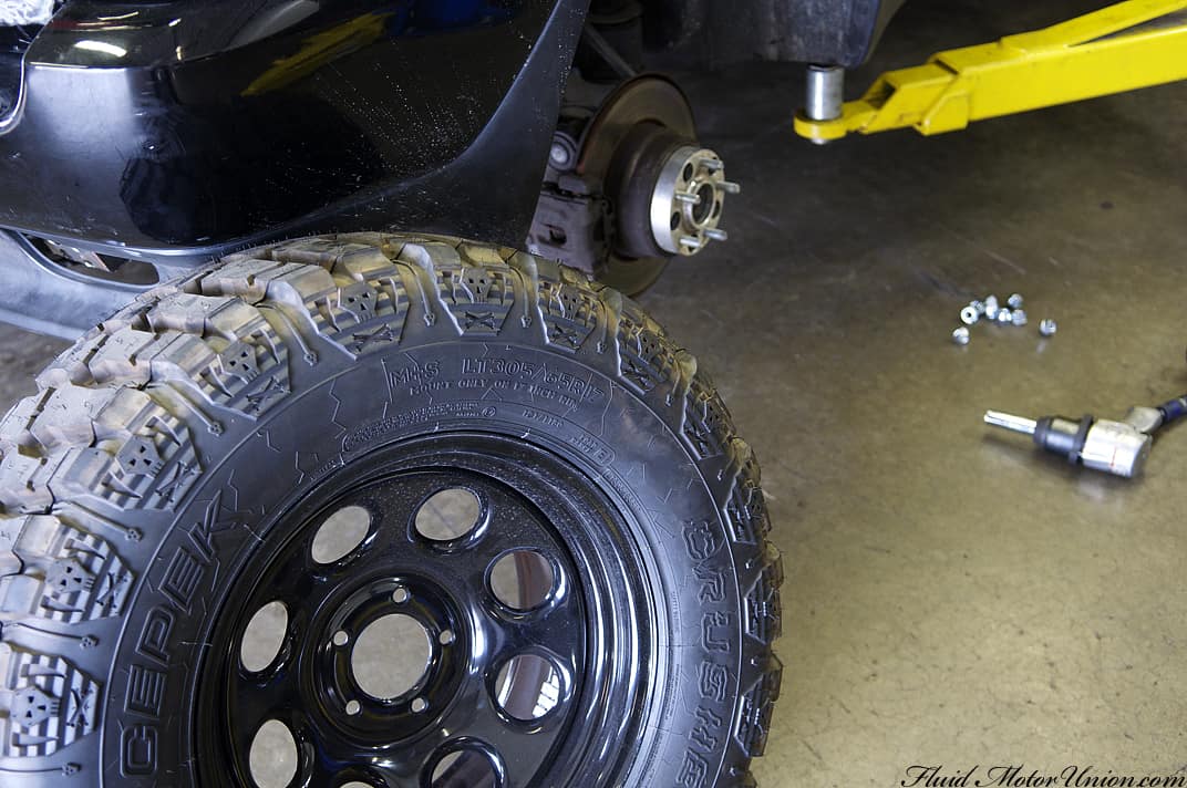

The wheels and tires were the first addition that took almost no time to settle on. In searching for the most aggressive SUV setup we could, we settled on Cragar’s steel wheels for that heavy-duty steelie look, and a set of Dick Cepek tires. These aren’t your normal tires – they are covered in skulls and bones, which doesn’t give off a very happy-go-lucky, take-your-kids-to-soccer aesthetic that’s typical of a normal X5.

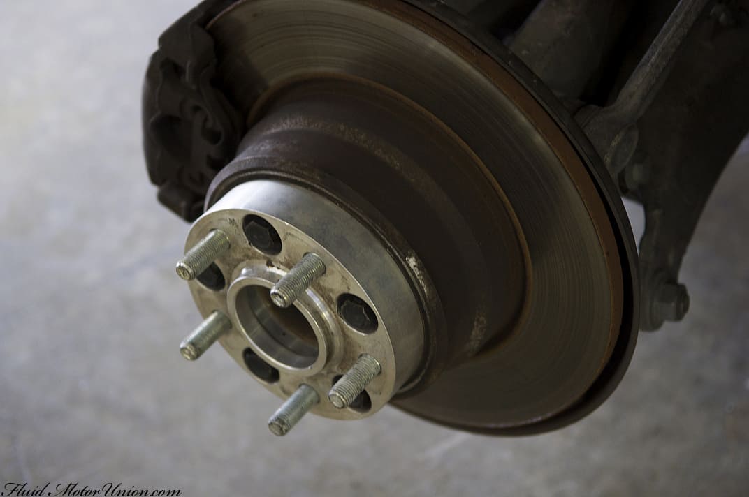

From there, we needed to set the X5 up such that the tire clearance wasn’t a problem. Instead of trying to find a kit on the internet, we made our own custom lift kit for the X5’s OE suspension setup. Featuring a billet aluminum set of spacers, it lifted up the X5 between 1 and 2 inches, providing the clearance we needed.
