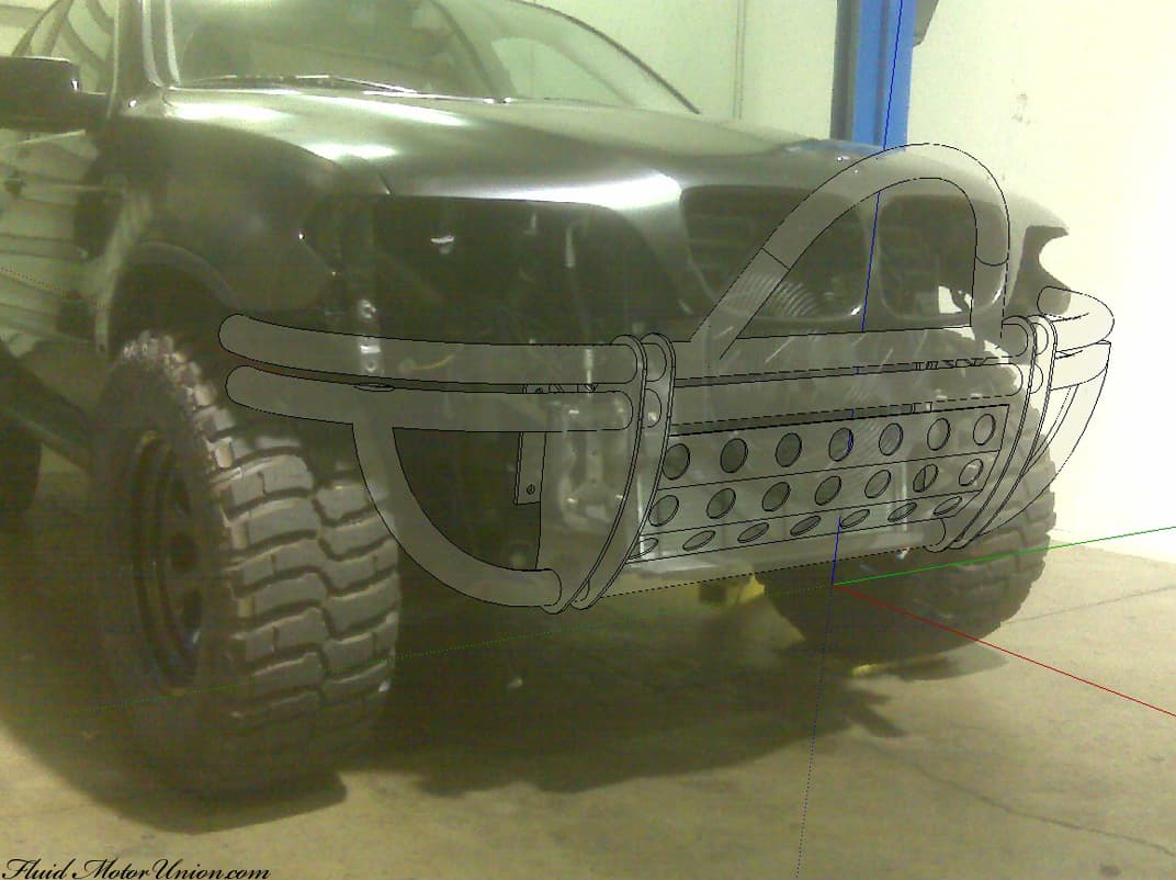

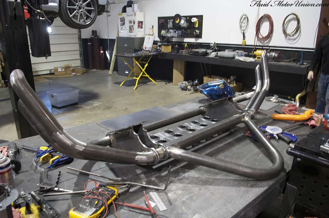

Now we’ve gone straight from the easiest part of the fabrication to the hardest. The front bumper was something we were looking forward to making for a while. We had designed the entire front end on our computers, and the mock-up looked good, so we went about the fun task of constructing this system with nothing but the tools available to us and all the mild steel in the shop.

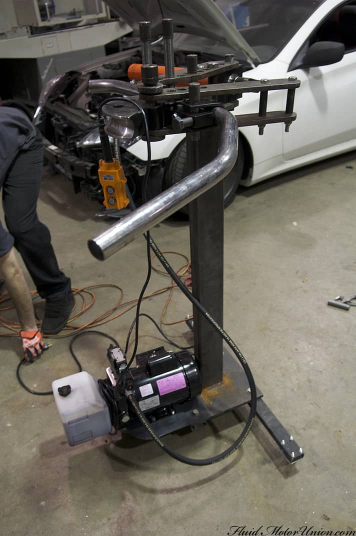

Using a small bender, we had to triple-check every angle to ensure we were bending correctly. Thankfully, we got everything right on the first try.

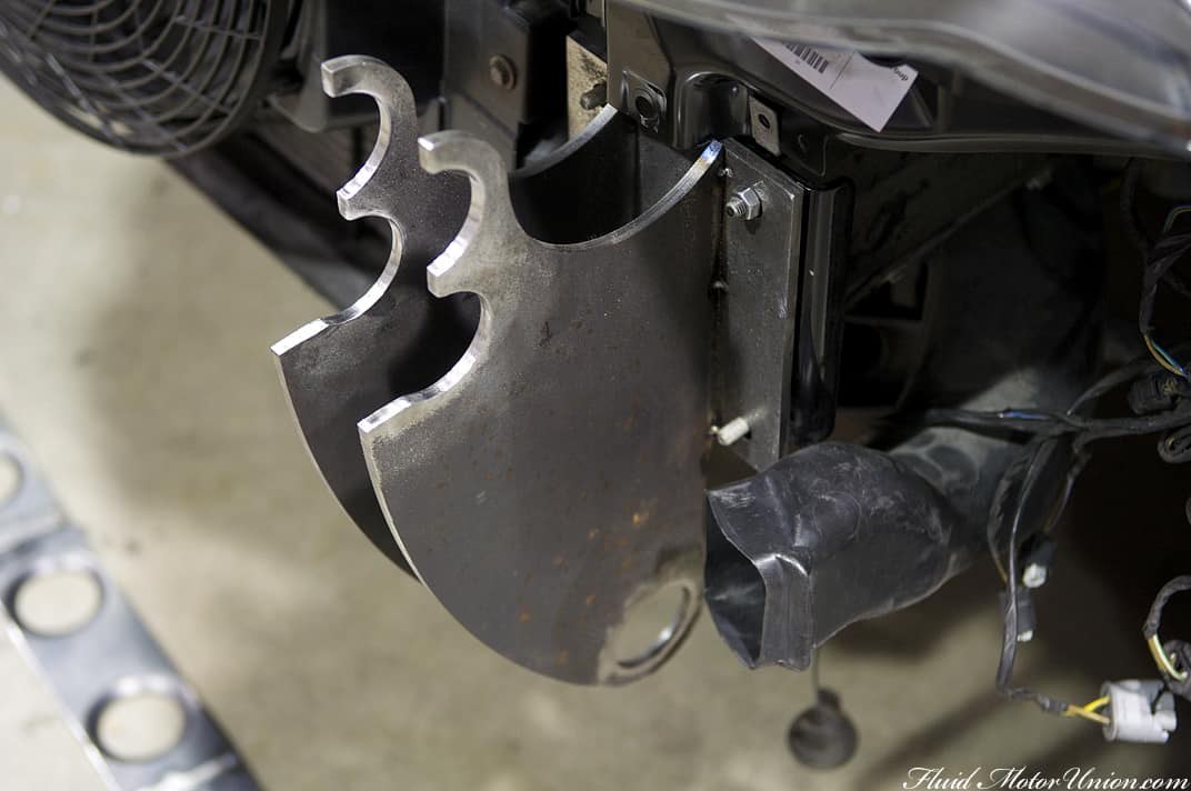

We also had to make the mounts from scratch, carefully checking the angles to make sure they’d fit snugly around the main bumper bars.

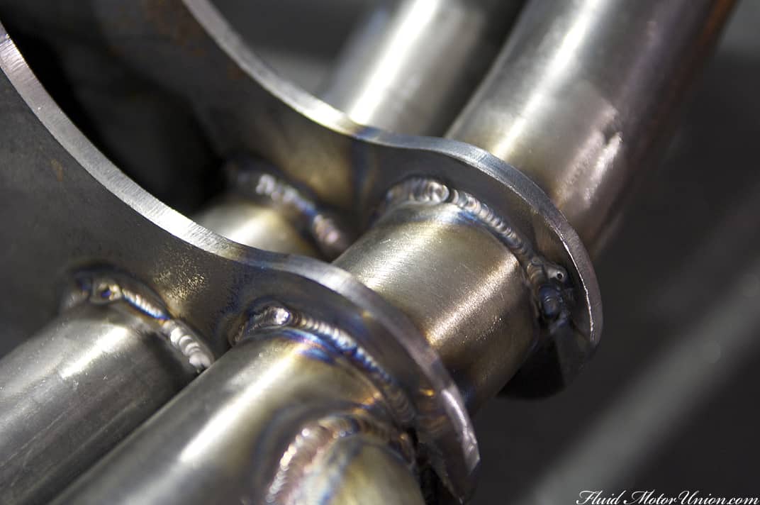

With the front mounts created, we added the main bars to the front mounts to see how everything was fitting together at that time. Again, our triple-checking paid off, and fitment was spot on.

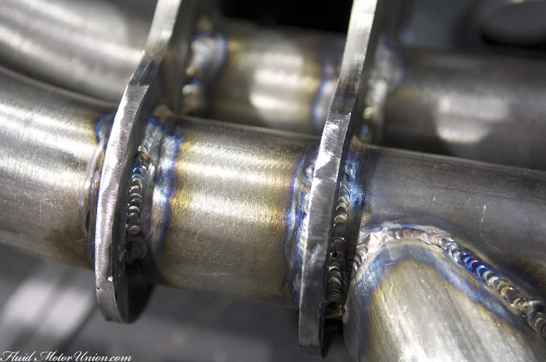

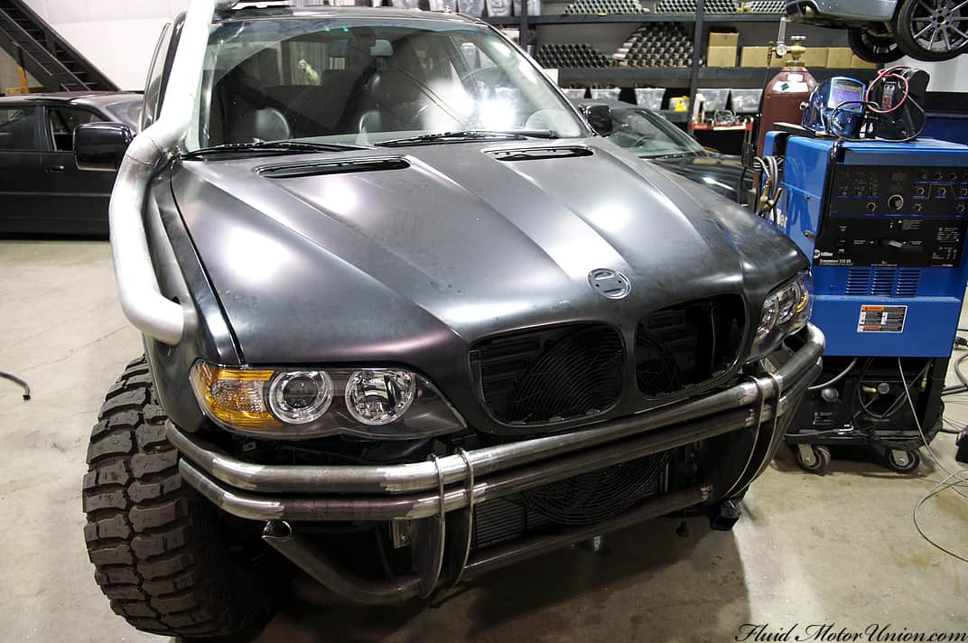

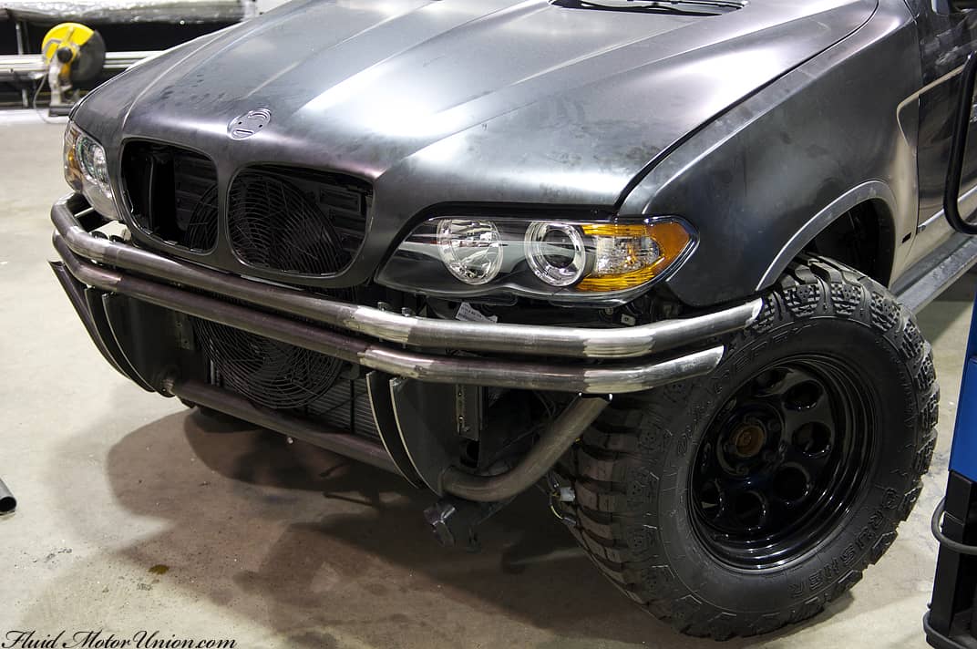

After a quick test-fit, it was time to begin assembly. Tack welds began forming, followed by full-on TIG welds. At that time, we also finished our radiator cover, which consisted of several rows of dimple-cut steel. That way, it didn’t block airflow to anything vital, and it maintained that aggressive look we were searching for.

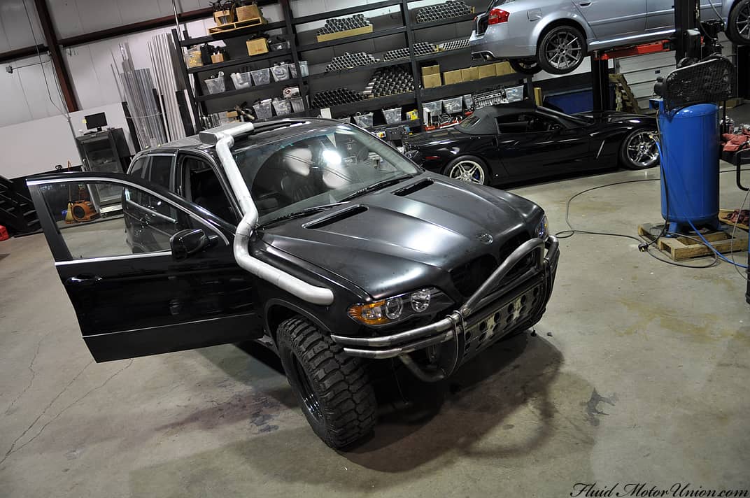

Once the welds were completed, we threw ‘er back on the X5 to see how it looked. In a word? Stunning.
