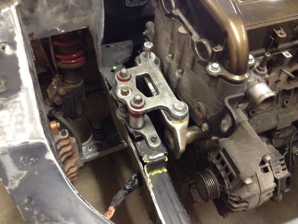

    So, a little background, factory upper engine mount is ugly, huge and generally would bug the ever-living-fuck out of me had I left it alone. So, said fuck it, and cut the entire thing out. Started from scratch. I want the wheel tubs and the engine alone to be the center of attention in the bay, so I set off to design an engine mount that was mostly unseen. So far so good.
    Pictures of said factory engine mount:
    Gonezo:

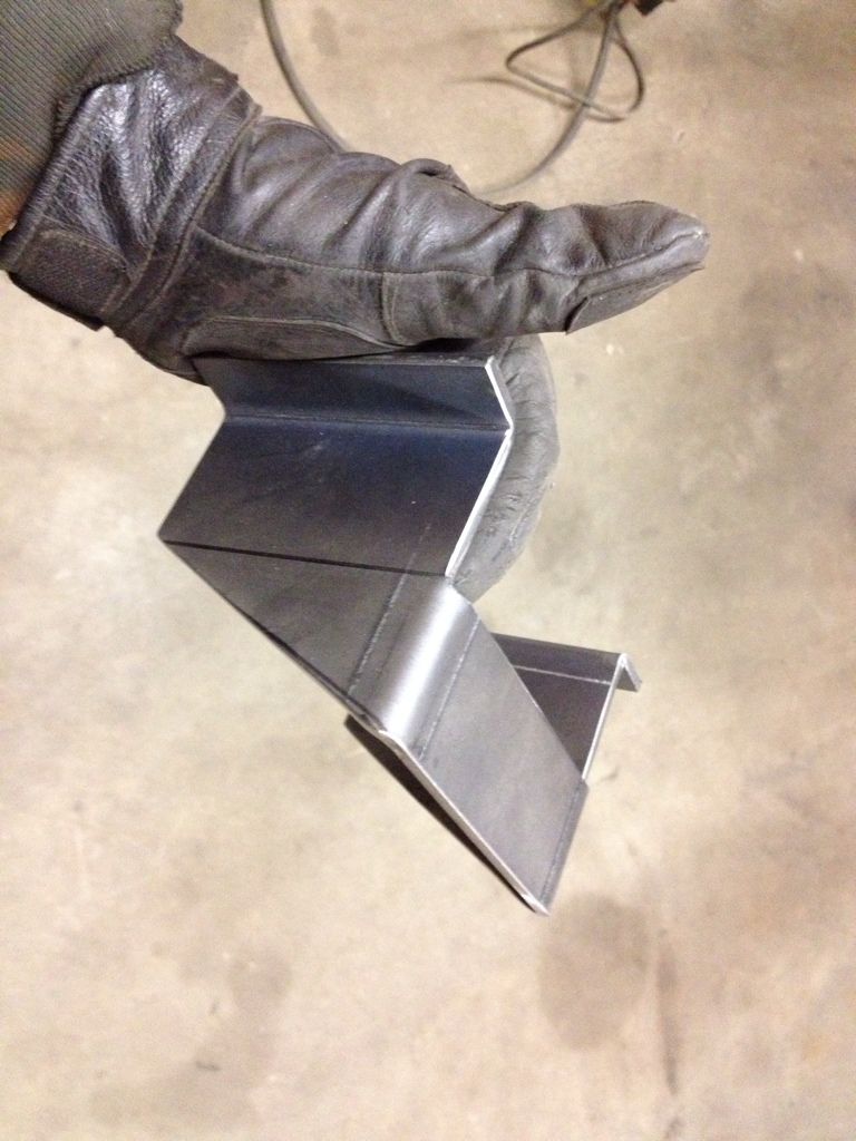

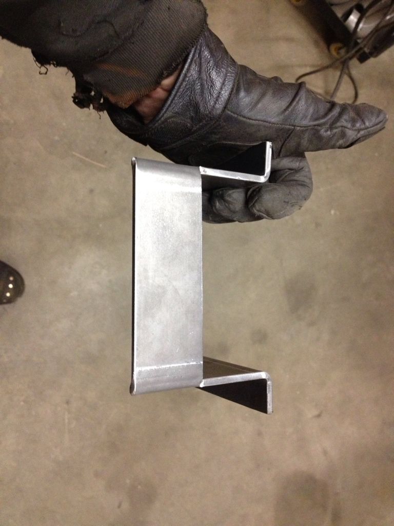

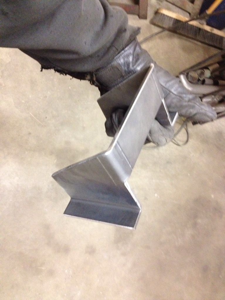

    The beginning of "the new hotness":

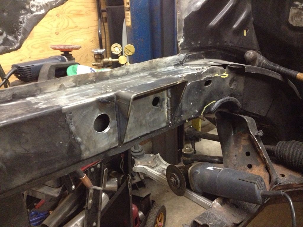

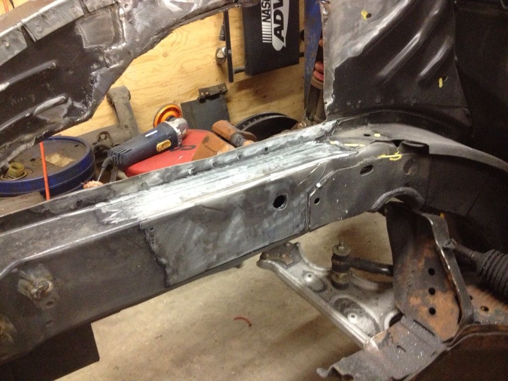

    This has been sectioned into the frame, and is welded into both vertical sides of the framerail, as well as welded horizontally to the top of the frame rail on three sides. It ain't going NOWHERE.
    And this, is now all you can see:

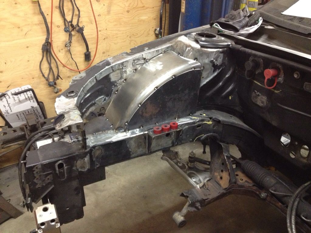

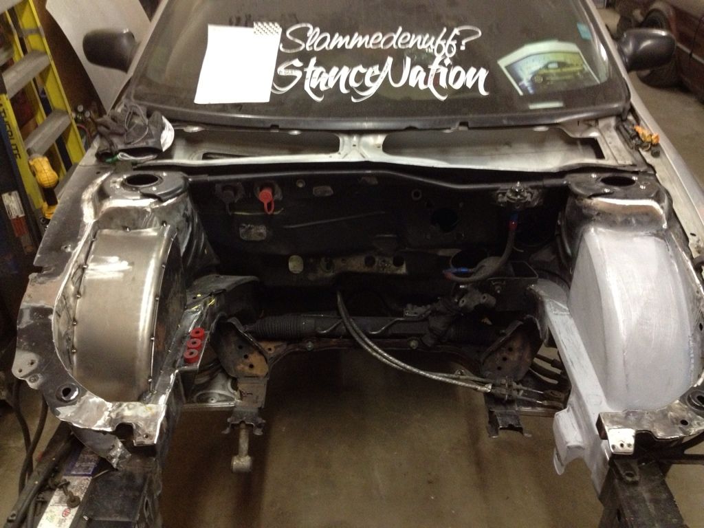

    So, why stop there for tonight? Decided I'd finally built that gat-dang wheel tub for the right side, aswell:
    FINALLY, my engine bay is starting to look like something again. I need to toss the engine back in now and finish the engine side of the new mount. I've had the engine in and out a total of 17 times since the engine-raising began. This is getting out of hand.
