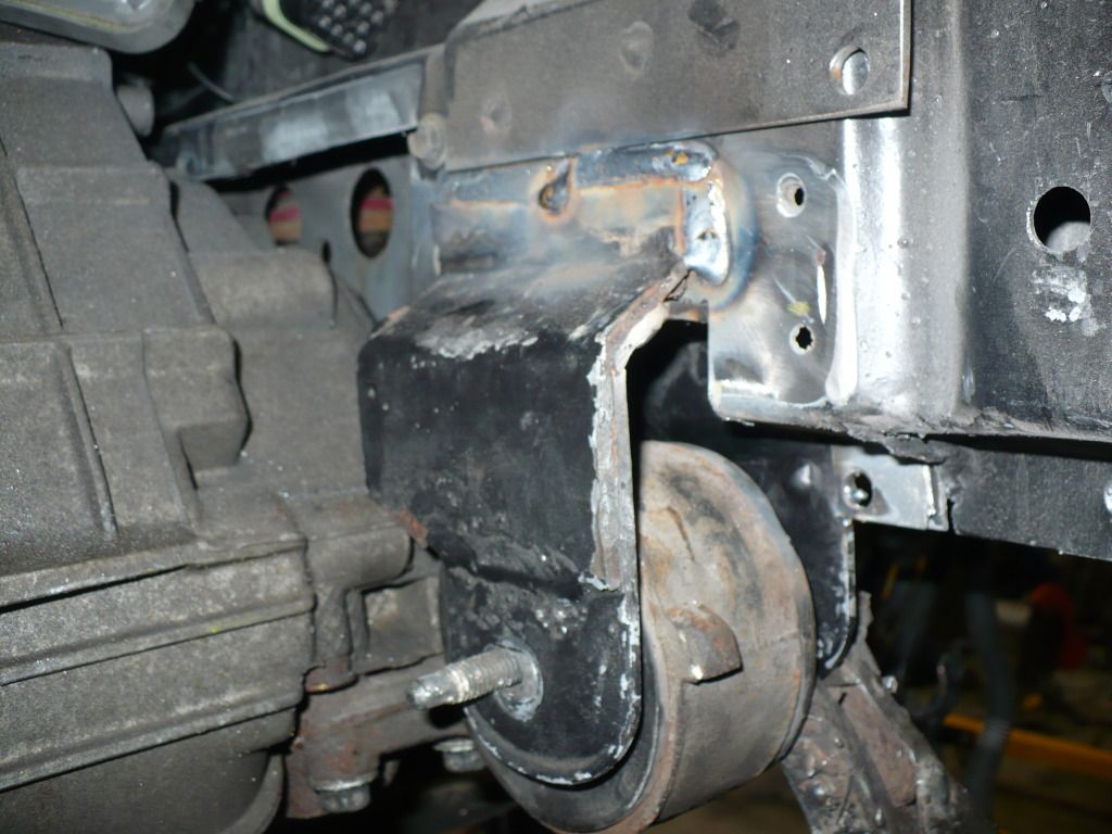

          Had another real good day at the shop today - got the front trans mount done and finally the car held the engine in on it's own again. Got the subframe in just to see where everything sits, and the diff and oil pan are 3 full inches higher than before. I couldn't be happier.
          First the engine sitting mounted
          Vs. the stock front cross piece
          Trans mount, notched into the frame.
          Still need to get the engine mount bracket made up, and finish the notch on the drivers frame rail. I think I can finally see the light at the end of the tunnel.

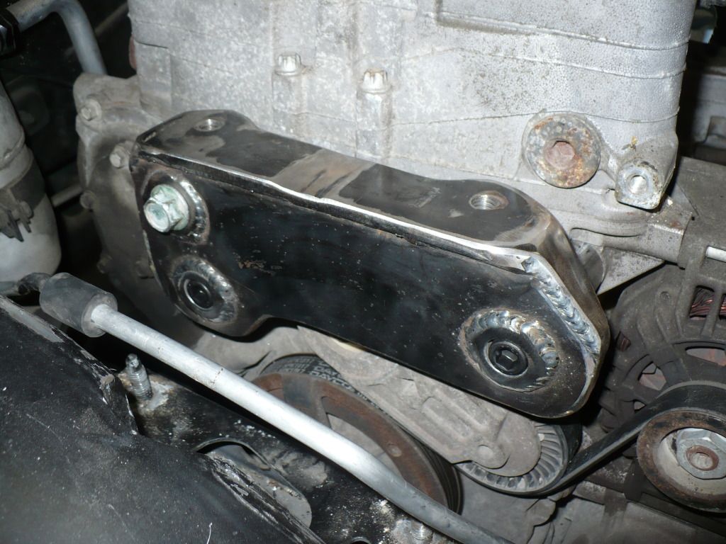

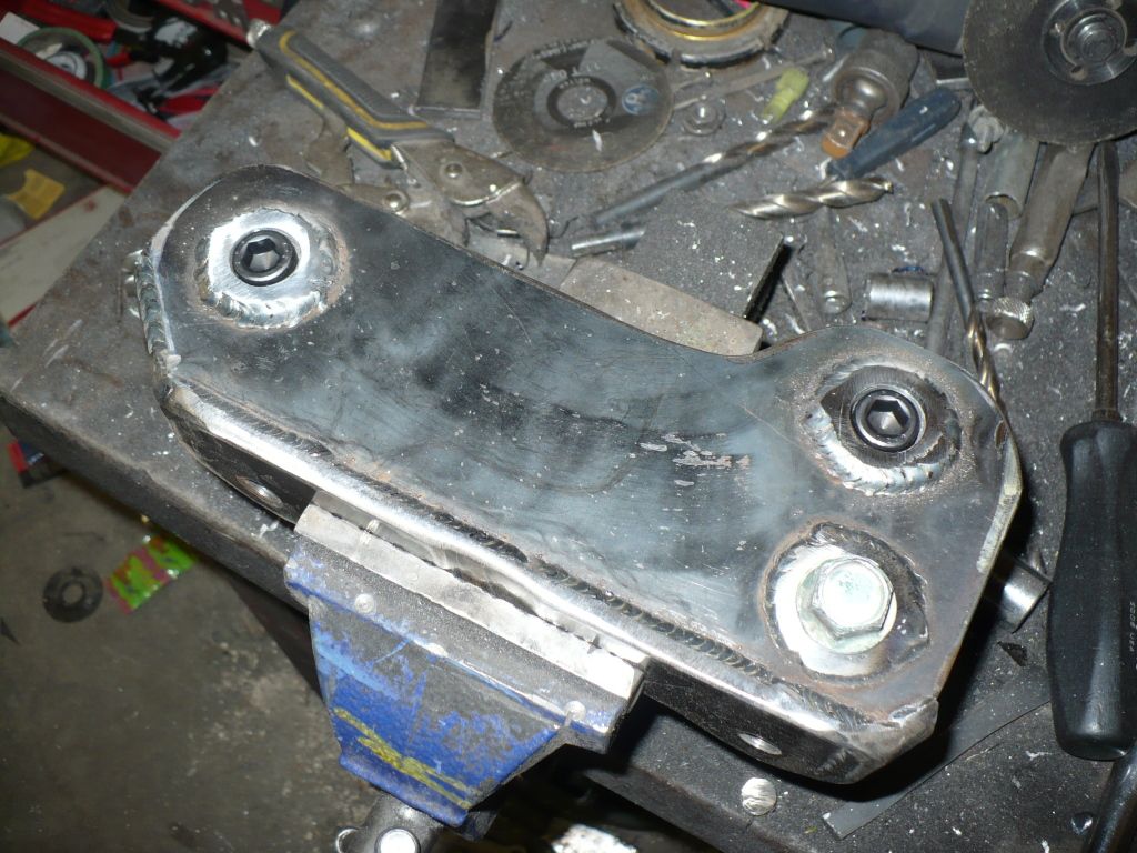

                  • Well, finally got the engine mount bracket figured out, and made. I would pay good money to see Michigan try to destroy this thing again. I still need to have the bottom two holes straight bored, and will have to run flush mounted grade 8 hex bolts in them, just due to them being super close to the frame rail.
                    Forgot my camera at home last night, so I just brought the mount home... pics on the car soon, promise.
                    I wouldn't mind having some pattern milled into the center section, but I'm not real worried about it right now.

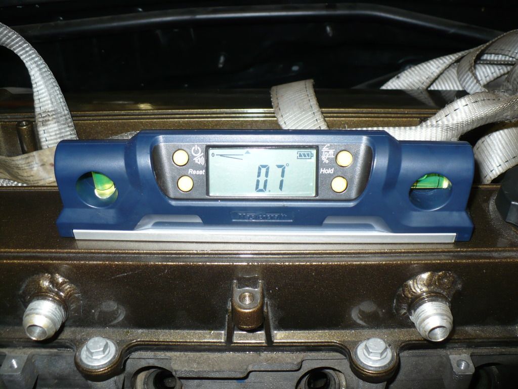

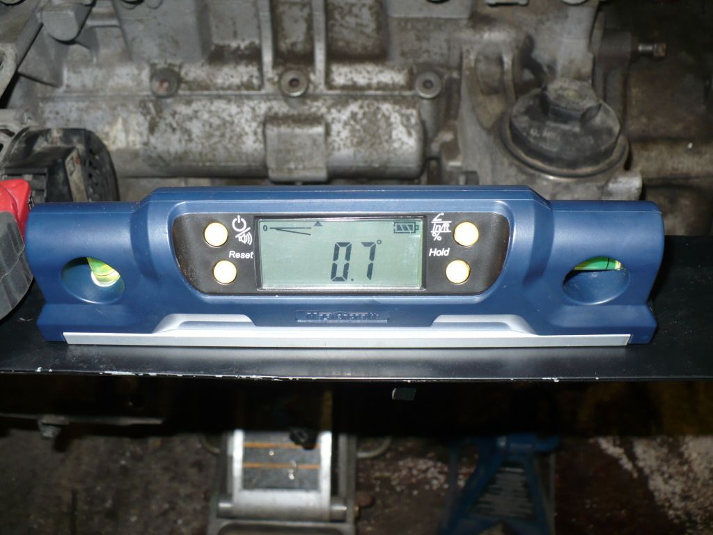

                    This means the engine is finally 100% level and supported to the car.
                    Time to start making other shit fit. Le SIGH.

                            Originally posted by Kielan

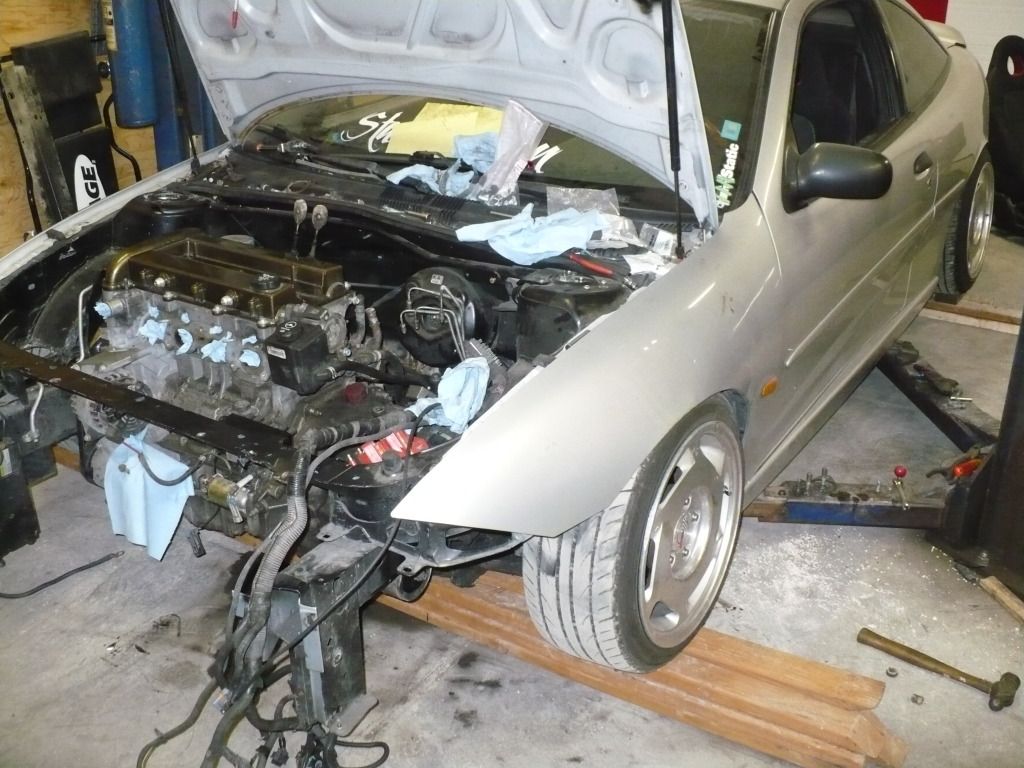

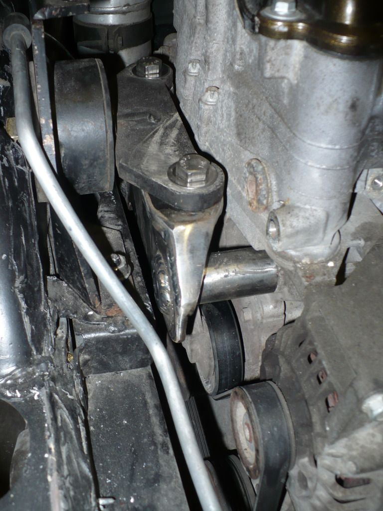

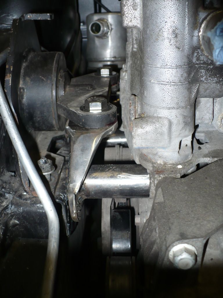

                            • Well.
                              Got the mount bored out for the allen head bolts to sit in. Ordered the bolts, the ones that showed up were not the ones I ordered, they're too short. Great. They'll work for now but will need to be changed before the car is driveable.
                              The mount is a total success, I may clean it up a little, and will definitely be painting it, but for now I couldn't be happier.
                              Onto the bad news.
                              With the engine now fully seated where it will be permanently, I decided I'd put the suspension back toghether and check clearances of axles and things.
                              Clearance, there is none.
                              The axles are resting against the frame rail on either side, and the left side axle is playing kissy-kissy with the brake lines.
                              Fucking awesome.
                              Yep... probably not gonna touch the car for a few days, seeing as I currently loathe it.
                              Cavaliers were not meant to be low.
                              On to the pictures
                              And how the car will sit for the next while.
                              Bah humbug.
