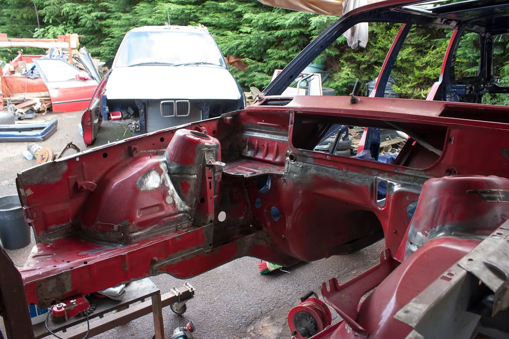

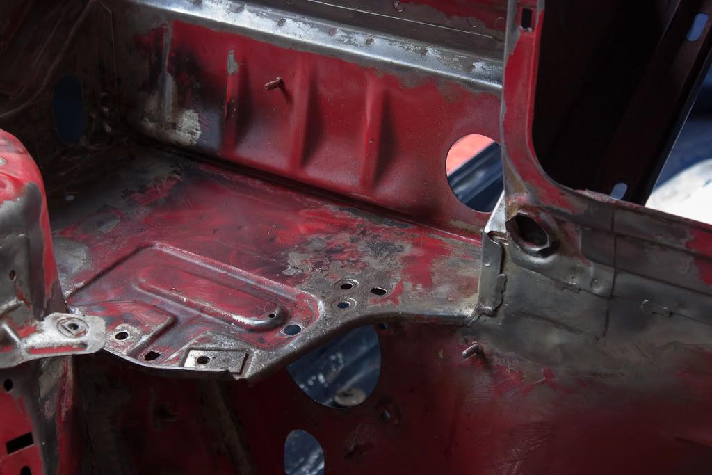

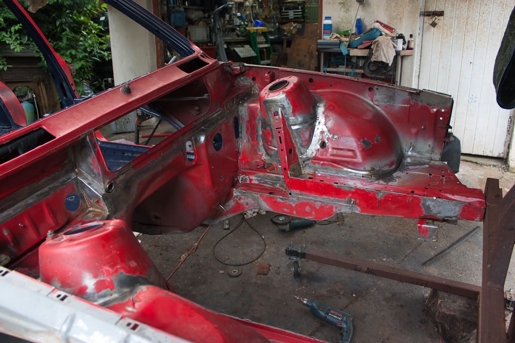

    I've a few stuborn rust spot that needs a bit more gel, going to treat all bare metal again also (until I'm ready to primer it). Need to make up a bracket for the airbox and abs bump. Some how need to get those welds around the strut ground down, angle grinder cant get at them and the dremmel grinding stones I have are rubbish :
    The underside needs a little bit of attention here and there but mostly it needs a good clean, rub down for a 2nd coat of primer and I can then underseal and stonechip it all :

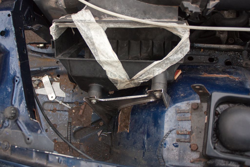

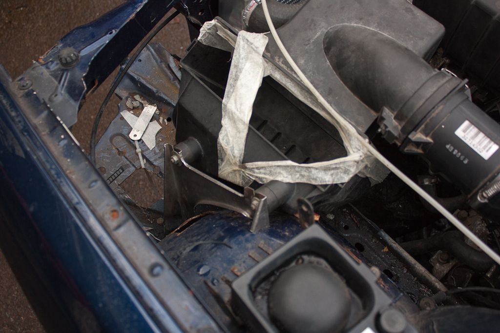

      Spent a bit of time last night making up a card template for the airbox bracket, happy with it I transfered it to steel this afternoon. Many hrs later and a timber mould to help with the edges and one airbox bracket. I just have to figure out a way to transfer it to the red shell so it's in the exact same position :
