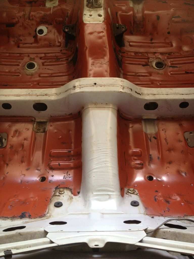

      • Well this weekend I decided to take on the task of removing all of the Sound deadening. Ended up being very easy. I purchased 30 lbs of of dry ice. Ended up not even breaking it up. Just laid the blocks on the area for a few minutes then hammered away. Came right up. Feels good having a rust free 37 year old floor board.
        • damn that's Clean, just need to paint it body color

            After all of my fab work gets done I will be putting in new sound deadner. The solid suspension makes road noise loud inside the car!
