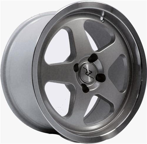

Ordered up s new set of temporary wheels, god bless cheap Mustang parts. Set of 17x9 speedline reps, $398 shipped!
Set of tires acquired also 215/45's front and 225/45's rears.

Btw, those wheels will look great on the brick!Last edited by volvo242; 10-02-2011, 05:04 PM.- volvo 242 low and wide Project

Love the latest wheels on there. Excited to see where this goes.
