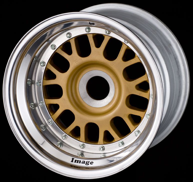

            I have decided on these Image wheels, I figure just a few bad reps on the internet I can handle. I mean they make wheels for race cars!
            Couple of months time I'm going to order just 2 wheels as that's all I will be able to afford for now
            16x8J 0ET (195/45/16) upfront I think is what I'm after with just a whiff of negative camenbert, then maybe a 9J for the rear with a hint more and maybe a 205/45/16 not sure yet.
            These are what Im shooting for:
