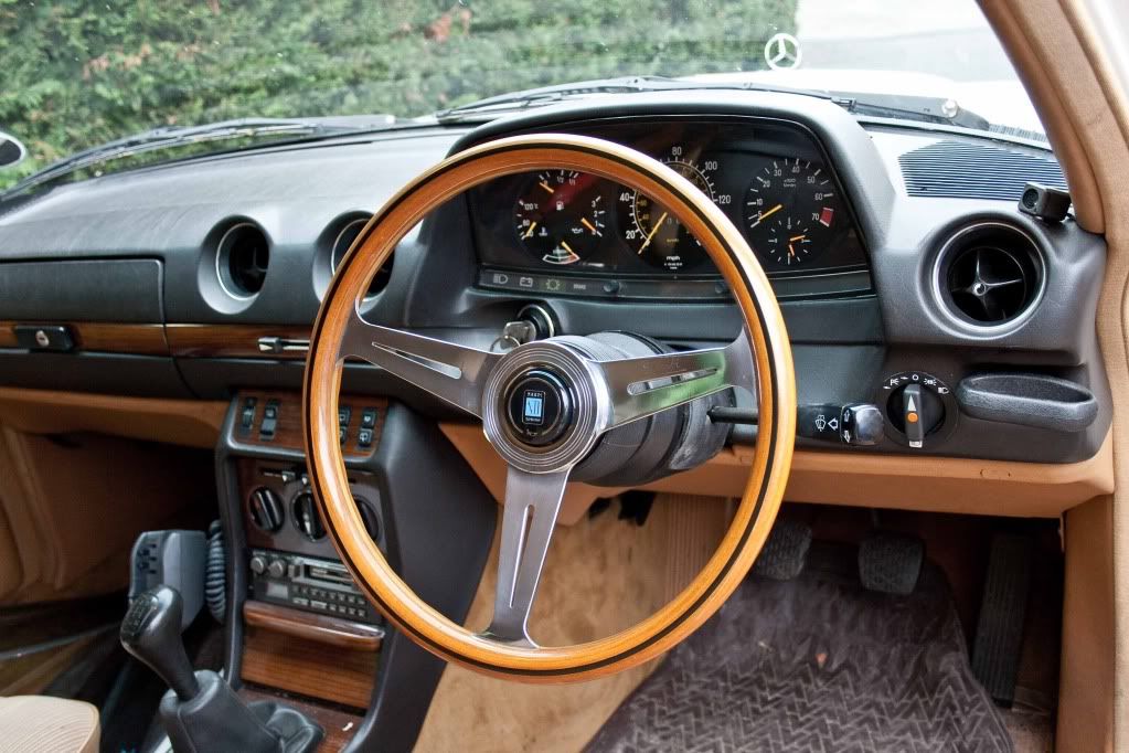

Yea the interior is in very good shape, will look so much better once the Nardi wheel is on.Originally posted by DoWant View PostThose were built to last a lifetime. the interior looks almost new. Great cars. Good build.

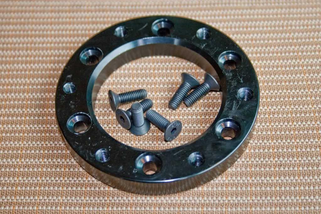

Next up my steering wheel adaptor came.
The Boss I'd bought had only MOMO wheel PCD and Nardi wheels have a slightly larger PCD so this adapter came from the states. Pretty pricey but does the job.
And the Nardi Torino wheel fitted. Sooo much nicer than the massive standard wheel!

BTW I love the Nardi Torino wheel!
