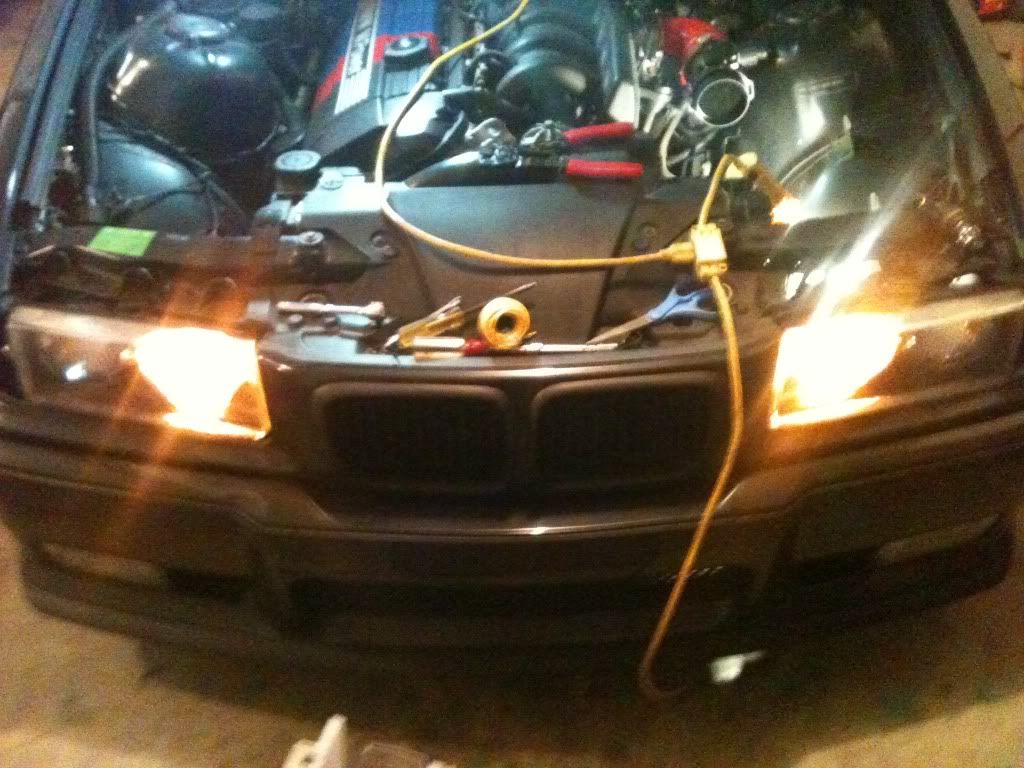

    I got this obsession with city lights, where the inside lights glow this sexy amber. I was inspired by this video. There's an M3 in this drift series which appears to be running with no nose panel/grills and an e46 m3 front bumper. It has city lights and the car looks absolutely evil. So naturally I had to do it.
    King of Europe Drift Series Round 4. 6-9 July 2011 Mariapocs, Hungary. www.kingofeurope.net Katana team: Evgeny Todorov Pavel Penchev Trifon Kamburov Radoslav…

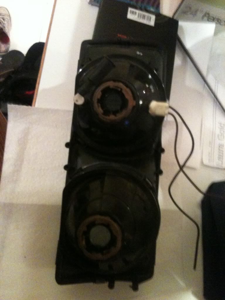

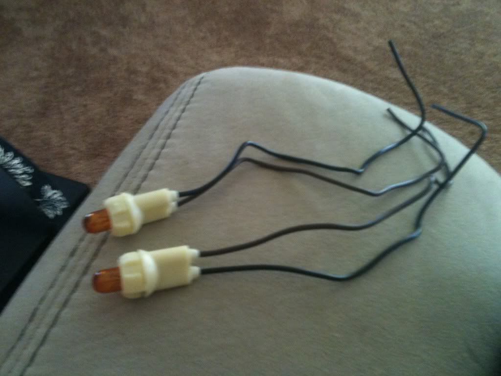

    I went to advance auto and picked up 2 194 turn signal lamp bulbs
    Drilled holes in the high beam housings and threw them in with some super glue
    Then cut the corner light wires and ran them to the city lights

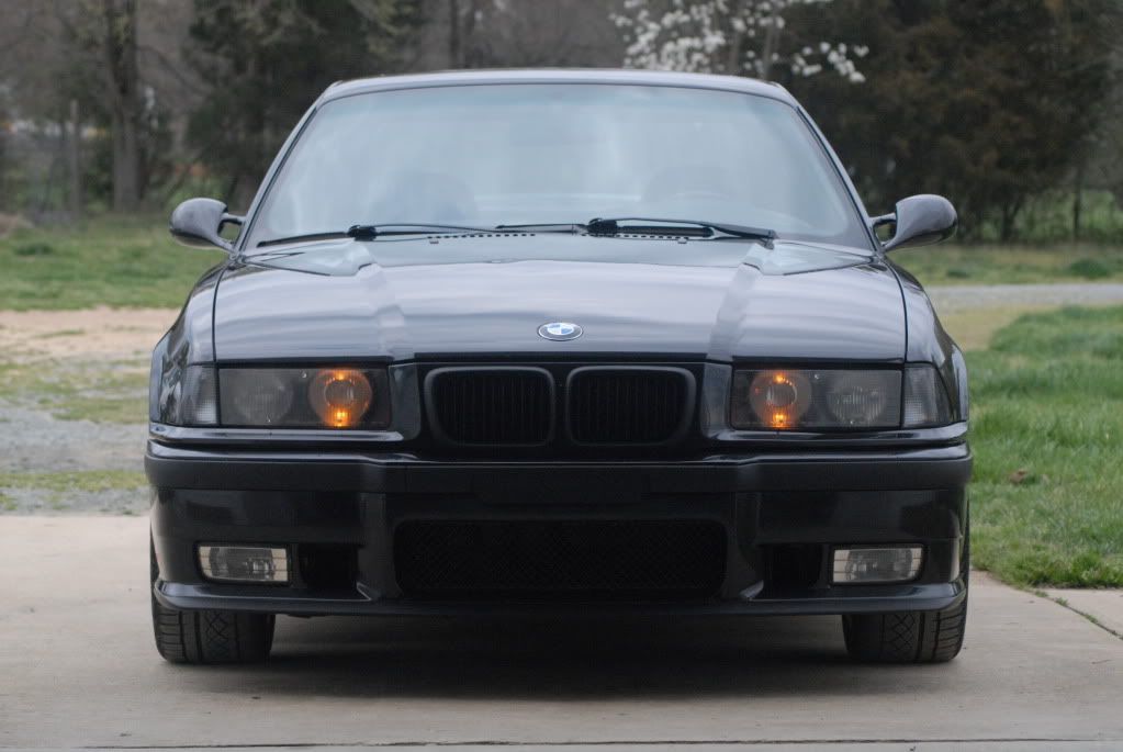

    Now the car looks like this
    I also ordered some smoked corners and side markers from ddm, I'll get the tail lights later, I'm broke again. At least until I get my $300 gift card for signing my new lease for school next year! After that i'll have the M50 mani done and the taillights on.

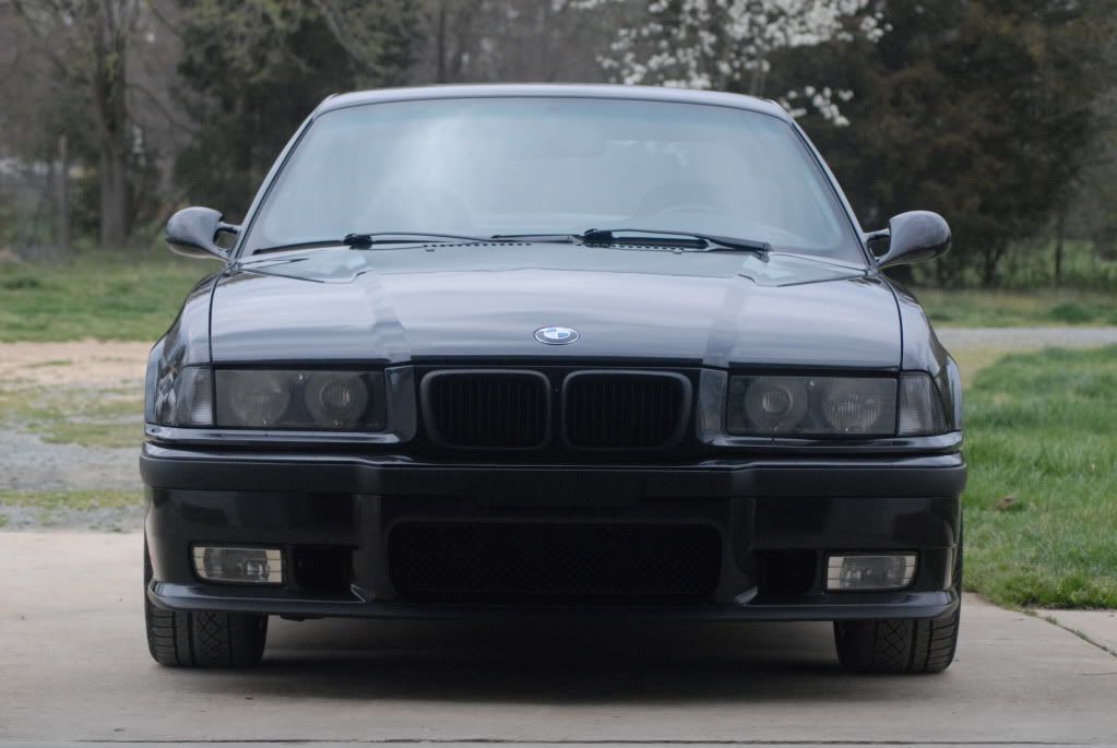

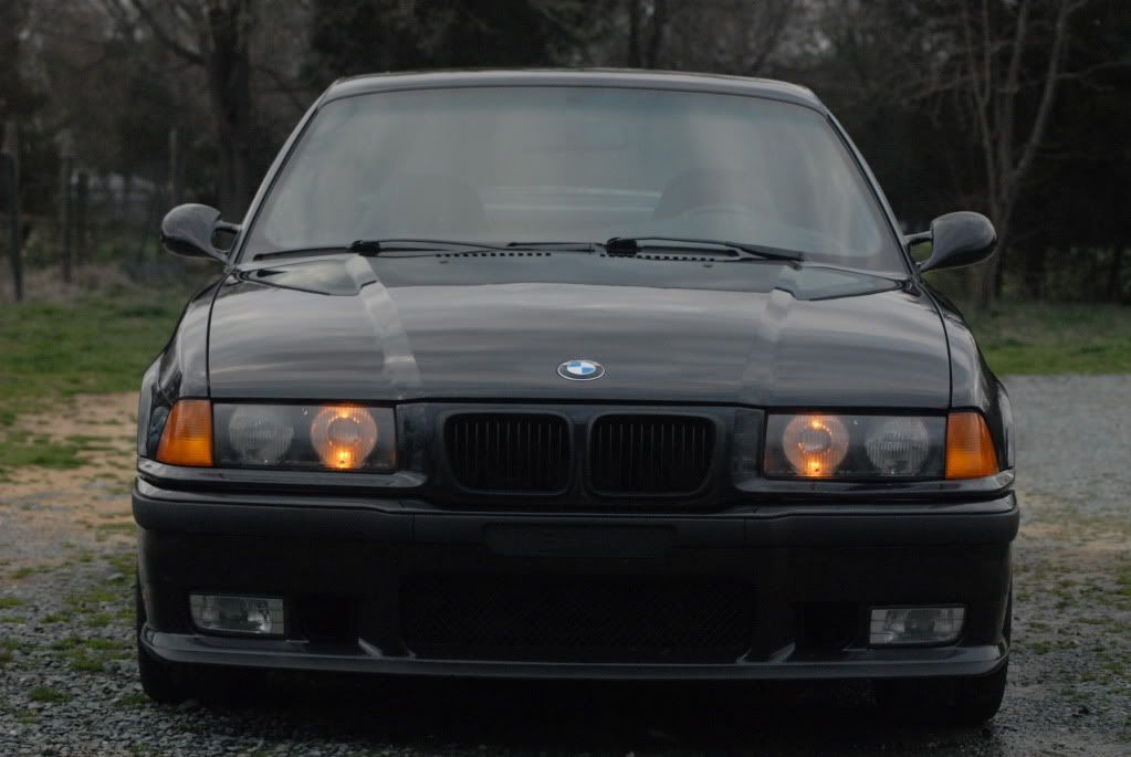

            Here's another pic with mah city lights

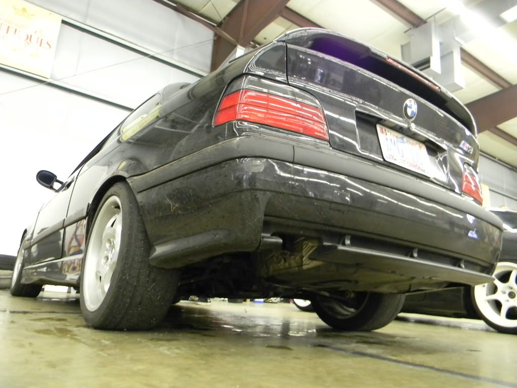

            Then I ordered clears from DDM. Obviously they're not the best quality but they fit and I re-aligned the headlights so they're all flush.
            Then with city lights
            If you're wondering why I don't have a full car photo it's because the UPS truck carrying my clear tail lights broke down so I didn't get my lights on Friday and I had to go back to UNCC so I won't have those for a few weeks.

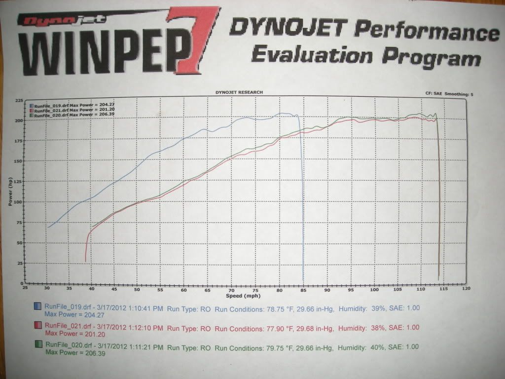

            I also went to the 31st annual Korman auto works meet, they had a mobile dyno there so I hopped on.
            Got 206 at the wheels the dyno said 79 outside but my temp thing in the car said 86 so i'm pretty happy with the numbers. Especially for a 14 year old car with 165k miles.
            Here's the vid. I got the biggest crowd. Probably because my car is so loud.

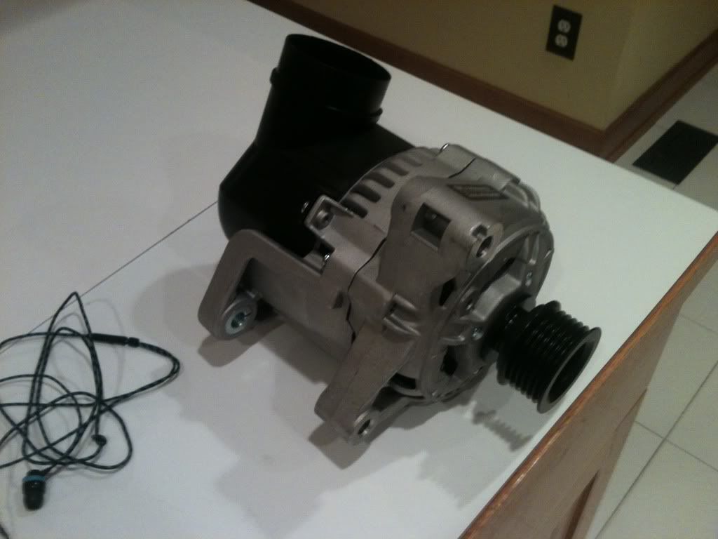

              Shortly after that my alternator kicked the bucket in Charlotte so I had to rush home to Chapel Hill and get a new one. That was sketchy.
              I took everything off the old one and boy did I get lucky. I got the alternator from Autozone and it was a POS Chinese rebuild. It makes these stupid noises and the backing plate had a bad ground and was making all my speakers whine. So I swapped all the old hardware and pulley over and it fixed the whining.

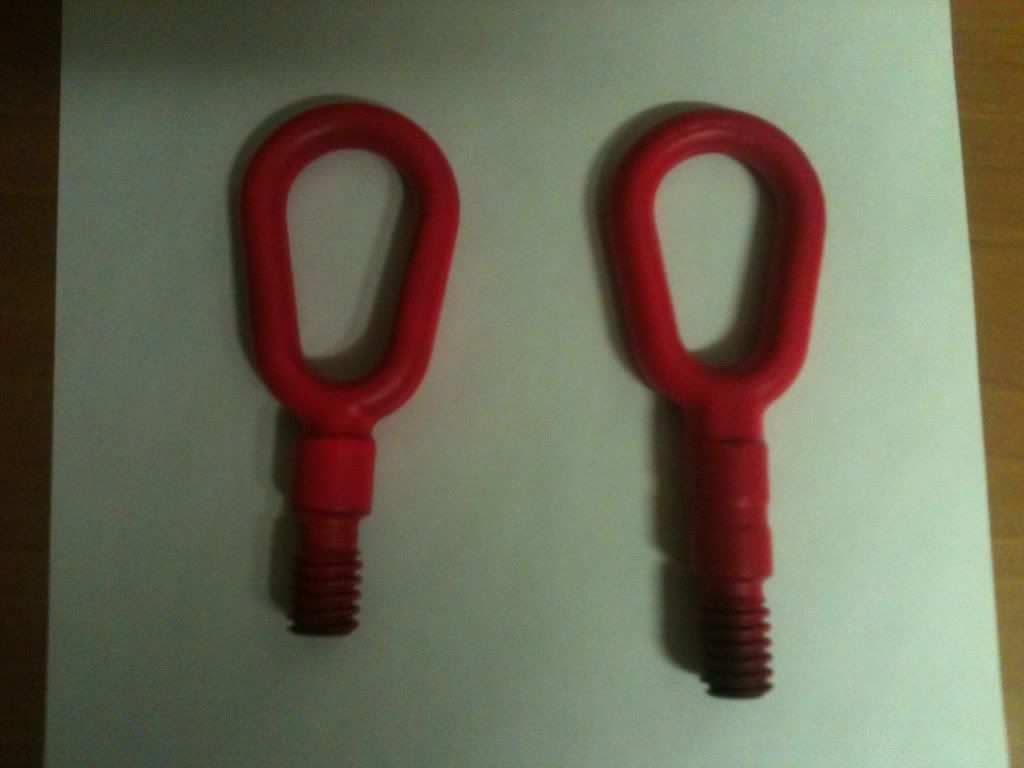

              While all this was happening I signed up for my first drift event. So naturally I had to make sure my car would pass tech. I painted my tow hooks.

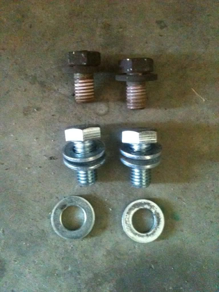

              I also added camber bolts to my front so my car would oversteer a little easier
              New vs. Old

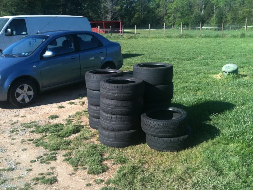

              I loaded up my car with a shit ton of tires. It took me two trips to Charlotte to get them all there along with all my tools. The morning of one of my friends and I loaded our cars and headed out. Both were stuffed with tires, tools, food, and other random stuff.
              Made it to the event and got ready to go. It really was a ton of fun. I'm registering for my second event within the next week. Here are all the pics I got/could find.

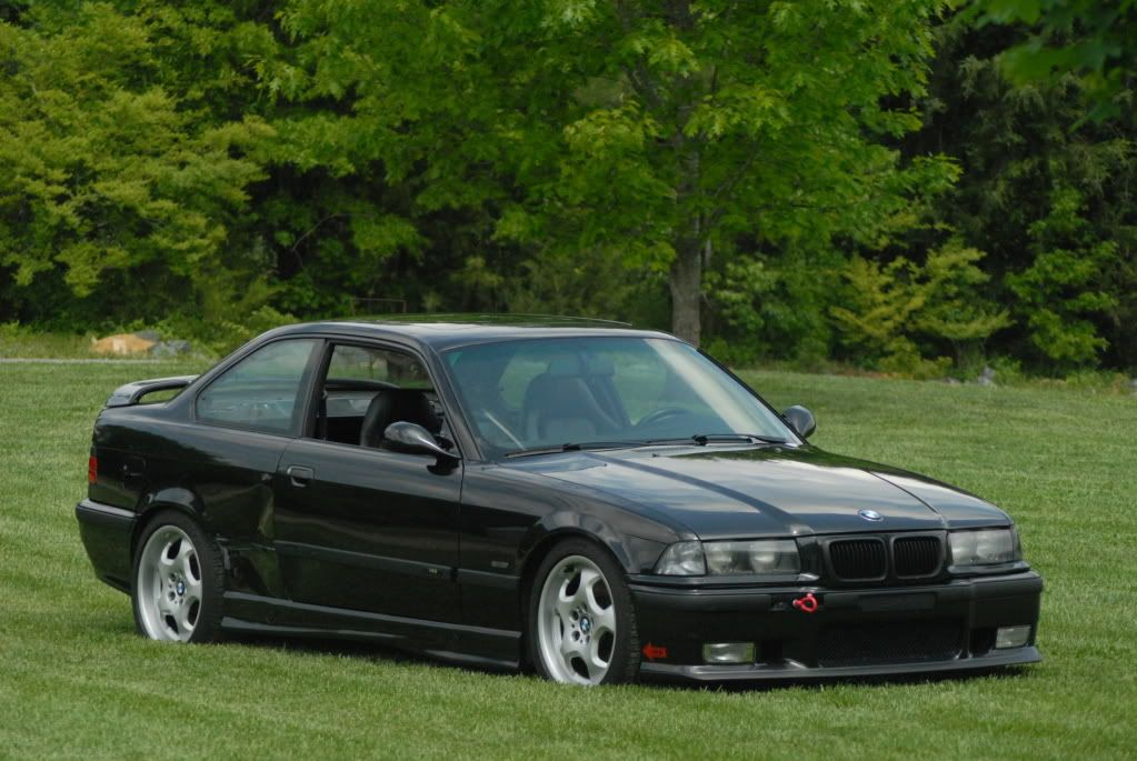

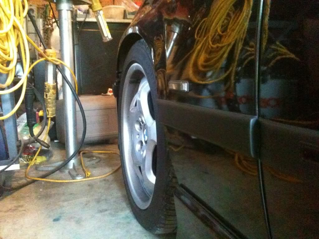

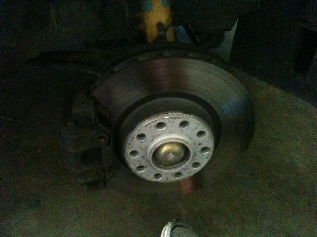

              After that I got an alignment check. It was awful. So I went ham on the car. I basically aligned it myself. I also finally got my 15mm spacers from TMS. So those went on the front and the 10s got moved to the back.
              10 vs. 15

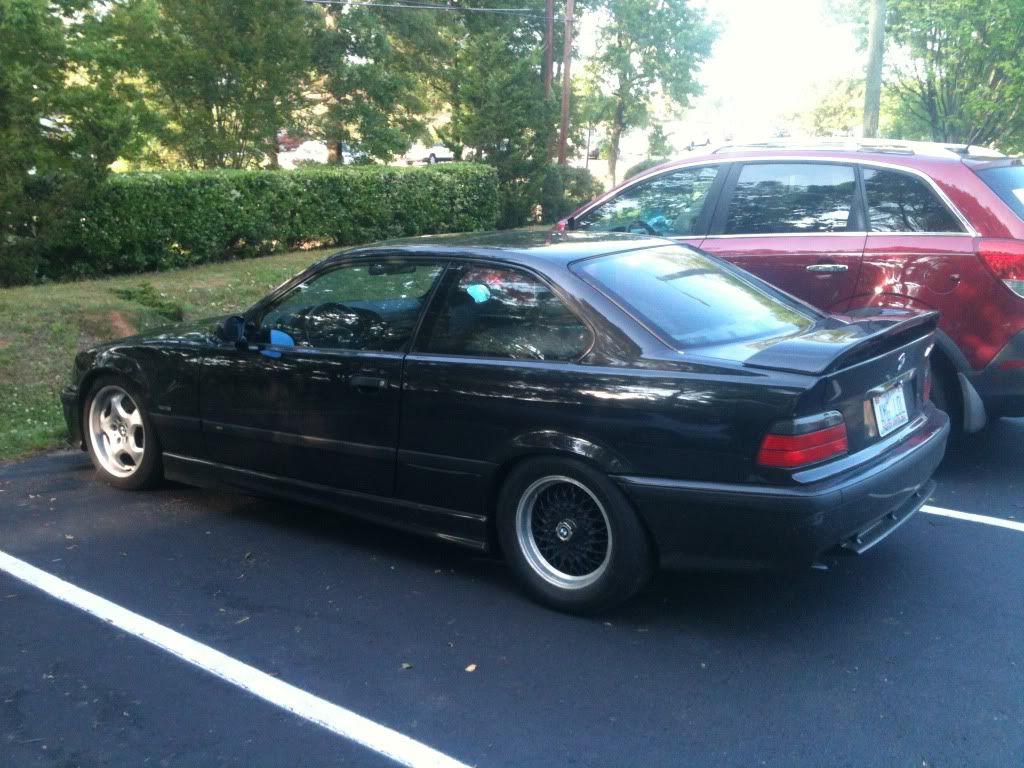

              Heres one pic of the car actually clean with the 10s in the front. I haven't taken one with the 15s yet because the car is disgusting and I can't wash it at school.

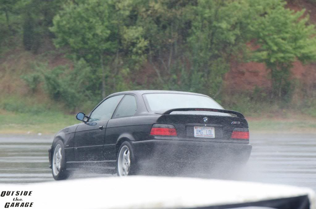

                I used to want a track day car but after I did my first streetwise drift event I decided I wanted a drift car.
                So I started work.

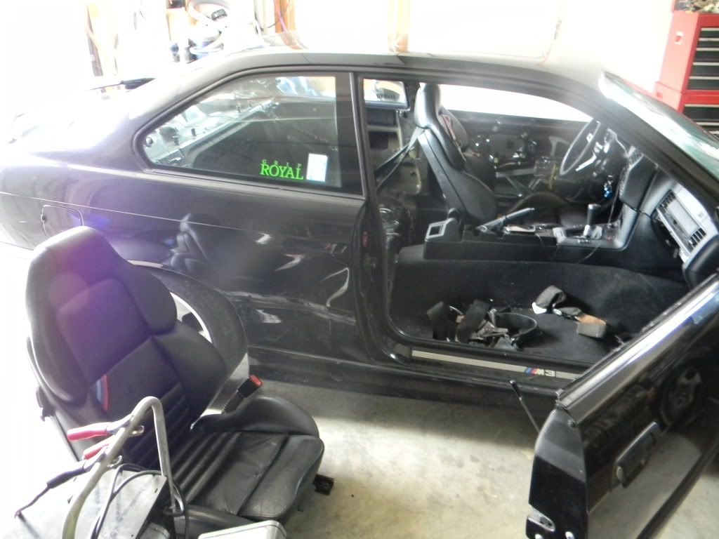

                I gutted it
                Got some tires and did my first drift event.
                After that I was hooked. I threw it into overdrive.

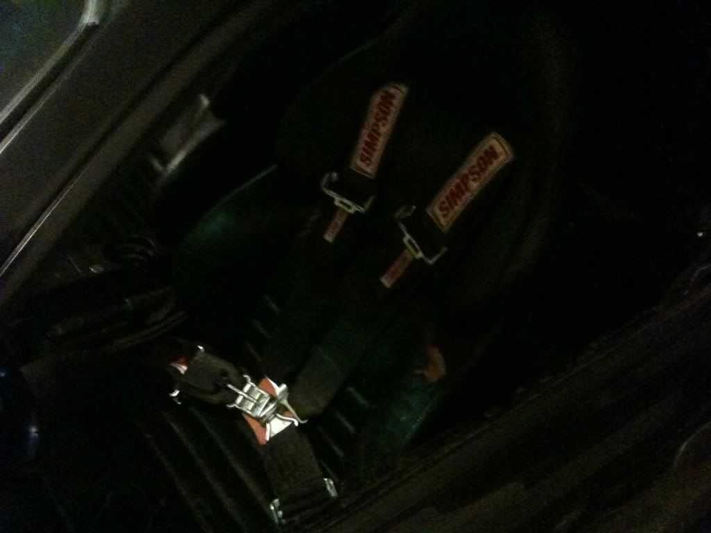

                I got harnesses
                Instal
                Done

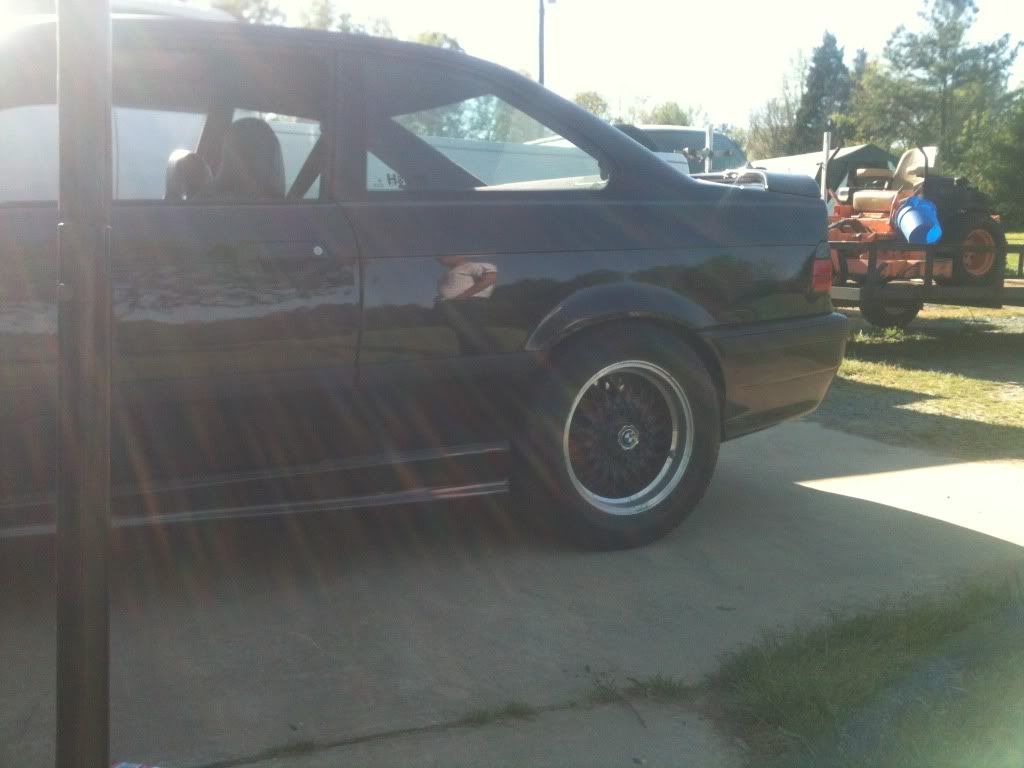

                A 13in dirt track wheel
                Added camber bolts
                15mm spacers in the front
                10mm Spacers in the rear

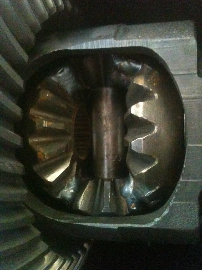

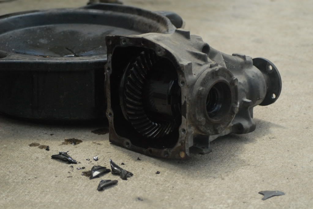

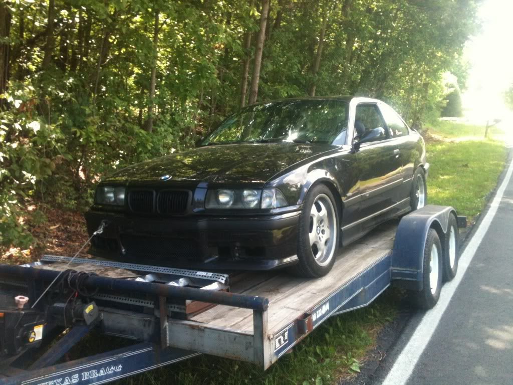

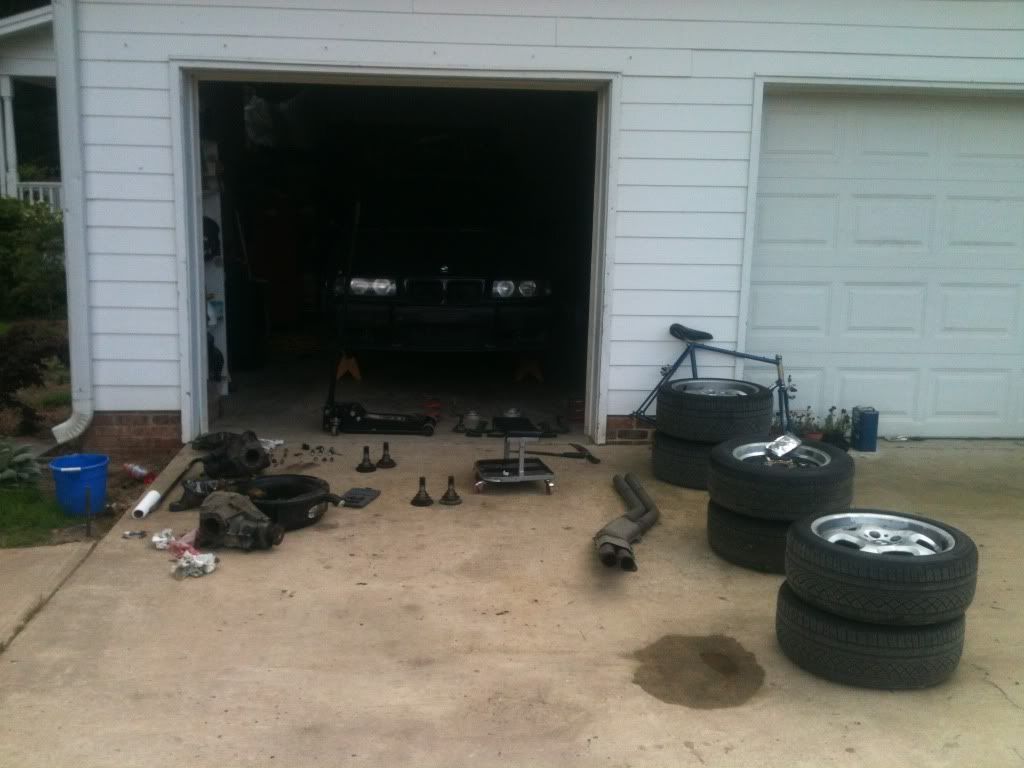

                Then shortly after my stock LSD exploded, it had 167k miles to that's not a surprise. Good thing I was only a mile from my house. Got a ride home and trailered it back.
                Took it out. Took about 2 hours with lunch
                Popped it open and....

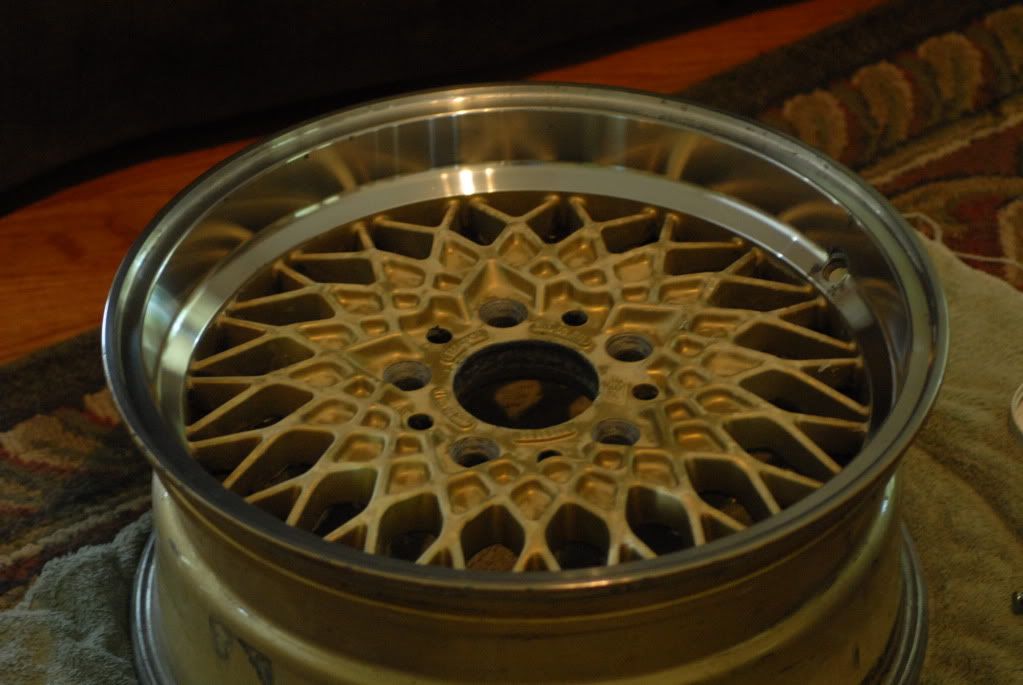

                Next on my list of to dos are D2 or BC racing coilovers, A harness or roll bar so I can mount my harnesses correctly, My welded diff should be done sometime this week and I'm currently refinishing a set of genuine BBS style 5s from an E30 M3 for drift spares then i'll be set.
                Here's a sneak peak of the wheels.

                              I'm looking to get D2 coilovers soon. Then it'll get low. Just wait. I'm a college student with a budget of like 0 so it's gonna take time. And my car is a hell of a lot lower than some of the cars in this section.... And it's an e36 it's old and I don't really care how it looks if I get to have a fun time driving it, which I do.
