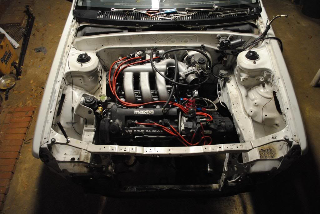

My 323 build.

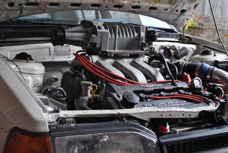

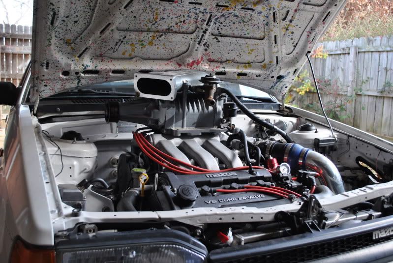

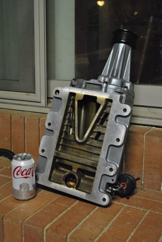

Got the new charger last night. It's in great shape. He actually threw in the plenum too which is a huge bonus. I thought I was going to have to make it from scratch.
Now the next thing is going to be making my car run off a twin 65mm throttle body and IACV that the Lightning uses. I figure as long as I can get MS to read the right voltage that the Lightning TPS will give off it will work.
Without the plenum..
^ lol.
Here's the general idea of what I want to do. Most of the manifold will be cut out below so it will sit a bit lower. Only thing is I still need a midplate so that might cancel out what I take out of the intake manifold, and it will still sit high. The pulley lines up nice so that's one good thing.
I've got to figure out how to make that plenum work though. It's going totally in the wrong direction. lol

It's off the '82-'92 Camaro. This one was a Z28 so it's a bit bigger than the RS.

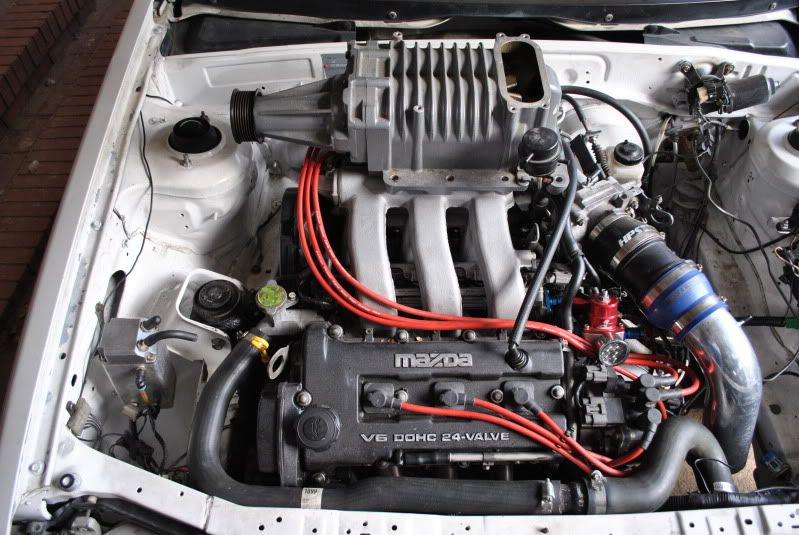

Well I decided that I wanted to build the motor as well as fix a lot of issues before boost so changed plans a little bit!
Current status of the car. Time for a serious motor build. Planning to clean up a lot of the little issues.

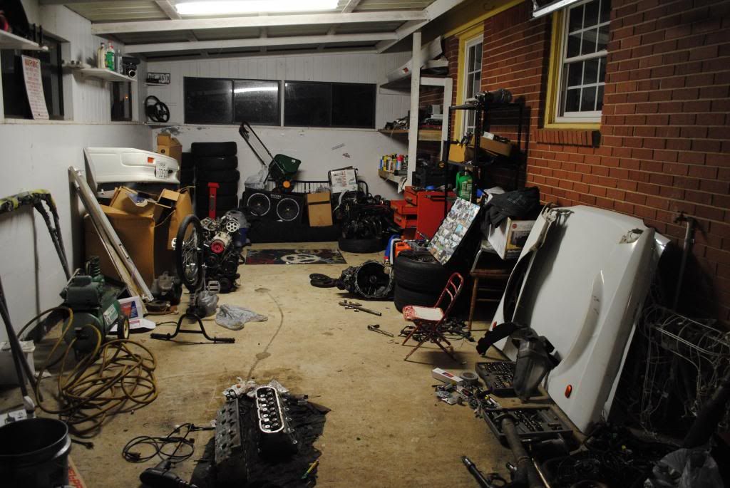

My extremely messy garage. Looks like a 323 junkyard. lol (Can you spot the one Chevy part?)

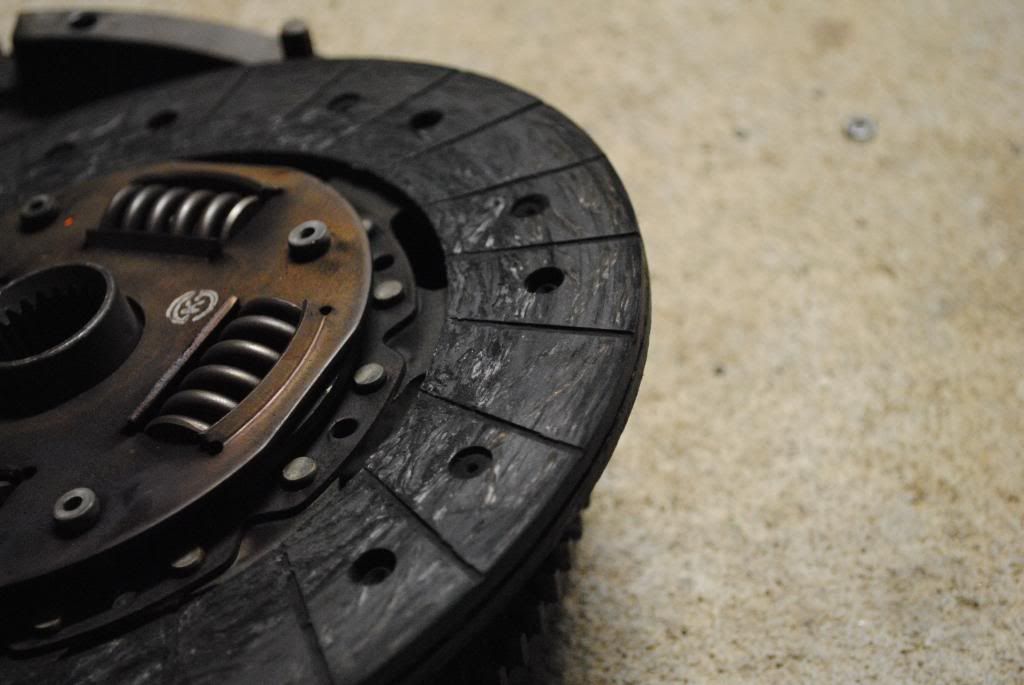

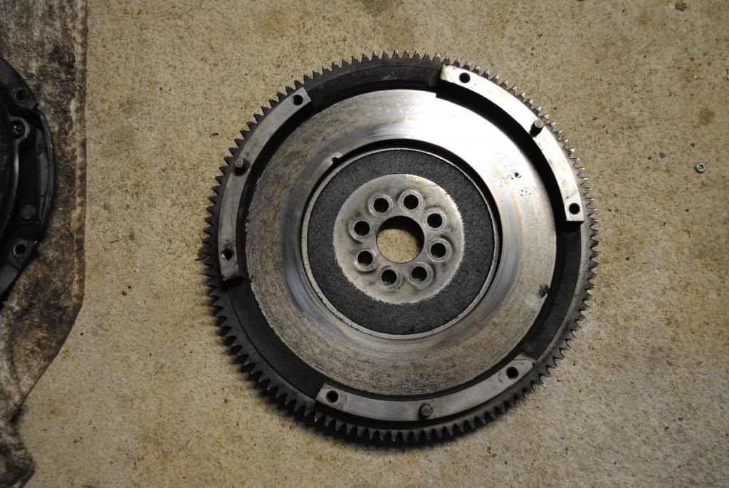

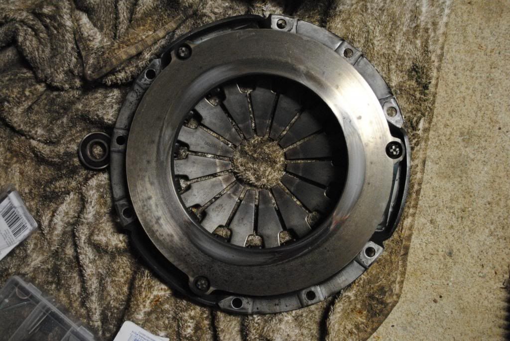

My pressure plate. Check out those heat marks.
Disk isn't so bad, but still won't hold what I plan to do. Just FYI, F1 Racing clutches will do just fine for bolt on KL setups.

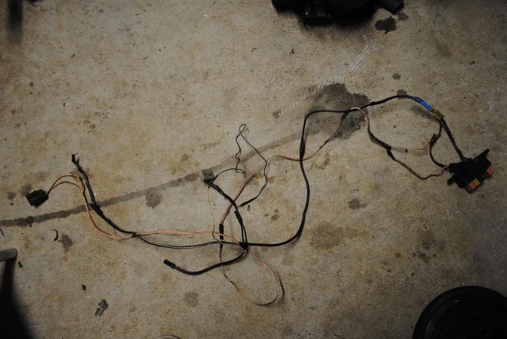

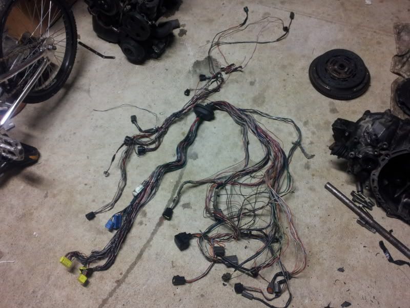

Took apart the harness and cleaned it. Plan on taking a lot of wires out of it I don't need.
Put the car back on the ground too. Hoping to clean up the bay some this weekend. Can't wait to start buying parts!
Harness nice and tidy! All egr and most all probe related stuff removed.

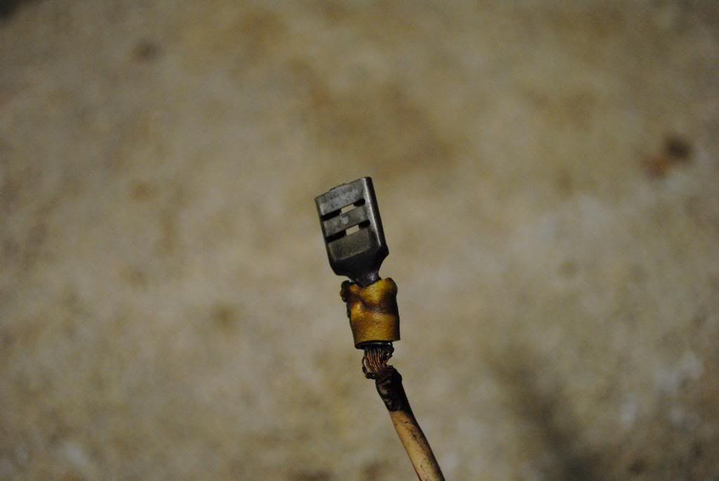

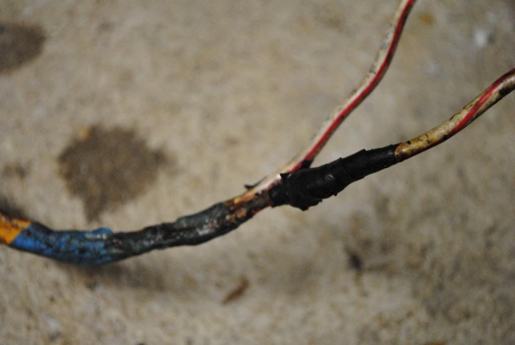

Next up is completely redoing the charging harness. It has many breaks and splices in it which I think is causing it to burn up over and over again. That and the fact that the KL alternator puts out more amps than a B6 alt.
Should have fixed this a long time ago..
