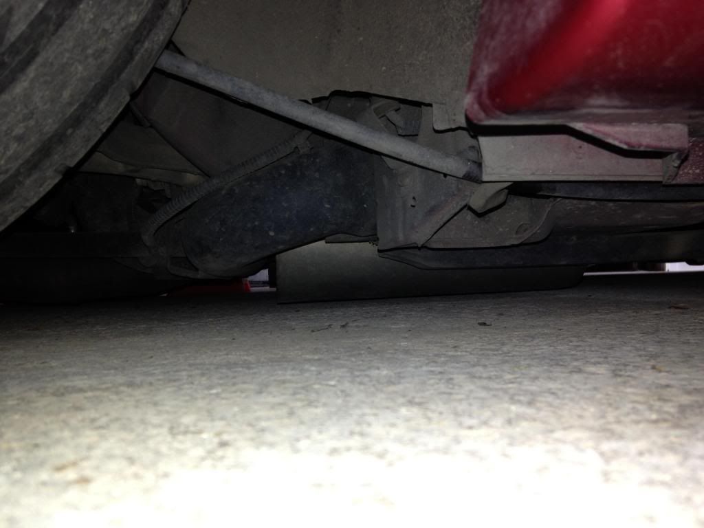

        • This morning I made the trek down to Billet Pro Shop. They're a new name on the scene, mostly for short shifters and Mustang parts, but I've known Sylvain for several years. His street driver is a 10-second GT500, and his track cars are even more awesome. His daily clientele is a long list of 700-1000 hp Mustangs, but for some reason he really likes my Cobra as well.
          I went down there thinking I'd be in the shop for several hours. I wanted to have them see if they could work on my exhaust system to get more ground clearance. As it was, the cats would sit on the ground when aired out. On a Mustang, the exhaust is the lowest part, and mine has been getting abused for several years now. The Bassani high-flow cats were flat on the bottom, the mufflers are all bent and scraped, and most of the rear hangers showed signs of having touched the ground. I had purchased a pair of used Bassani cats from another forum to swap onto the car because I thought one of mine was getting clogged.
          Once we got the old cats off the car, we immediately noticed that the new ones had a more compact body. They would fit, and being 3/4 inch smaller in diameter than the old ones at their biggest point, we instantly resolved the ground clearance issue as well! We readjusted the fit of the complete exhaust system to get things lined up a little better and keep it tucked up under the car, but it was easier than I thought it would be.
          While we were under the car, I noticed that the rear shocks were working their way off their lower mounting bolts. The inner sleeve of the bushing was still in place but the rubber bushing itself was working its way over the head of the bolt. We removed the bolts, put big fat washers on them and reinstalled them. Problem solved! I figure this was happening because all the weight of the car is sitting on the shocks when it's aired out. Fixing this also eliminated one of the annoying noises I was hearing in the rear suspension.

              Nah, it still airs out at the same height. I just wanted to get the exhaust up to keep it from getting destroyed any further. I drive this car regularly in the summer months, and unlike other people on this website I don't think it's cool to leave parts lying on the road because I'm so low. I can't afford to replace shit that I broke for some stupid reason.

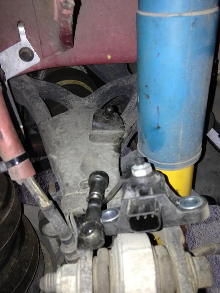

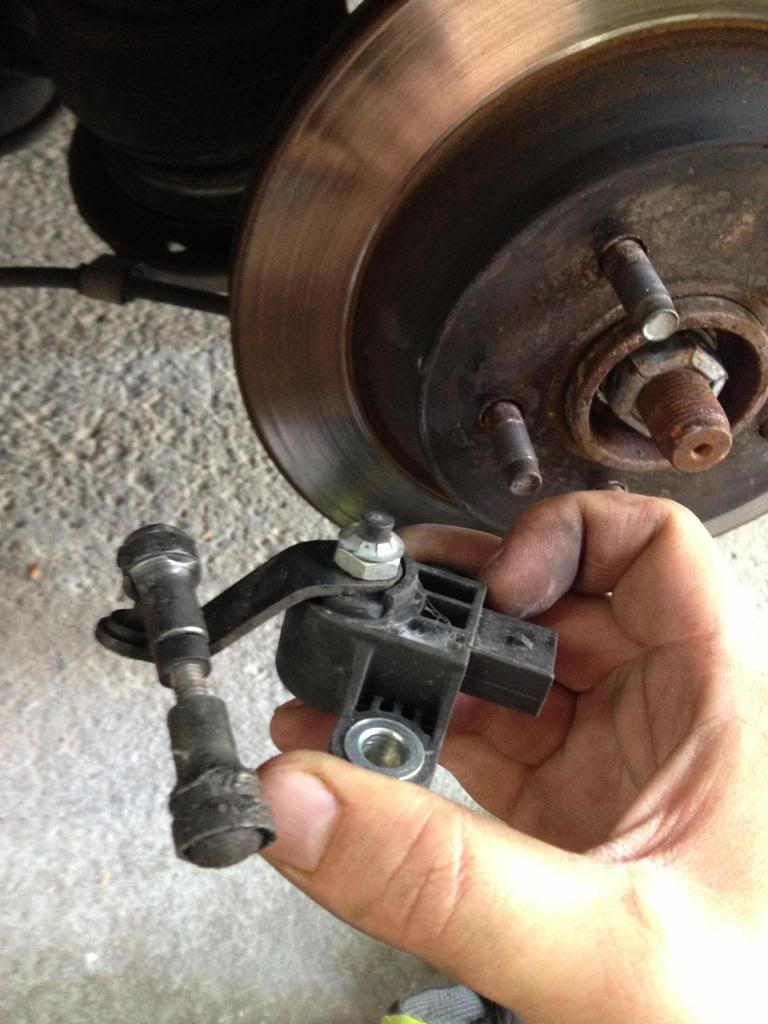

                            One issue I was having last summer was an error for the left rear ride height sensor on the eLevel system. I just didn't have time to check it out, but the air system was still working well. Just when one of the sensors bug, the preset heights don't work, but the height adjustability is still fully functional.
                            This weekend I finally brought my toolbox home from my friend's garage, so I was able to pull the left rear wheel off the car to check out the sensor problem. I don't know how it happened, but the sensor's swingarm got bent in two places, and the mounting tab on the upper upper A-arm was also bent. The pushrod had become disconnected from the upper A-arm, so the sensor wasn't reading the actual height of the left rear corner. Instead, the sensor was just flopping around and giving erroneous data to the ECU, so the ECU would adjust the air pressure randomly based on those false readings.
                            Right now I'm in the process of contacting Accuair about what I can do to fix this. They've suggested that I could just bend the swingarm straight again and I should be OK. It's a free fix, so I'll give that a shot next weekend when I get back home.
