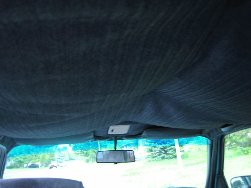

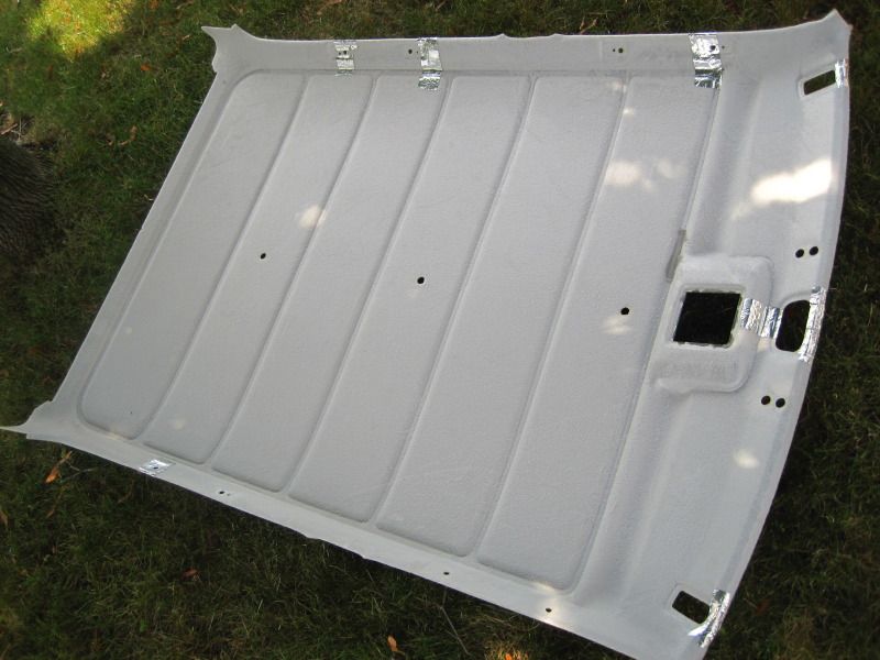

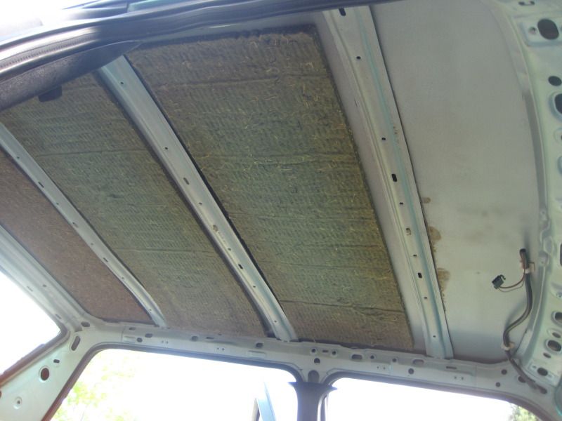

              • Oh look, no more headliner. Because racecar??
                No, because beige headliner in grey/black interior looks like shit.
                First you gotta fix the cracks with aluminium tape, since that big piece is about as rigid as a Lay's ketchup chip.
                Layin' some fresh denim on it

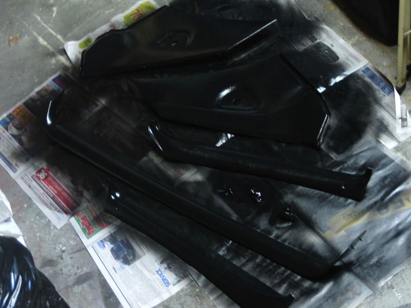

                Meanwhile, I painted the interior pieces that were beige with black paint.
                Finished product. Now I'm just waiting until tomorrow to install it, so the paint and the glue can cure.

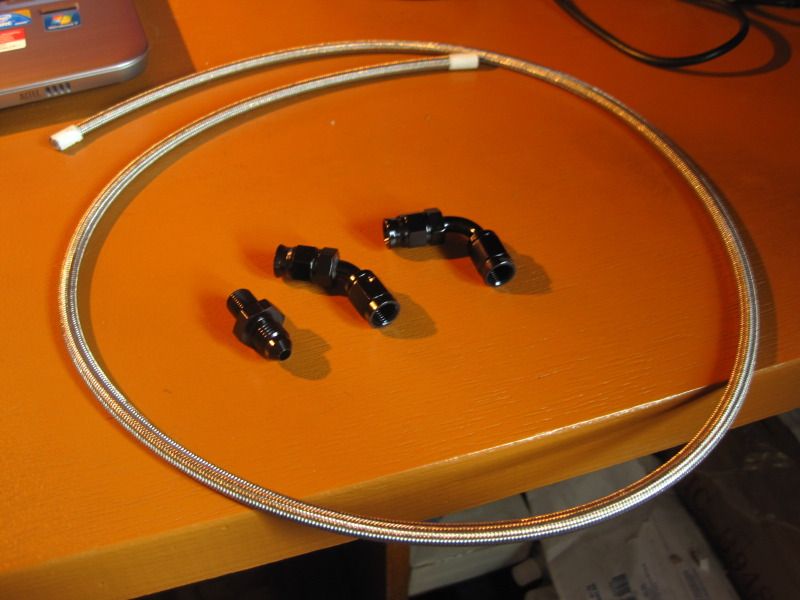

                I also recieved my oil feed line. I'm going with AN stainless braided lines for the the turbo's oil feed and drain.

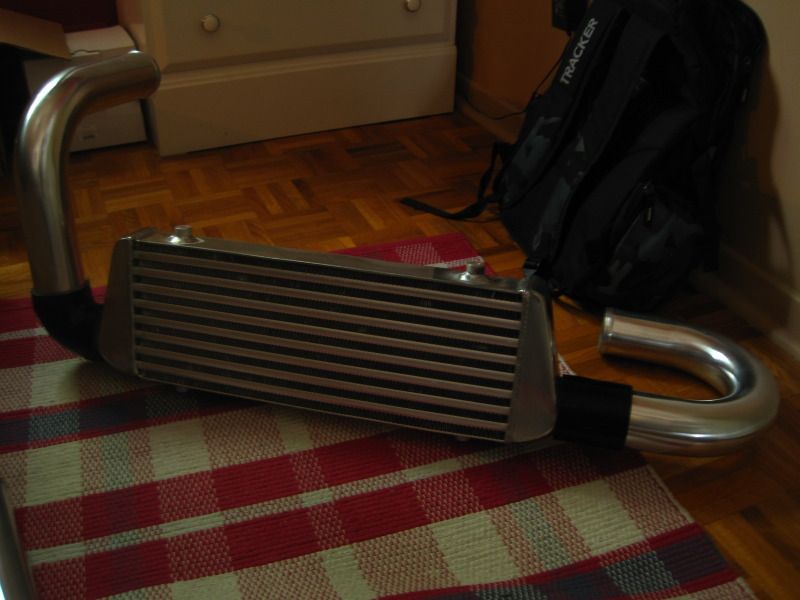

                Here's the intercooler and a couple of pipes, I never showed you that.

                  What kind of glue did you use for your denim? I covered my pillars with denim and am having issues with both glues I've tried. Goes without saying that I'm waiting for a proper solution before tackling my headliner with fake leather >.<
                  Flickr
                  Projects :
                  1984 W123 300D (Sold)
                  1999 C43 AMG (no thread..yet)
                  • I used 3M Super 77. 21$ a can, but its worth it. Watch out though with what kind of denim you use. The one I used wasn't very thick so its easy to work with, but I've heard with thicker fabric such as vinyl it can get tricky.

                        • I just pulled my interior trim pieces out as well as my headliner, and sprayed them with black vinyl/fabric spray paint. it came out nicely. headliner has a uncomforatable cactus type feel, but who really touches their headliner on the daily? regardless, i like this car keep up the work. its awesome how little you are actually spending on it too, mad respect for that!

                          • Ok guys don't use Super 77. Or at least don't use a can that's been collecting dust at your house for 3 years. Or scrape the old glue off your headliners.
                            At least I managed to repaint the beige trim in a color that matches the black PERFECTLY. But you have to believe me on this one, I ain't got no pics.

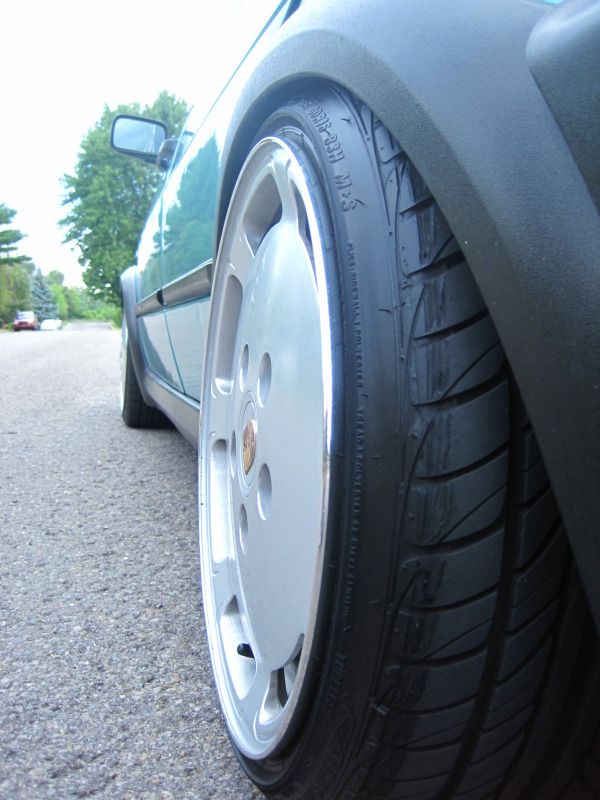

                            I found out my car was higher on one side on the back. 3/16" exactly. Dropped that shit lowar.
                            Damn tire shine gets scraped off the tire on each bump lol.

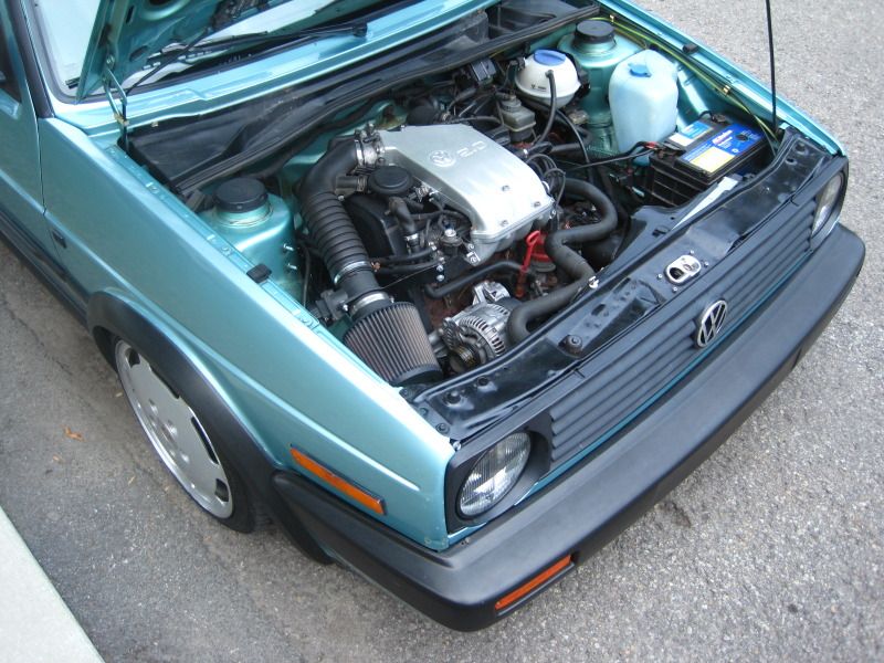

                            Just for kicks, one last picture of the N/A engine.
                            No problem officer, its all stock.

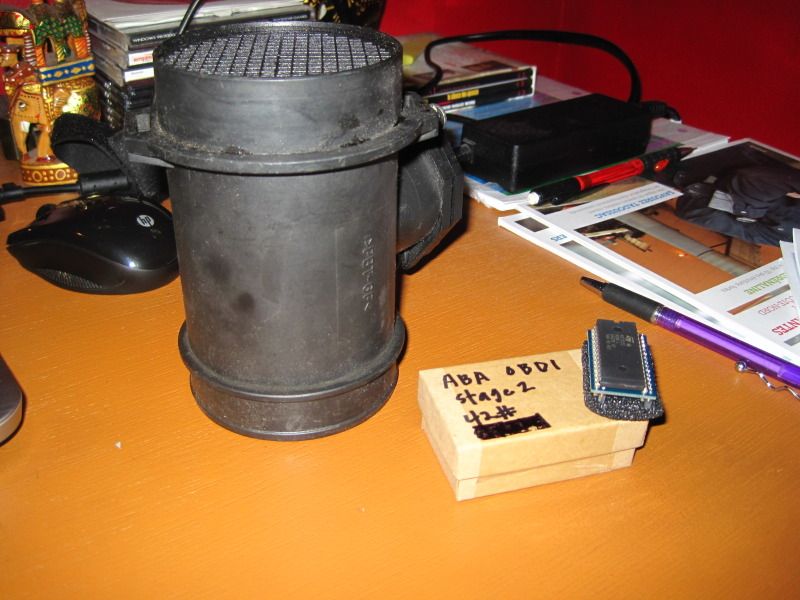

                            I also got a huge VR6 maf (well, huge compared to the 2.sloooow one) and a chip for the 42# injectors that I still don't have yet... Someone want to buy my 30#'s?
