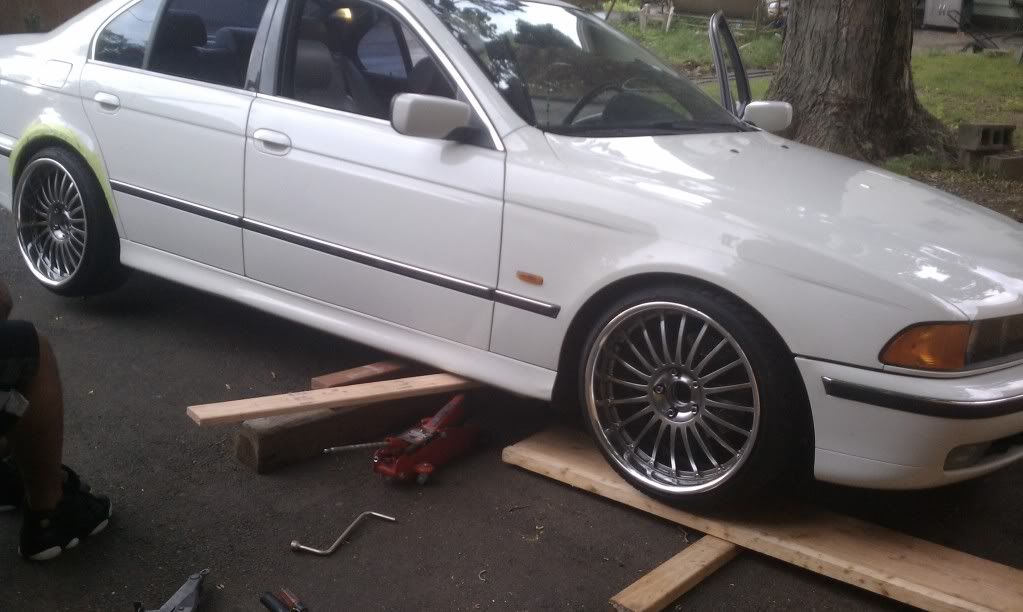

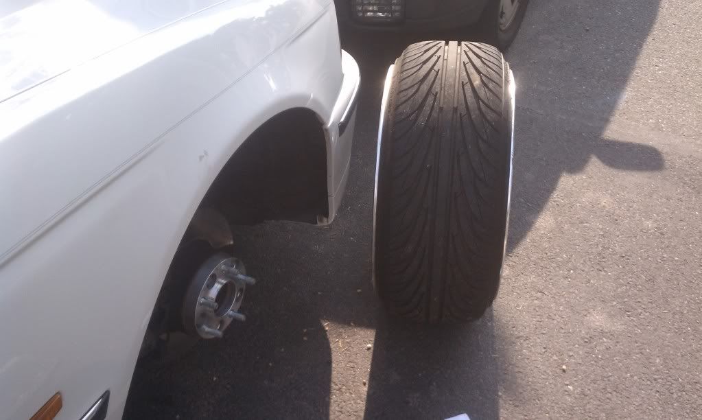

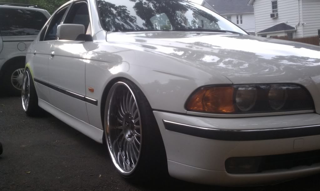

well after almost a month of no work to the car, new spacers for the rears. final et rear is -7 and fronts are +3
and after hours of play the fronts are maxed out and rears still have alot to go, but unitl i roll my fenders the height stays
If you want to go lower in the front, see if you can get shorter springs. I'm not sure how Bimmers front suspension is on these, but I can get shorter springs for mine and not lose shock travel.
Roll fenders, add 1-2 negative degrees of camber in the rear, and lower it a touch more.
