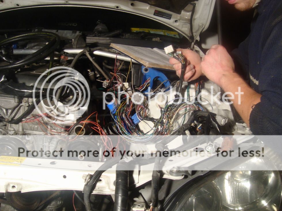

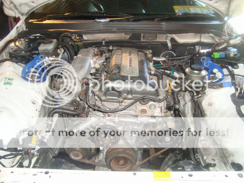

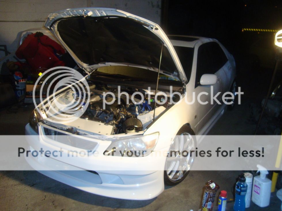

        Then came the easy part, fitting the engine and box, you see Martin has already claimed world fame with his crazy builds and had an SR20 Altezza track car so it was simply a case of copying engine and gearbox mounts for my own road car ! Roll the arches now, run a return fuel line as the Altezza's only have a feeder, splicing the fans to the S13 alloy rad and making up brackets for the cooler and rad...

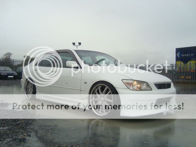

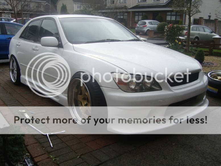

          On went the fab work making everything up to suit the car so as to give all the parts a factory fit appearance, knowing the engine would outshine the look of the car it came time to get some proper wheels under it, so I ripped the wheels off my FD3S for the Tezza and got to work. Hello Racing Harts, 19 x 9JJ up front and 19 x 10JJ at the rear...

              Tried on Martin's kit for a look and was sold on the idea so it came time to bring the car to a finish for now...

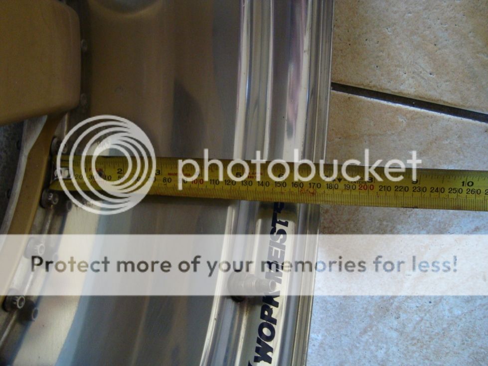

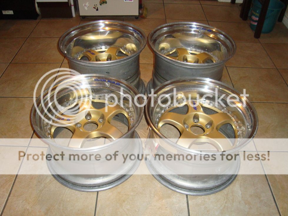

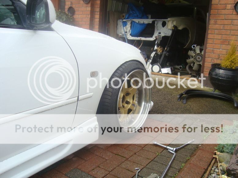

                        Hello Works
                        Front : 18 x 11JJ / +10 offset / running a 255 / 35 ZR18

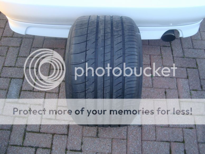

                        Rear : 18 x 13.5JJ / -10 offset / running a 315 / 30 ZR18 (N rated porsche tire)
                        I just threw on some KP61 over fenders to get an idea of the look, these will not actually be fitted, the new arches are yet to be decided...

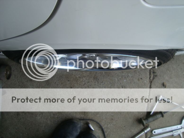

                          Carrying one as a spare would be funny as the first pic shows and fitting them will be even more fun, check out the older 10JJ rears compared to the new 13.5JJ rears, ouchie.... Slapped them on, threw on an over fender and even the puppy had to have a nose, thats all I have for now folks but as soon as I find over fenders to suit the car, I will get out the angle grinder and start to chop her up, promise LoL
