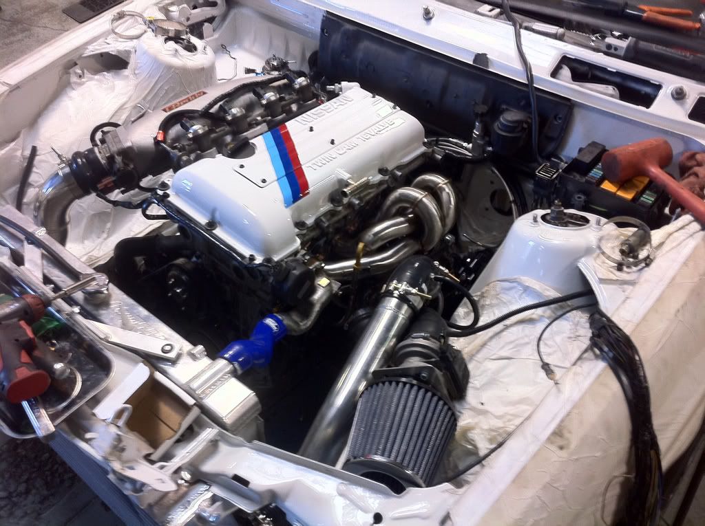

    Rear subframe has finally been swapped out... It's nice to see the car no longer at gay ride height, but now I have to figure something out to get the front lower.
    And minor modification to fit the shifter:
    Getting some work in before the valvecover goes back on for the last time.
    Tomei Poncams and rocker arm stoppers in.
    All sealed up... The valvecover didn't turn out exactly the way I want, but the body shop cheaped out and still spent more doing it than I wanted to pay, so I can always re-do it later.
    S14 T28 turbo is in, along with new manifold, and turbo outlet pipe... It all fits!
    Closeup of clearance. Vorshlag steering shaft definitely helped with clearance. Should make the steering feel much better too.

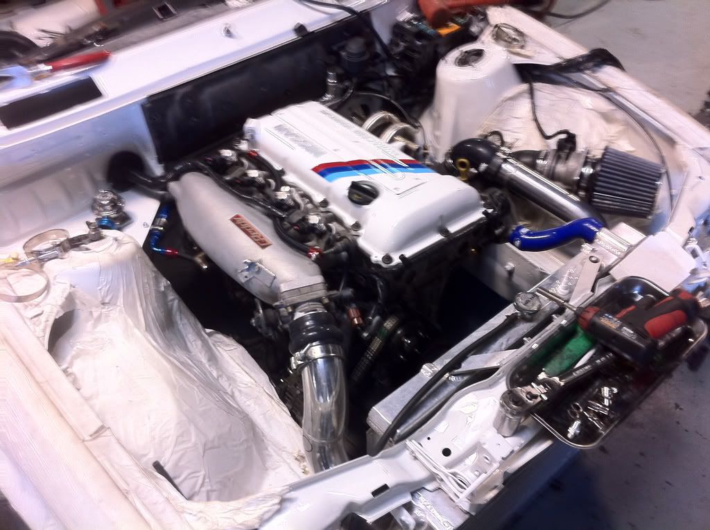

    Some more work... Intercooler piping is just about mocked up, and test-fitted the plastic bumper on the front, so happy to be rid of the diving board.
    Just hangin out
