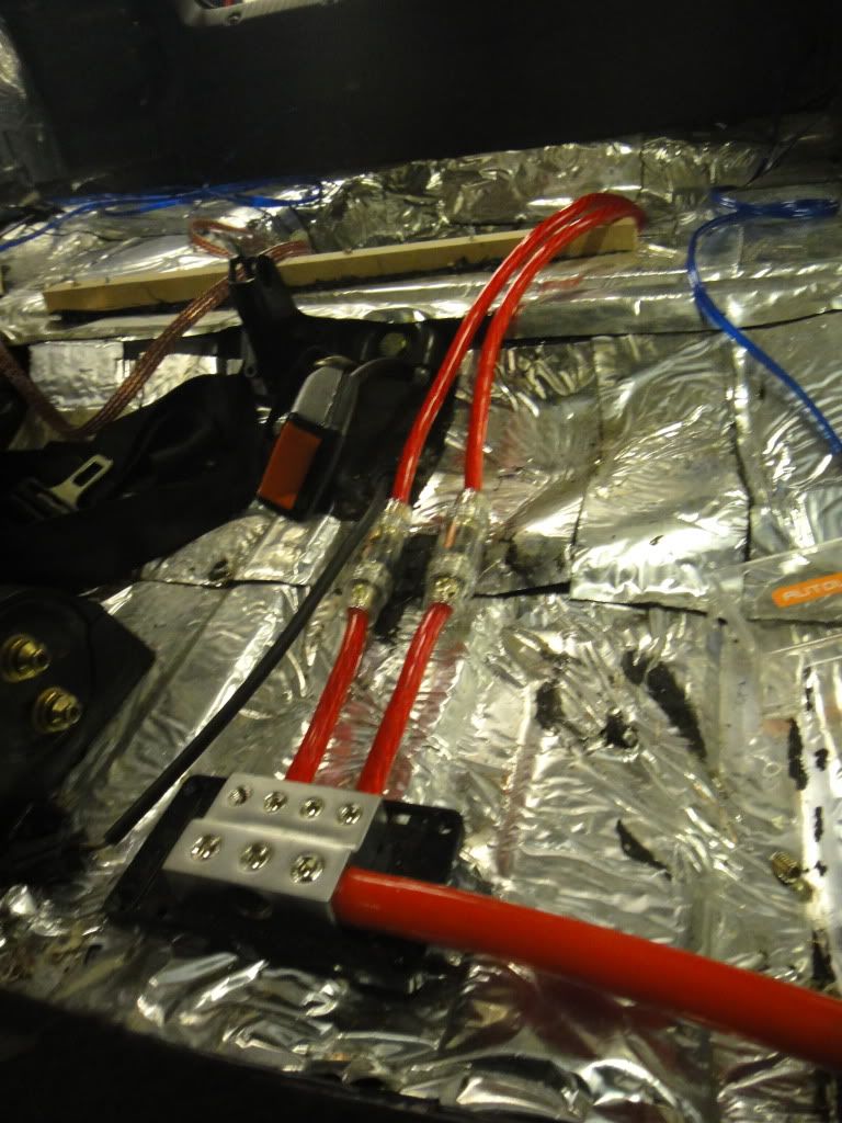

        As I was planning on putting some audio in it, I thought that this was the best time to lay down some cables & whilst I was doing some cabling I had to do the big THREE
        Now that we had the big THREE done I wanted to check what the vaultage was, before we did this it was running 13.0v - 13.6 & now it runs 14.3v - 14.5v on idle.

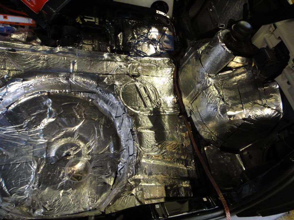

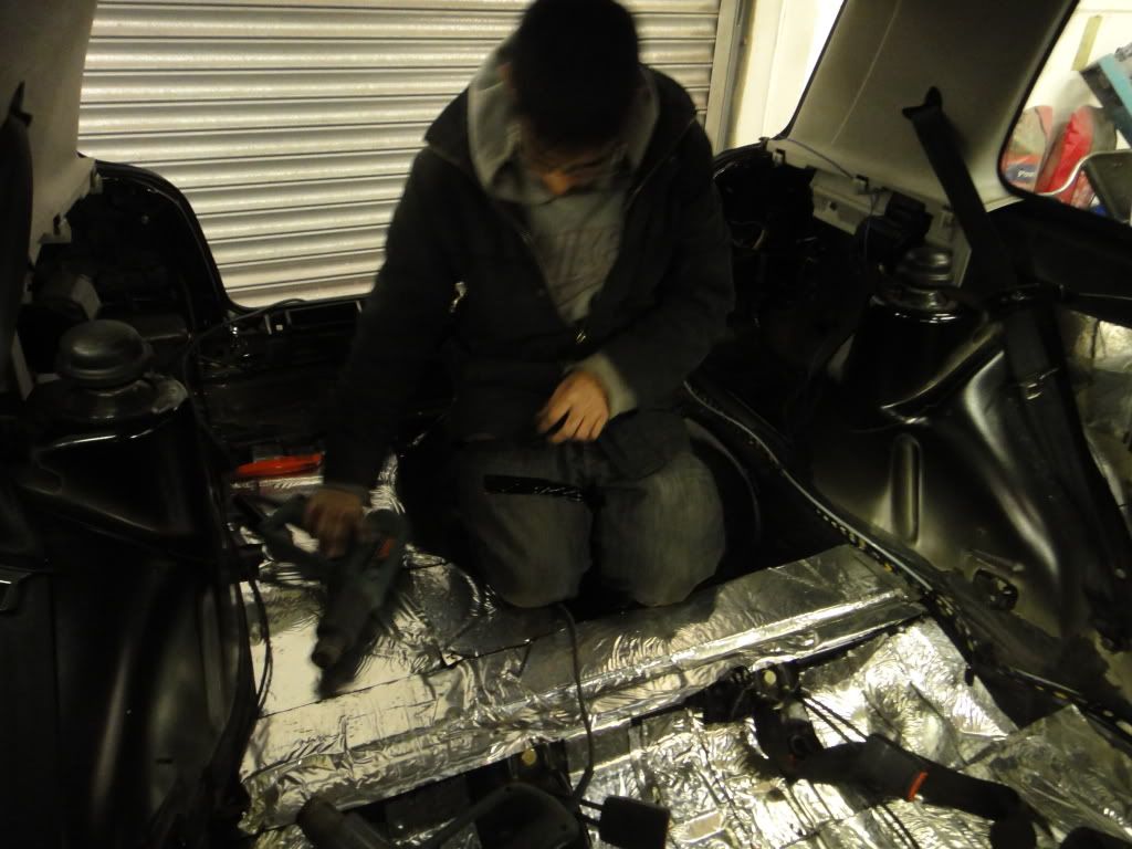

                              Next up was sound deadening, as it's a budget build I didn't go for any branded stuff.
                              Sonic laying some down
                              Whilst Satman cutting it up

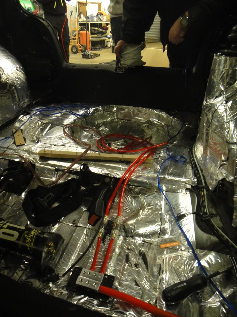

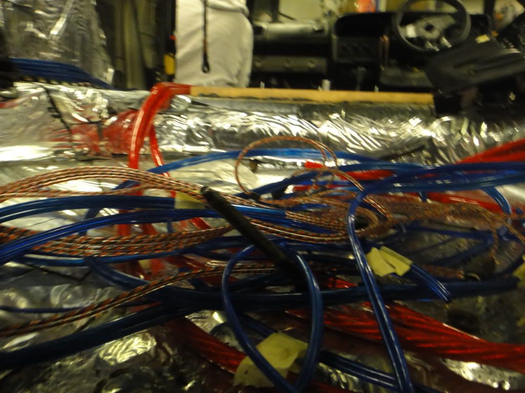

                              Time for some wires to go down & audio to go.

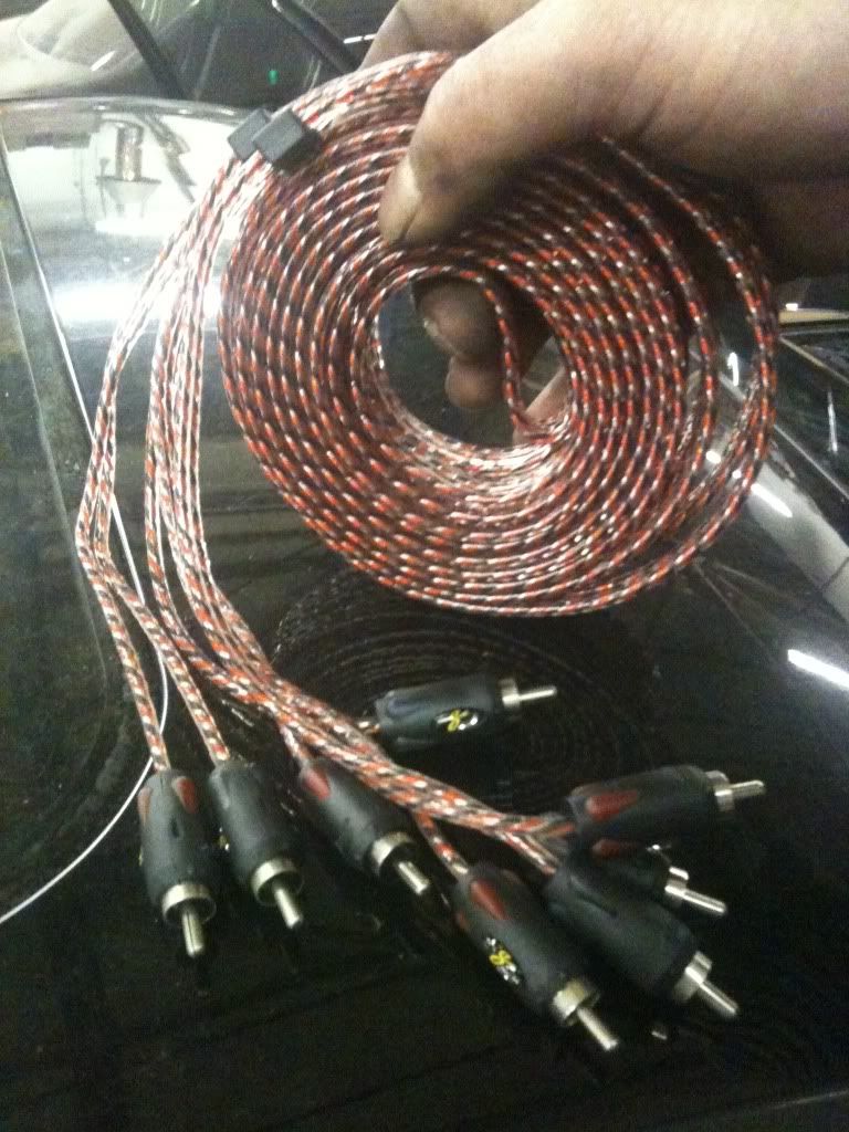

                              Stinger rca have been used
                              Audio going into the car

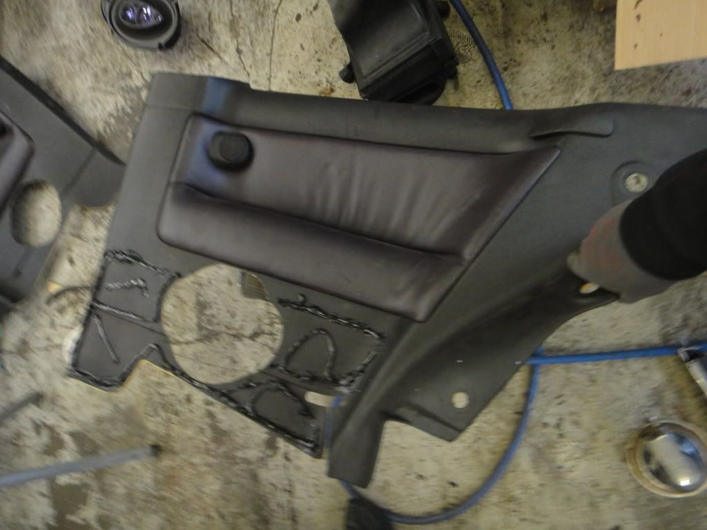

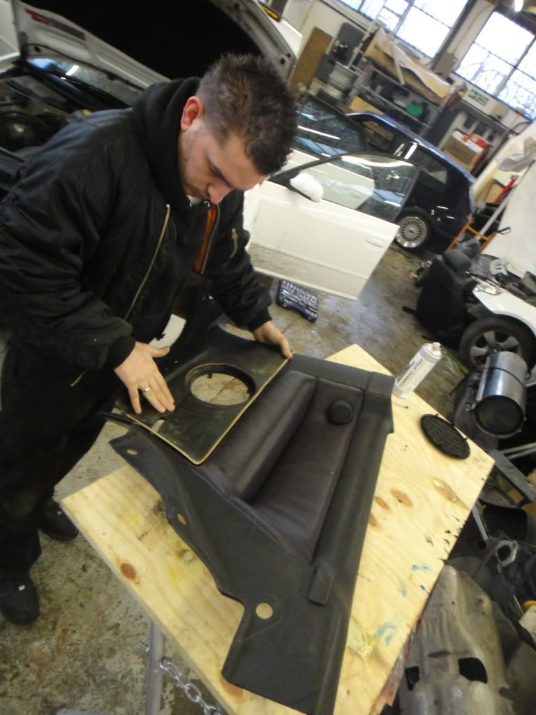

                              When I got the rear door cards out we found that some one previously had cut & screwed 6"x9" speakers in the rear door cards
                              This wasn't going to stop us so a temporary fix had to be done for us to complete this car by the end of tomorrow.

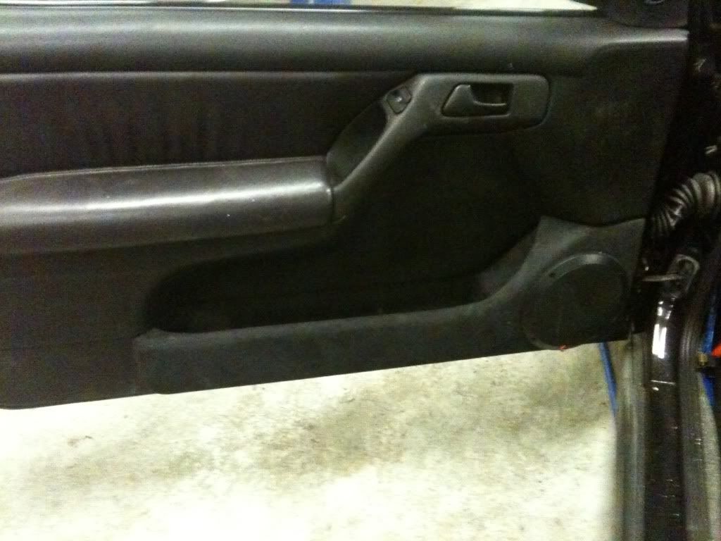

                              So we had to cut the bottom section on the original cloth door cards trim this section in black alcantara which it was going to be any ways to mach the front door pockets & roof lining.
                              Front door cards where complete so these now went on with the lower pocket trimmed in black alcantara & the tweeter housing

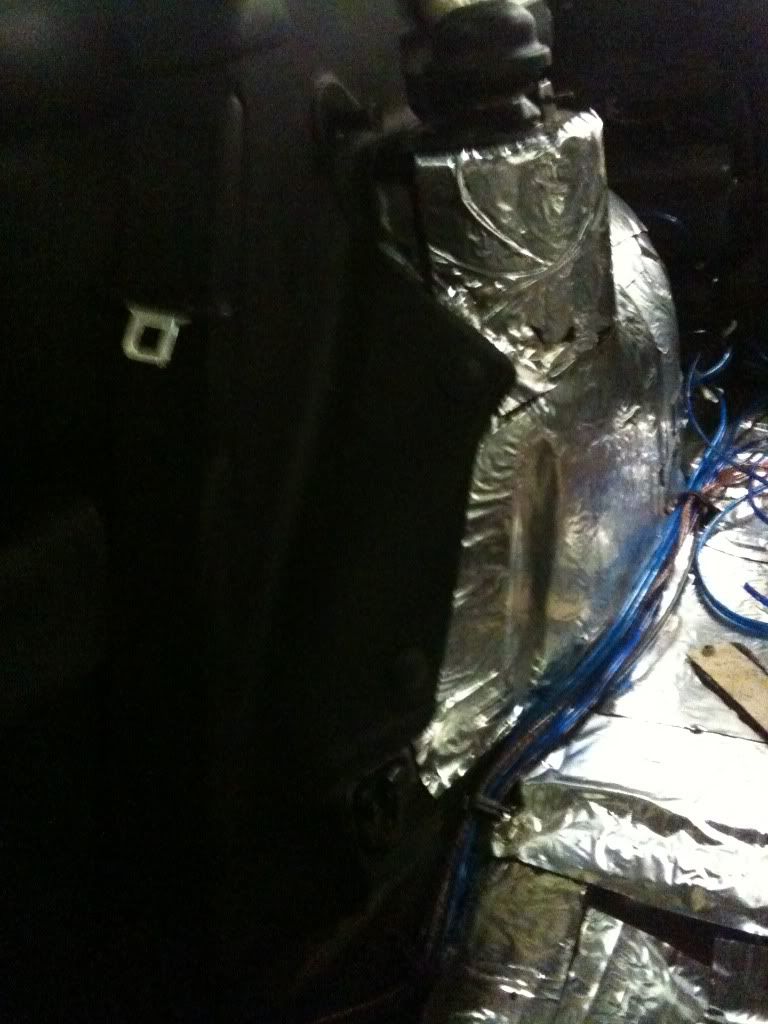

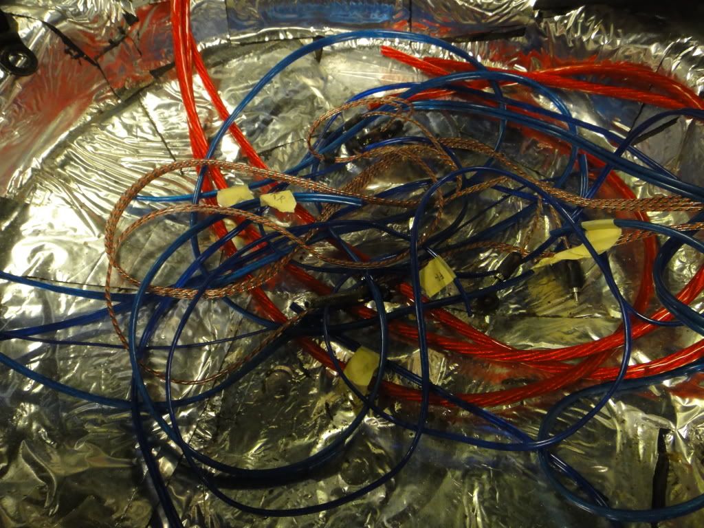

                              Neatened up some of those wires

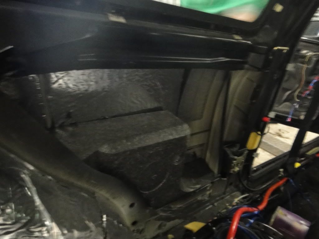

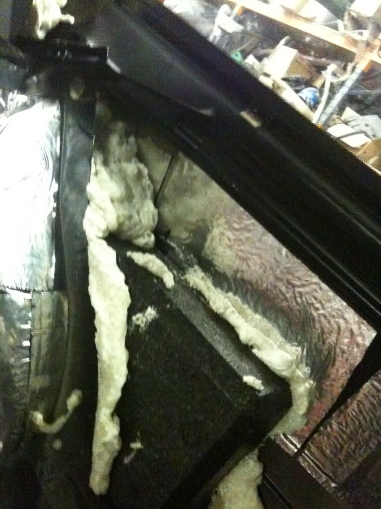

                              Then Expanding foamed areas & places where it needed it
                              Jake helping me out
                              I had by now made a false floor & laid it down & foamed under that as well.
                              Left this to go for that night.
