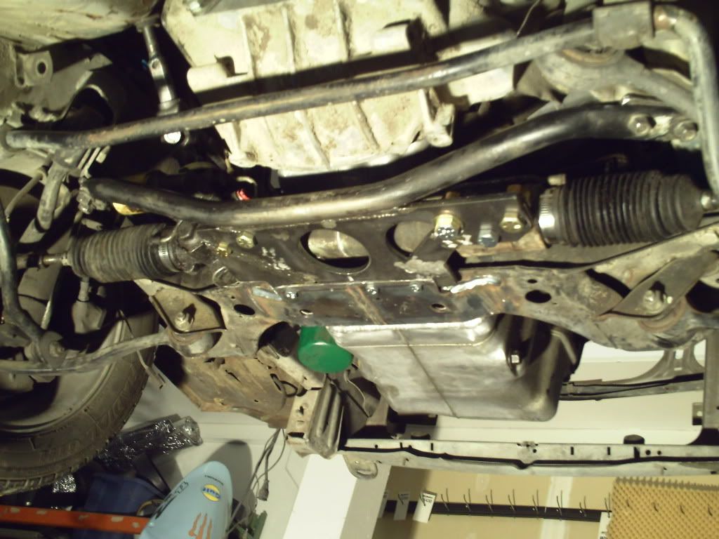

                Just sorted out some of the steering issues. I took the steering couplers from the cadi and the coupler from the BMW. The slip joint from the Cadi was seperated and the U-joint from the BMW was taken off, then the splined end of the BMW slip joint was machined to fit into the slip joint of the Cadi, where it was welded. Now it is Cadi U joint to BMW slip joint and the shaft should run on the firewall seal at the same place.
                The Cadi rack and BMW tie rod ends have also been reworked and shortened to fit .
                the only issue I have now is the throw is 5 1/2" compared to the throw of the box which was about 7". I would like to shorten the steerin arms at the bottom of the struts or fabricate new ones that are shorter to acheive near the same turning radius, although in only 2 1/4 turns lock to lock.
                Pics are not that great but you cansee what I've done.

                      Well, just finished the brackets for the steering rack mount and have the old cadi rack mounted in. This will give me much more room for headers. Still need to take care of the steering arm plates. I will take the ones of the donor car and have them shortened to give me better radius turns and quick steering.

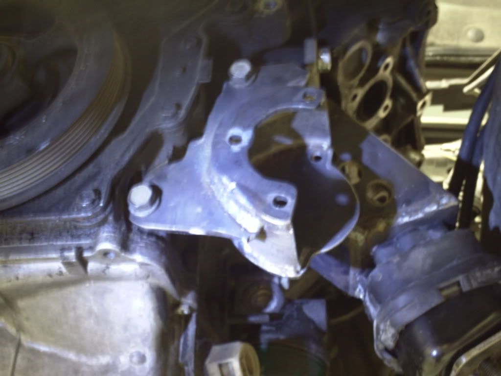

                          Anyways, the power steering rack is mounted so I started to prepare the mount for the steering pump. The Idea is to keep the P/S pump and the Alt. as low as possible and still keep them as easy to remove as can be.
                          Here is a look....crap pic but you'll get the idea.
