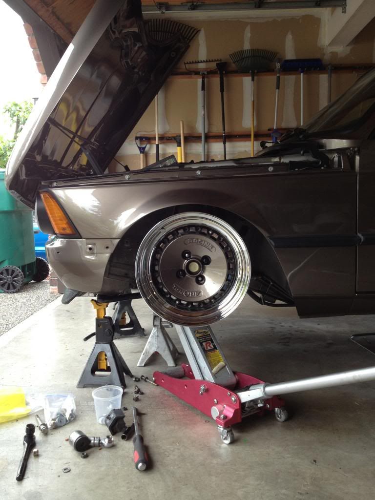

    • Well the arms kept hitting the subframe so we pulled a play from my buddy Chris' playbook and shortened the front subframe:
      My good friend Ryan is the expert welder. I'm going to roll on this with stock control arms for this show season, then we will do the custom ones over the winter. Should be much more simple and more like the factory pieces, but with track adjustment.
      The next gen control arm will just have a bushing carrier on in the inner control arm mount, rather than a heim. No need to adjust the distance of the swaybar to the inner mount. All the adjustment will be on the outer section to the strut. I also recessed the hardware that holds the subframe into the car so it won't be in the way of the control arm.
      Hoping to be at Leavenworth, with a few other tricks in my bag.

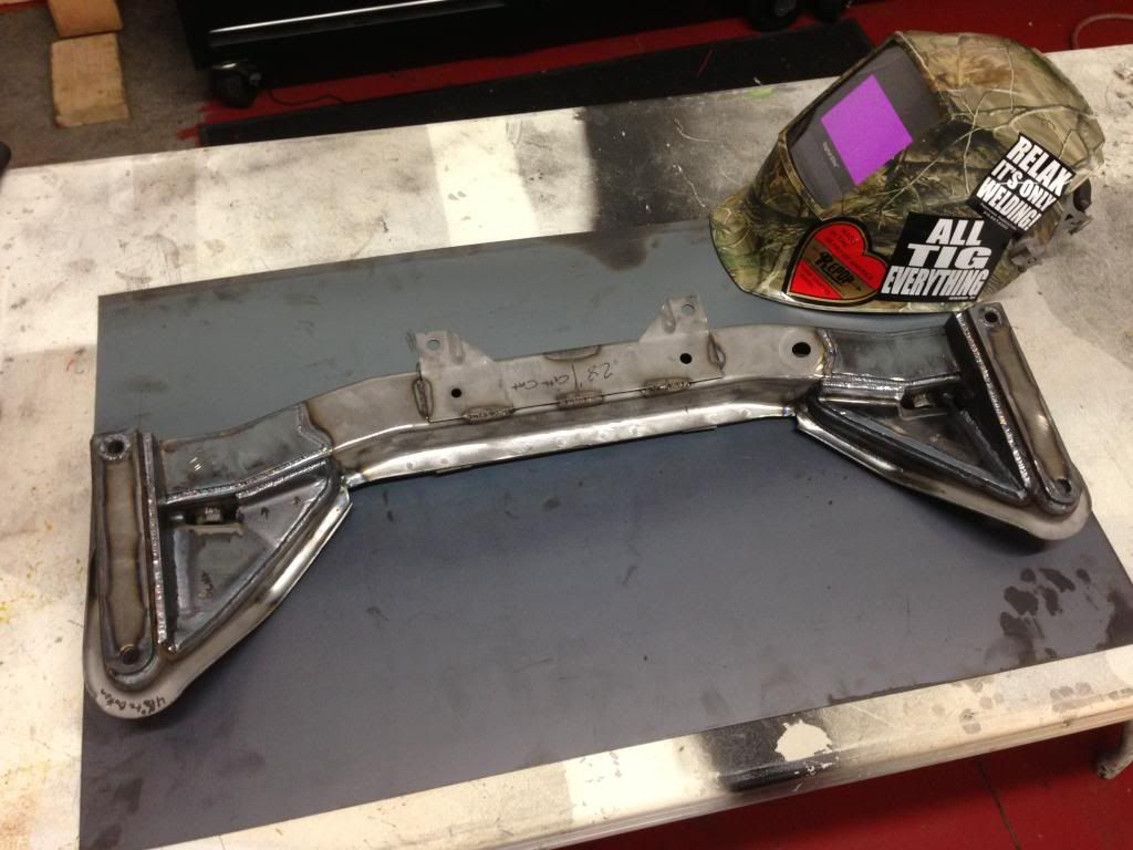

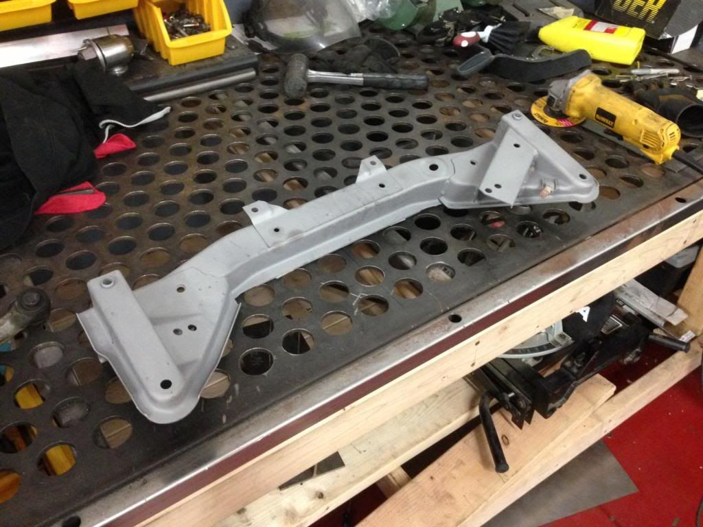

                • I test fit the subframe over the weekend. It's a good fit, just one hole to widen out a bit then it's ready for powder coating. Which is a crime because the whole thing is beautiful.
                  Here is a photo for height difference. It's almost exactly an inch, maybe a thirty-second shy. We added a 1/4 plate to the top to make it more rigid.
                  The control arm bottomed out again on the new shortened subframe, but it's so much lower now.
                  With the car fully aired up the control arms are fairly flat and I've got 4 inches or so from where that photo shows it bottoming out. I'm thinking it'll handle really well at a cruise height.
                  Comparison to before:
                  It doesn't look like much but these cars are not very happy going low in the front.

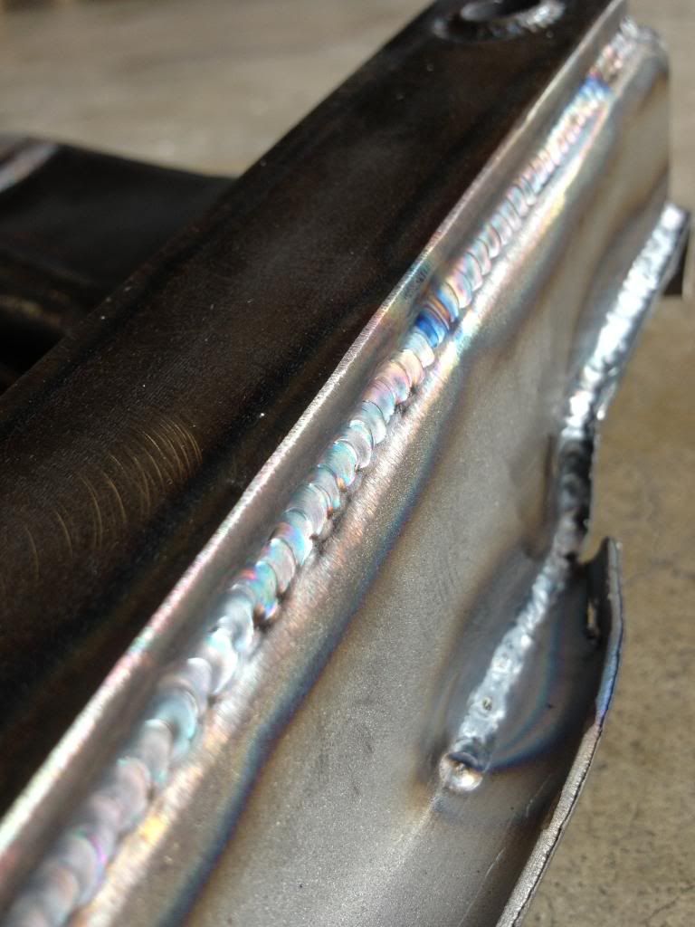

                            • Those welds on the subframe. Me Gusta.
                              Looks really good so far. Interested to see how it lays out.
