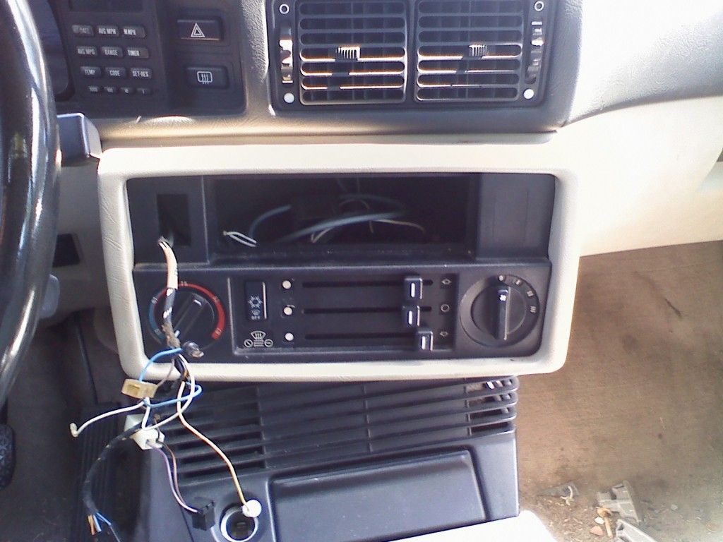

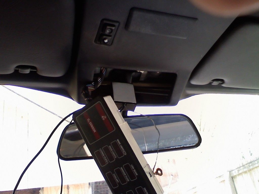

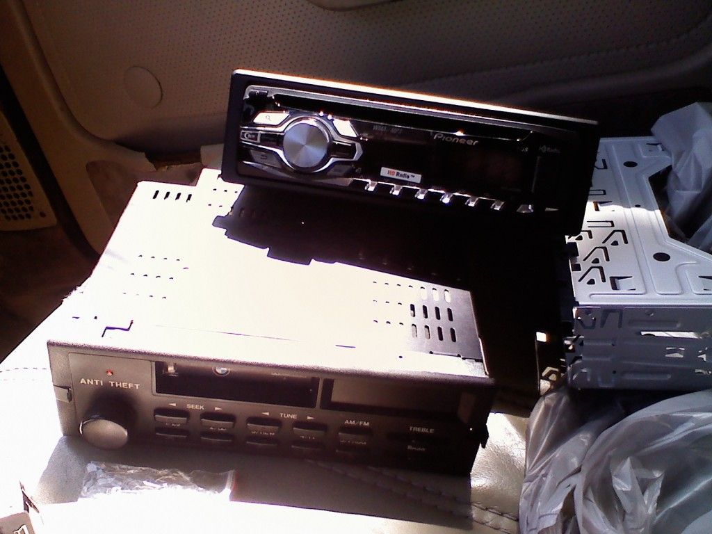

                          • Boring update, but one of my speakers blew and the car would only play Skrillex, so the sound system was in need of an update. Got a nice Pioneer head unit that had lots of nice features, wasn't gaudy, and could color match the gauges to power Boston Acoustic components up front and 3-way 6x9's in the rear. The head unit does HD radio, and since I'm doing bodywork, I figured I'd go ahead and shave the antenna and mount a stealthy power amplified antenna up by the rear view mirror.
                            Wiring for these car's sound is really gay, so it took just about all day to put in the head unit. Speakers today.
