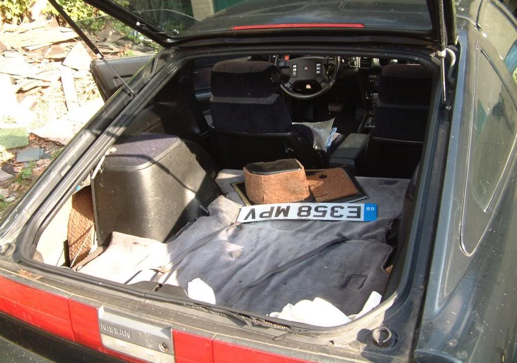

    this is how it was bought

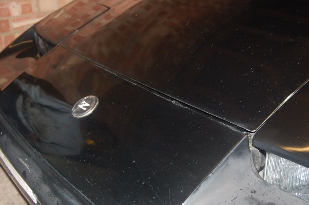

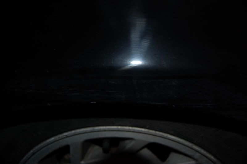

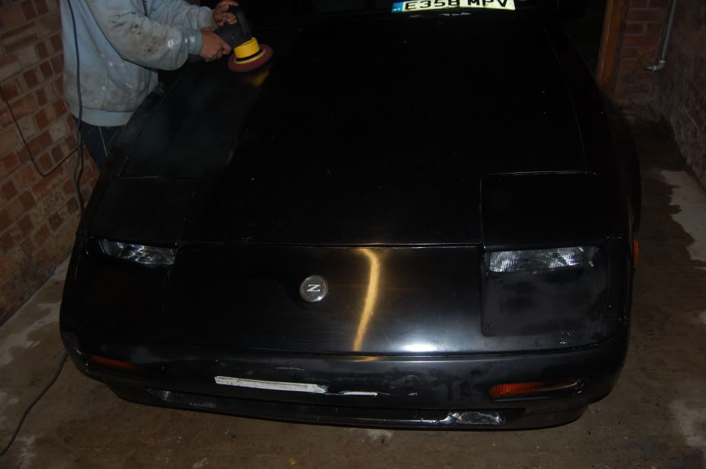

    Mate came down with his handy polishing gear to spark up the beast, as seen in earlier pics paint is battered
    first order was to see if we can revive the paint so I can prioritise on where to be spending the cash on the car

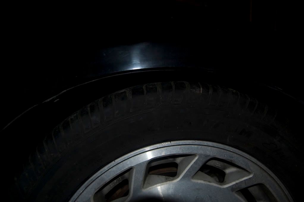

    Paint has come out well, car looks ok 10-15 feet away lol, the bumper and bonnet can defo do with a respray, other than that all the other body panels were straight and cool with no major fade

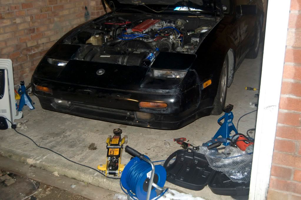

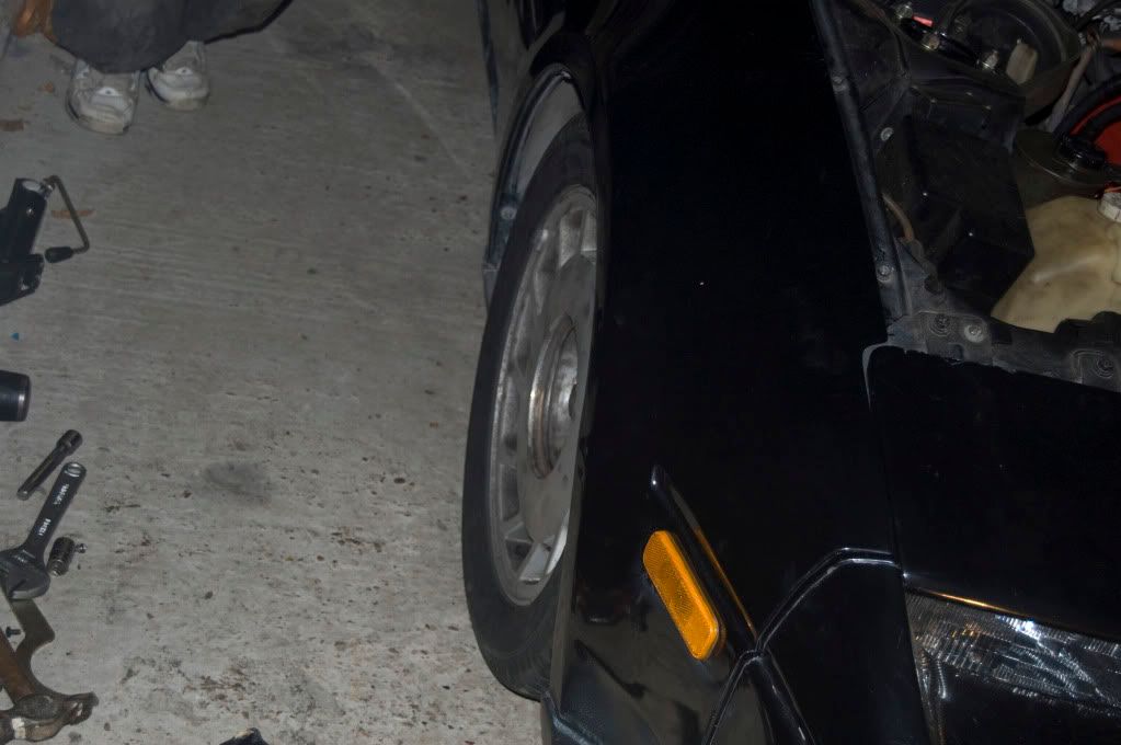

    finally after on and off working on the car for a few days, removed the struts which were a mission!! <_<
    they are finally off using all kinda sh*t and home made 17mm 30" spanner :lol:

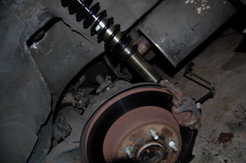

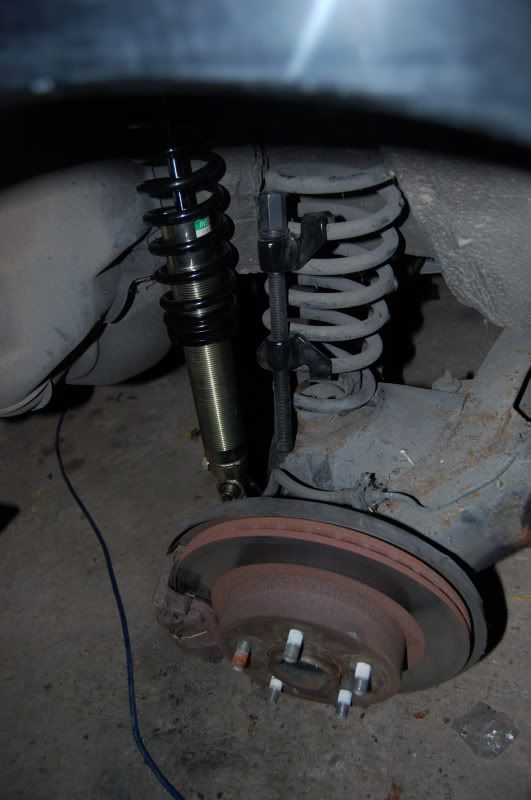

    rear system is a bit different, its a semi-trailarm(sumat like that), so means the damper and springs are seperate, but when the coilover goes on, the original divorced spring will be removed.
    anyways pics as follows, my mate Adam workin on the car whilst I took pics........ and supervised :lol: :
    laptop isnt there for some re-map lol, reading through internet tutorial guide
    and I must say all thanks to my home made 17mm spanner stuck inside a 30" adjustable hoover pipe :lol:

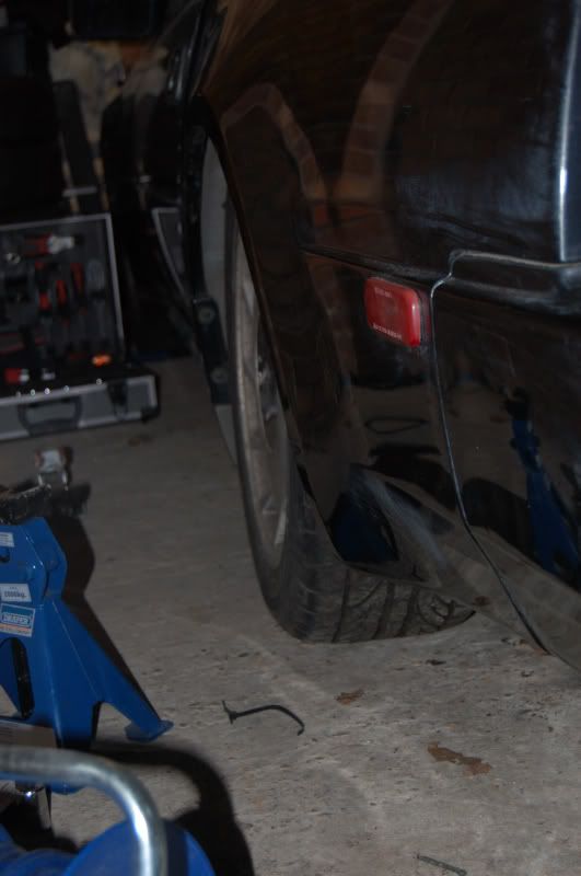

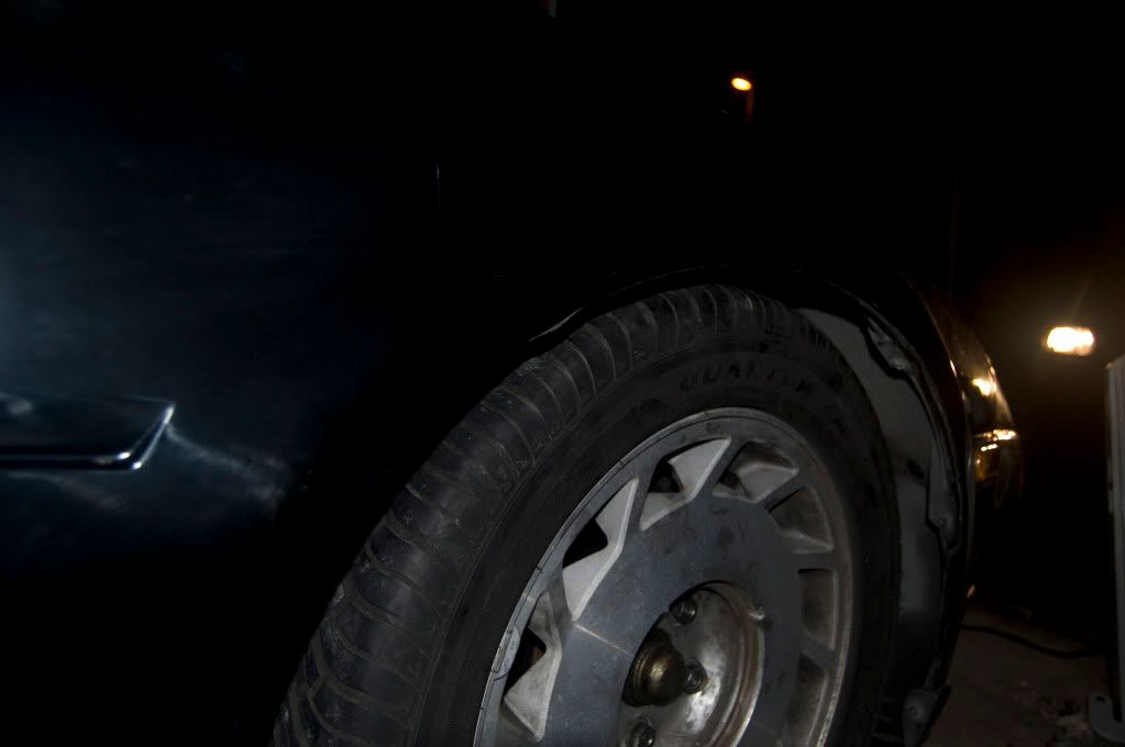

        however there is major wheel to suspension foulage, spacer time!

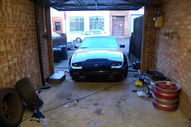

          did some more work on Xmas Day

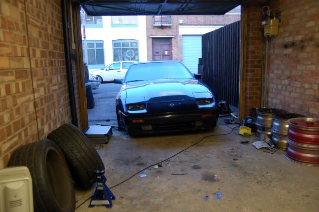

          painfully drove the car out the garage with major coilies to wheel foulage so I can start work on the rear

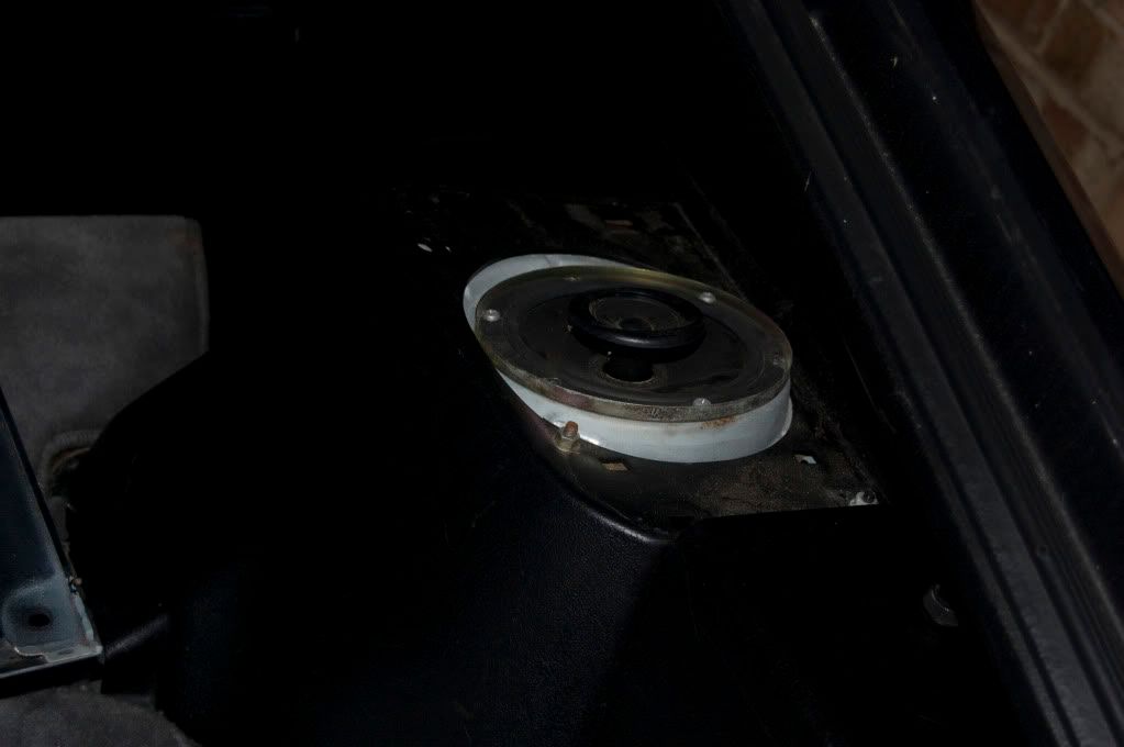

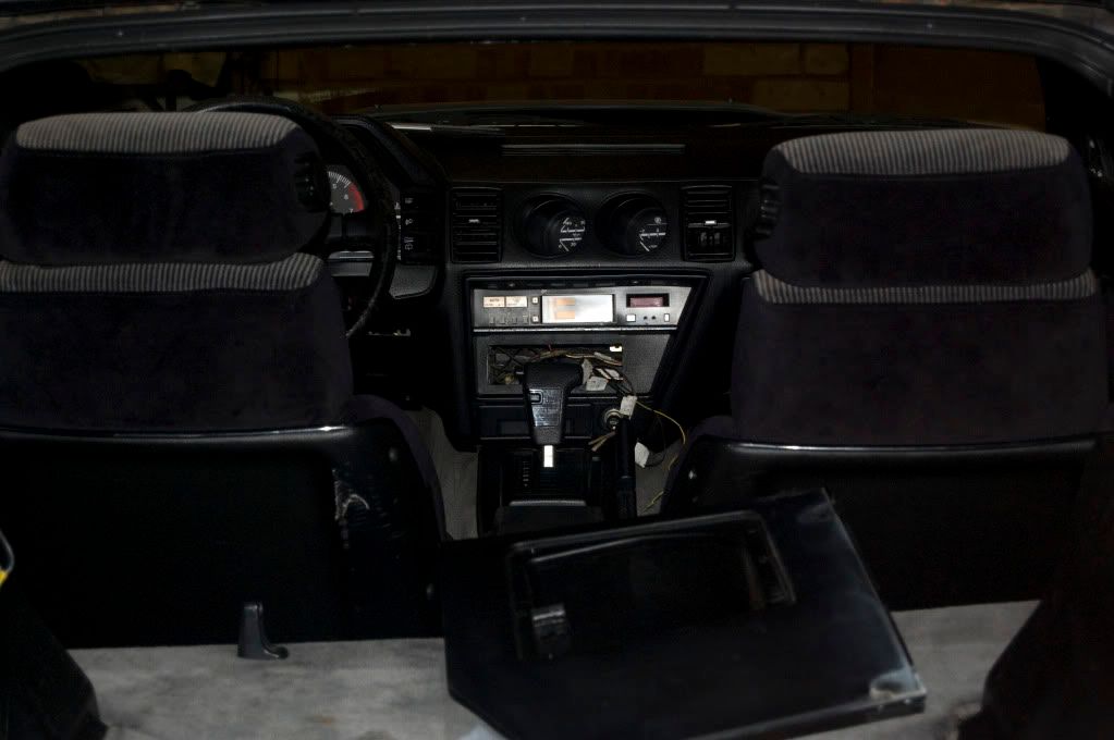

          removed the speaker cover and speakers and cracking on the top mounts, but its very fiddly! need one of those bendy extension things or cut the speaker mounts(I iz avoiding to do that)

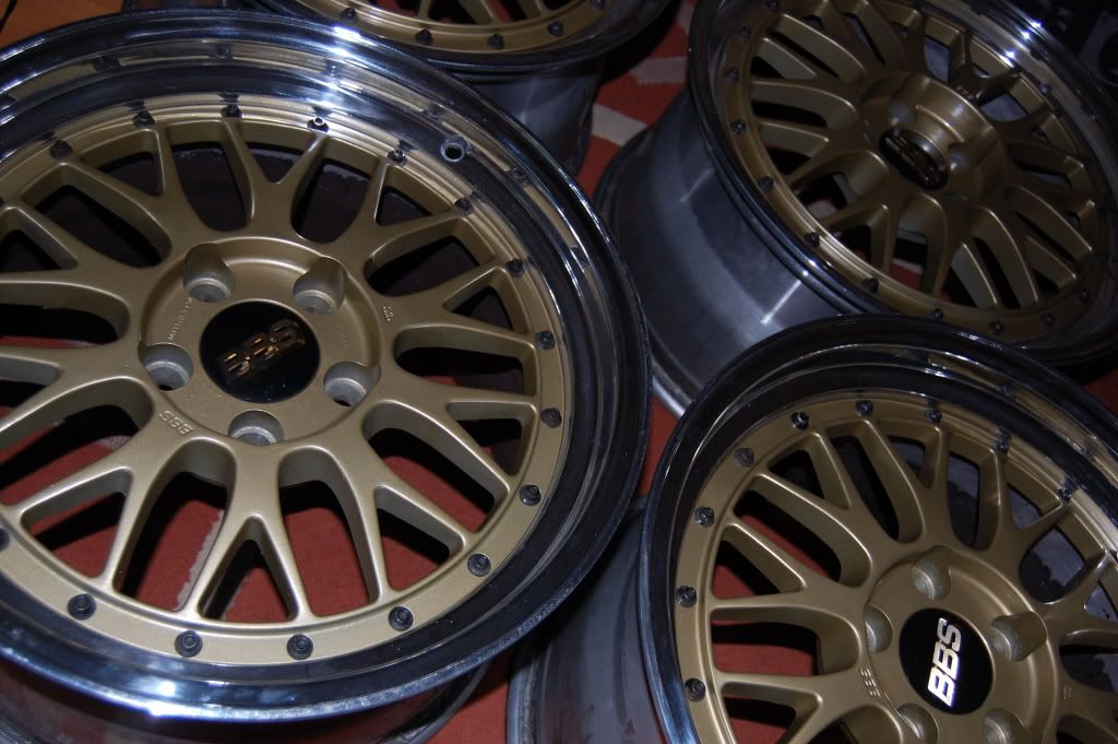

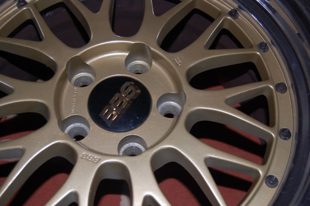

            Genuine BBS LM's - 17x10j rears and 17x9j fronts

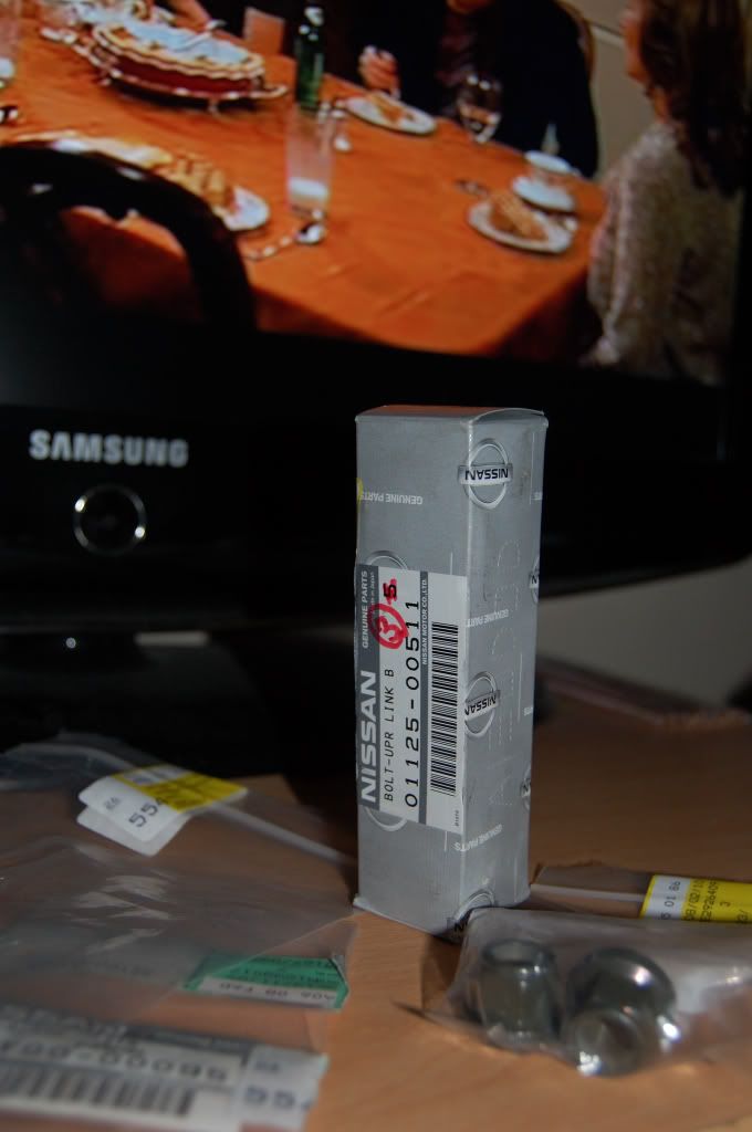

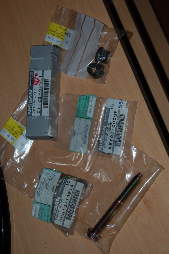

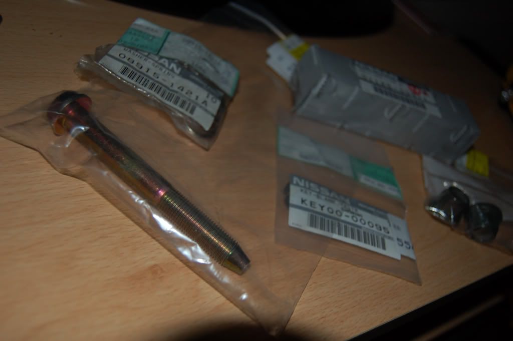

              believe it or not these nuts and bolts accumilate upto like £50 <_<

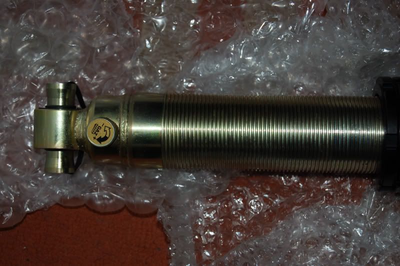

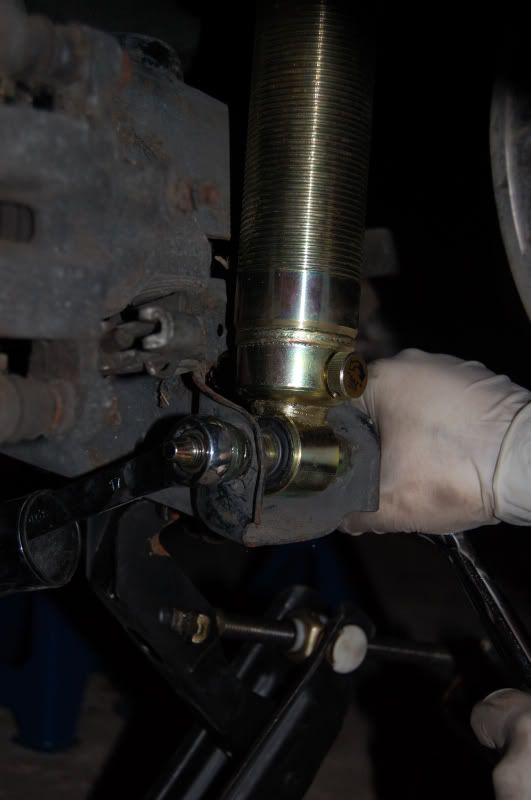

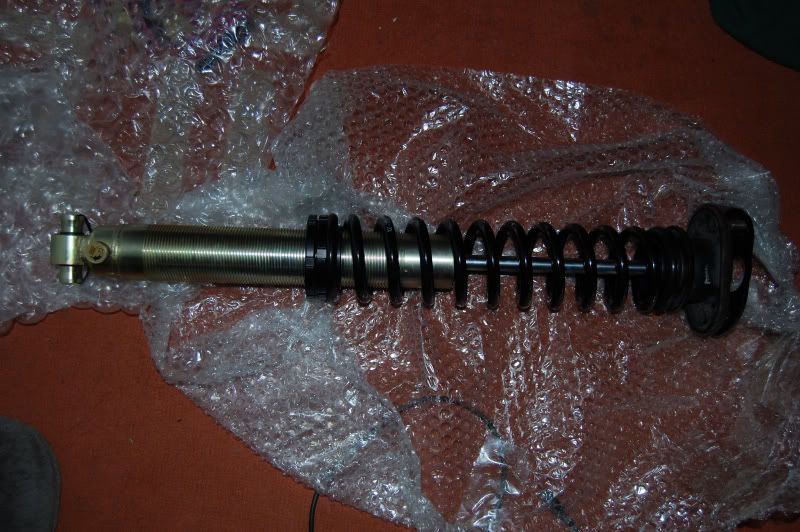

                Gaz ftw! they custom made the rear coilies for me, along with building the whole coilover they refurbed the top mounts, everything else they used was brand new parts. and as you can notice the they have rebound adjustment which means they made me these Gold Class ones for no extra cost, this is KW terrority with one-off custom jobby, I gotsta love 'em :wub: bless 'em they even put brand new bushes and I never even asked for that :wub: ^_^
                  sooooo.......... I had a productive day today
                  got my mate Adam over and thought we fit the rear coilies on the Z using all the nice shiny bitzzz
                  started with bolting the coilover in place and start removing the original spring

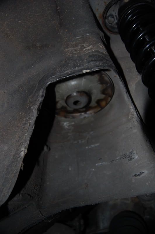

                  Semi-trailing arm to a Semi-Independant arm conversion
                  spring is out, this spot is never to be used, unless converting back to stock... which I doubt
                  new shiny sh*t
                  Result

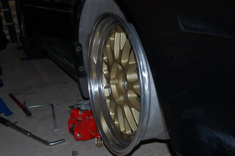

                    wheels have been bored out - centerbore was too small
                    trial fittingz took place today with Haris(that gay jap car *****)

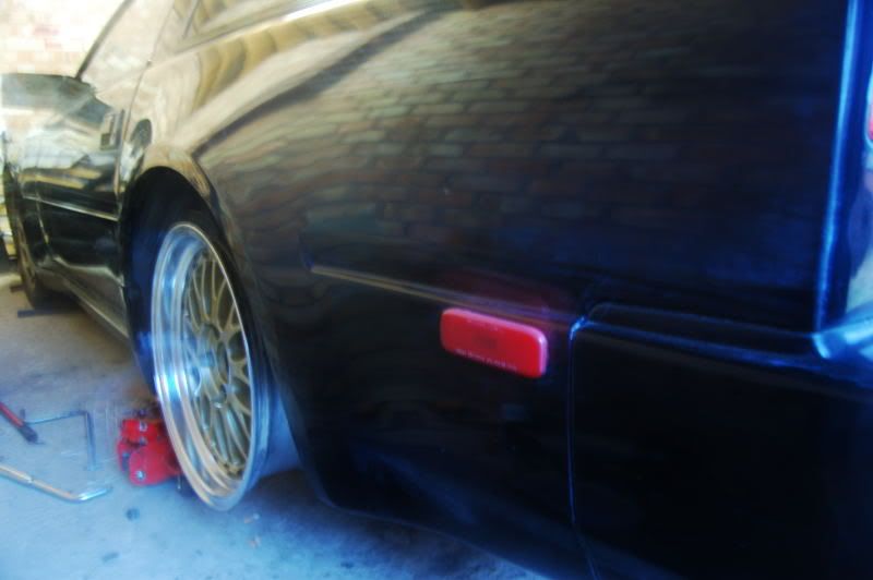

                    my calculations sucked before, I can actually run 12j's in reality :lol:
                    to have the wheels flush against the arch I need like 35mm spacers

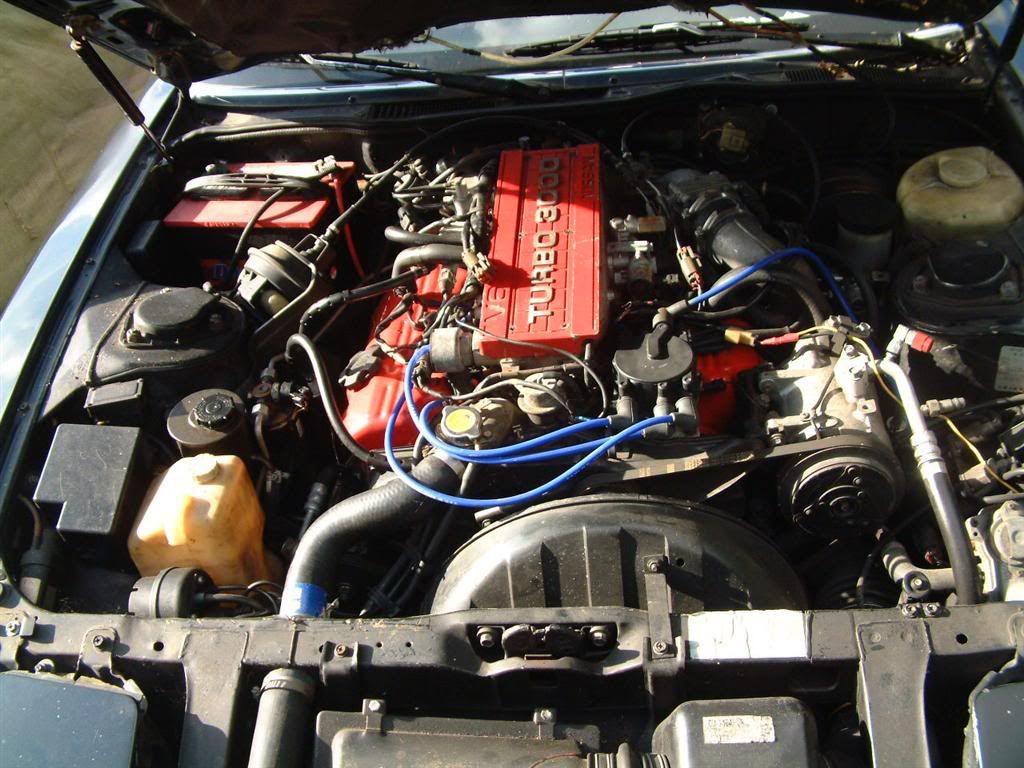

                      did some work yesterday on the Z, test fittingz and to see if everything was mechanically sound, so let it run for a bit too to makesure it doesnt overheat etc etc, and I was surprised everything was working like a new car :lol: just means I gotta get my wheels etc etc sorted and insure the beast as its MOT'd and Taxed anyway
                        so far this is how it looks, also needs a bit more cosmetic touches, I will update with tha shortly.
