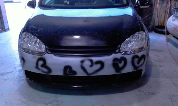

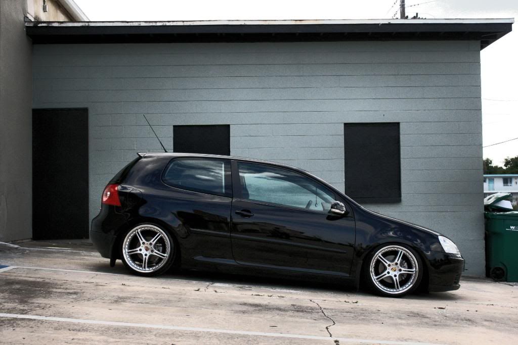

    hey guys, wile still waiting on more miata stuff to show up. the lady and i decided to give her car a face-lift, shaved bump strips, and a h.o.k. paint job. here is some pics. and a little how to.

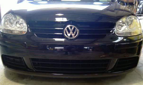

    hers what she looked like:

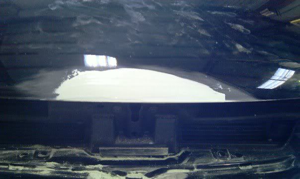

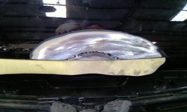

    first thing is first: euro grill/ emblem delete.

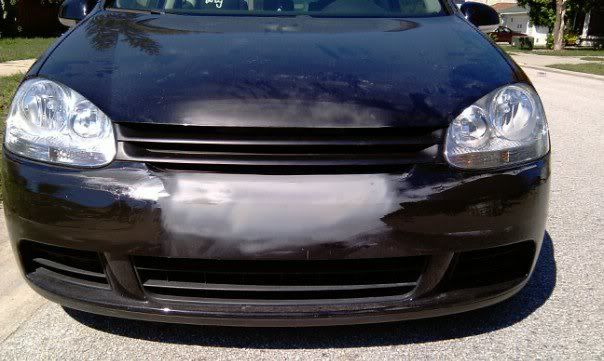

    i made a template on 20aug. steel, cut it out and welded it in solid. ground it down.

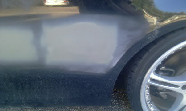

    wiped it with an evercoat hard filler, blocked it and primed it. ppg k38
    next i filled the half moon on the bumper with a smc hard filler after roughing it up with 80grit roll-lock on a right angle grinder. more pics of that later.

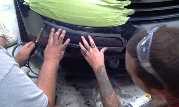

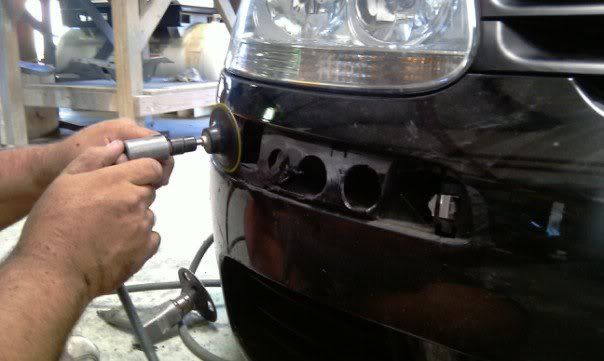

    next: smoothie bumper!

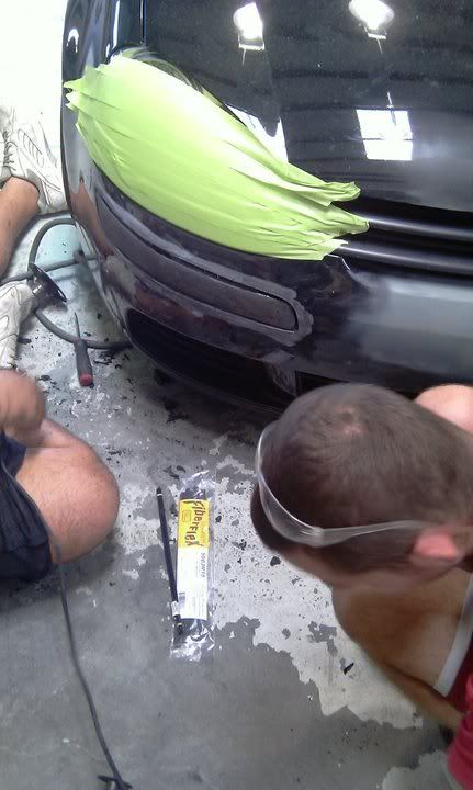

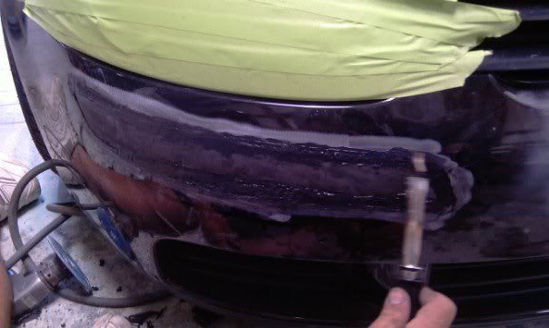

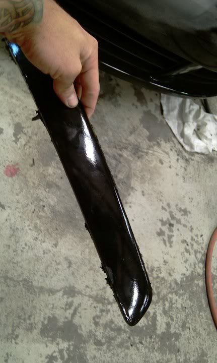

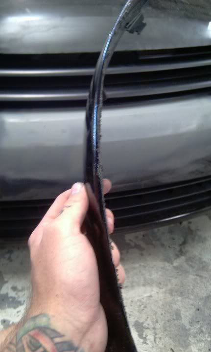

    for this i (with the help of a buddy) took the front bump strips off and cut them flat and ground the webbing out of the bumper.
    we stuck the pices in the holes and trimmed until it sat flush.

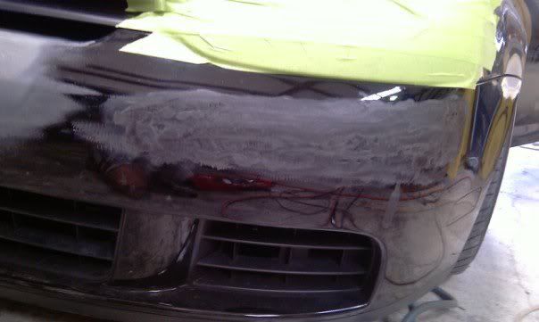

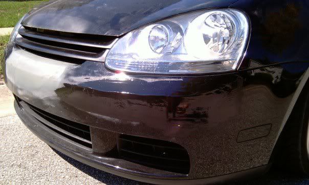

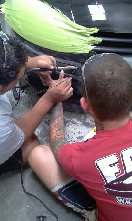

    then we busted out the plastic welder, with the polypropylene rods and welded it up
    after welded up, i ground it down and filled it with smc.
    heres the bumper now. will shape and bodywork on monday.

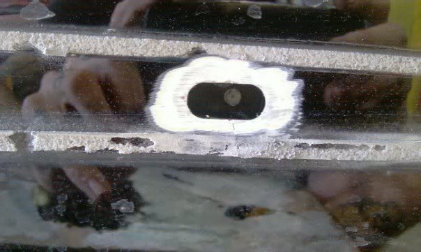

    next: side bump-strip smooth...

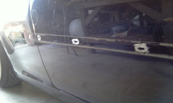

    i dont have many pics for this. but i removed the bump-strips. ground each hole and counter sunk the hole. cut small thin pieces of metal out and slid them in the holes, held them with magnets. glued them in with panel bond adhesive (300 time stronger than a metal weld) without the warping. let them dry for 24hrs. sanded them down and put a light coat of epoxy primer on them. will continue bodywork on monday...
      also removed the two sided tape...

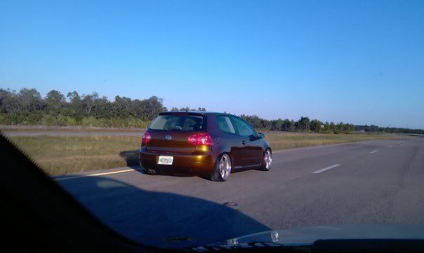

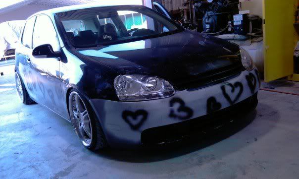

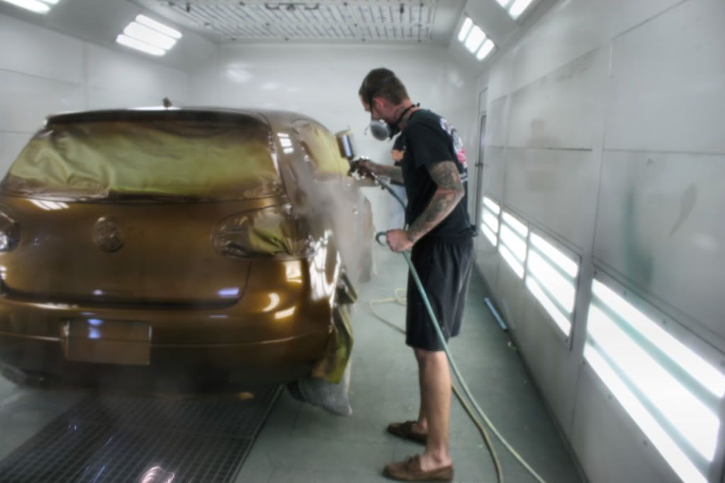

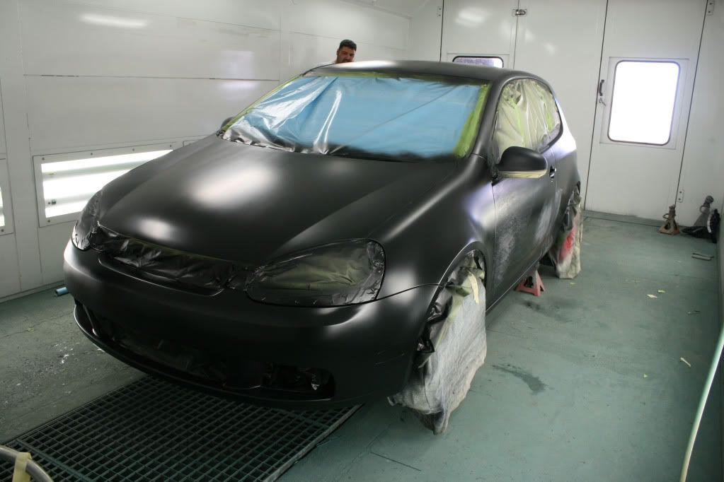

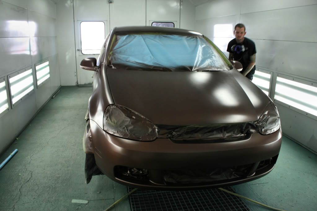

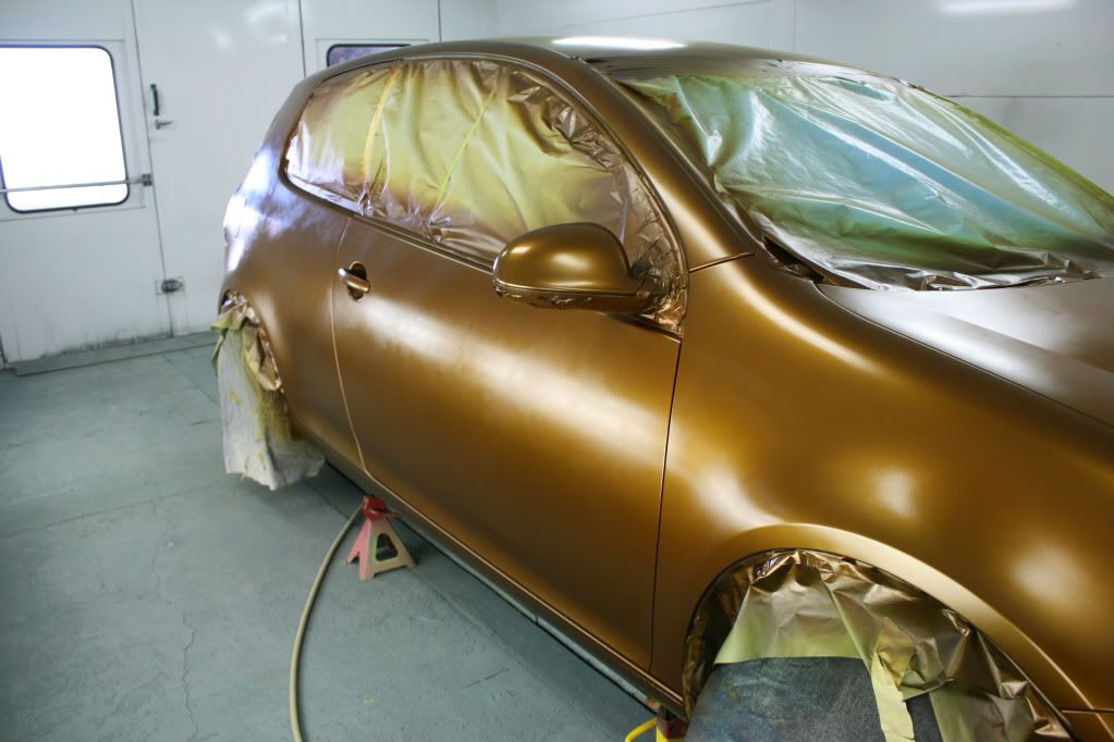

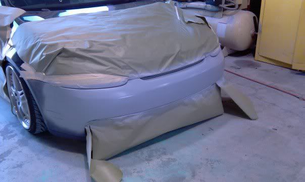

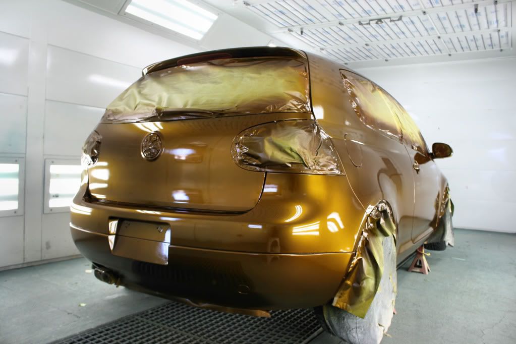

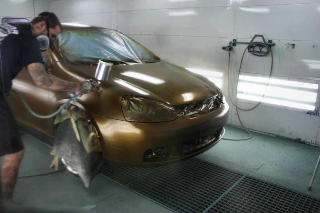

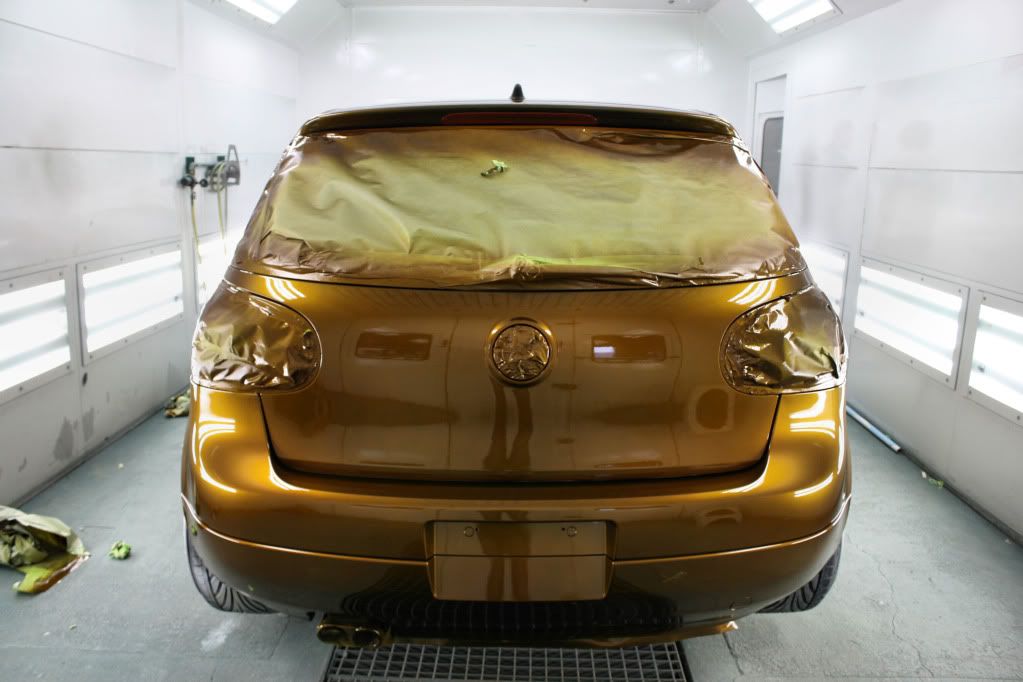

                  ok guys update over the past week. i finished the body work, got her in primer. prepped it friday, and painted it Saturday. untaped it sunday and took it to lollicup. heres the pics.

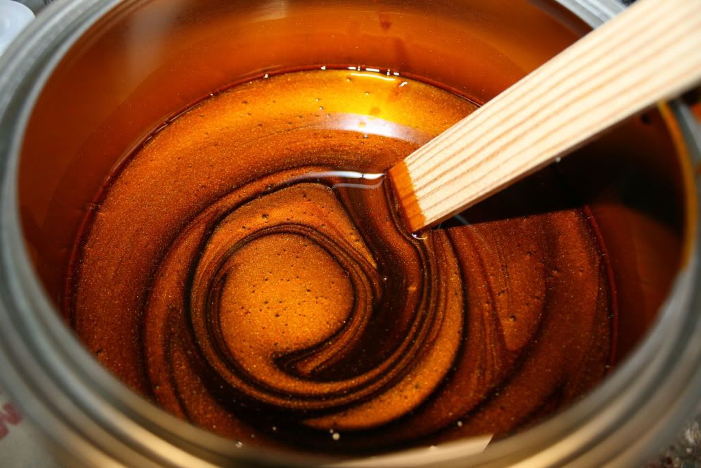

                  i sealed the car with black epoxy, then based it in brown. and sprayed four coats of gold kandy over it and cleared it with h.o.k.kosmic klear.

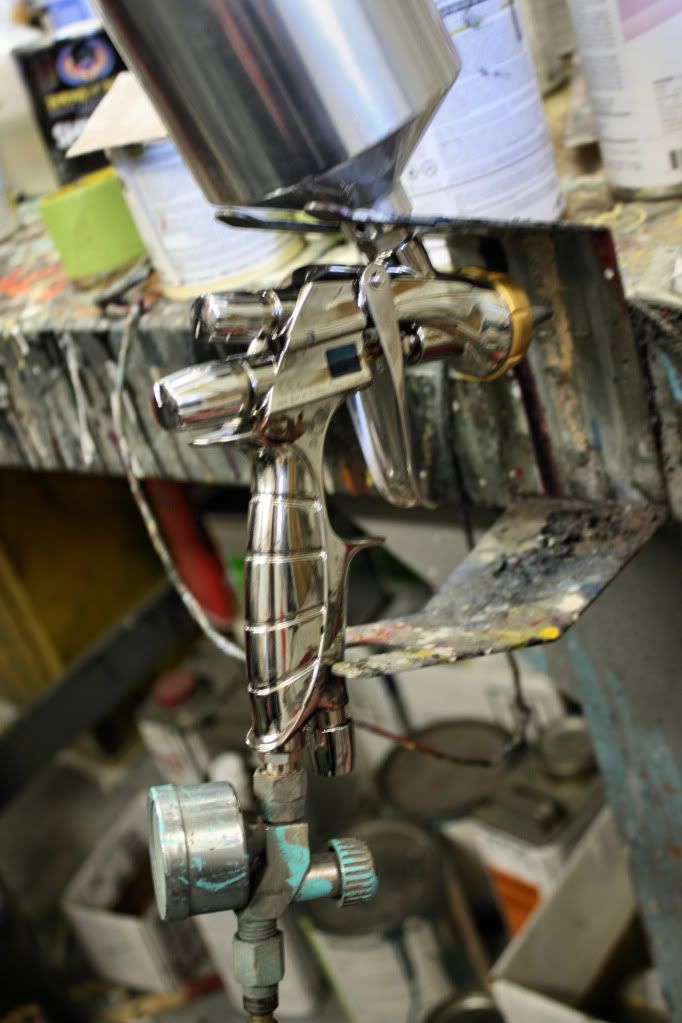

                  iwata suernova. mack fuckin daddy!
