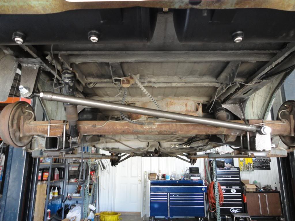

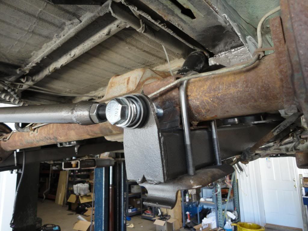

            what setup do you have in the rear of the mk1? a friend of mine is bagging her caddy and would love to be that low out back.

              Thanks!
              We built a two link with a panhard bar. I think we used ss5's or 6 cant remember for sure. Its been awhile.

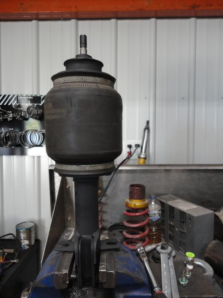

              than this is what we did for the fronts. These are axed infavor of airlift builders and widened raised towers.
              Its not possible for me to go any lower in the rear without some serious cutting the axle is resting on the body. With no weight in the back, 15x6 w 165 45 15's it will actually still roll around aired out. Been pushing it around that way lately while we do the towers and motor swap.
