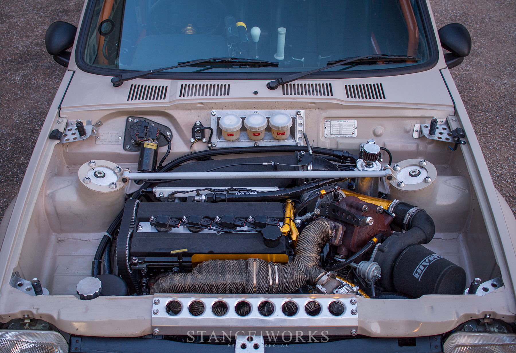

Fitting the 2-liter Zetec engine into the tiny engine bay of the Ford is a feat in and of itself. “You can get engine in there however, everything touches or needs cutting about, or notching or even persuading with a hammer to get it squeezed in the hole,” Mike explains. Thus, you can imagine the complications of adding in a compound twin-turbo system from a MAN diesel truck. A glance inside the car, of all places, is what really gives way to the constraints Mike faced. “I really wanted to avoid any intercoolers or radiators hanging out the front panel,” he clarifies. So, he did what any rational person would do and put the charge cooler inside the Fiesta. The unique driveline doesn’t end there, though: the car has been converted to a six speed, with a hydraulic clutch conversion to match. Custom-length drive shafts were needed to make the system work with the Fiesta uprights, but the result is a car with heaps of power and an over-abundance of character. Then, of course, there’s the interior. While a charge cooler in the footwell makes or an unusual centerpiece, its complimented by the addition of a 6-point bolt-in roll cage and Cobra seats.
In terms of go-fast parts, the Fiesta has been fitted with more than just a few. The heart of the party on wheels is an Area Six 2.1-liter silvertop Zetec engine, with power sent through a retrofitted 6-speed ST170 gearbox, an AT Speed Racing billet flywheel and clutch package, and a Quaife limited-slip differential. The boost is provided by Borg Warner R2S turbos mounted to a homemade tubular manifold. A Tial wastegate controls the pressure while an Omex 600 ECU makes the whole system work in unison.

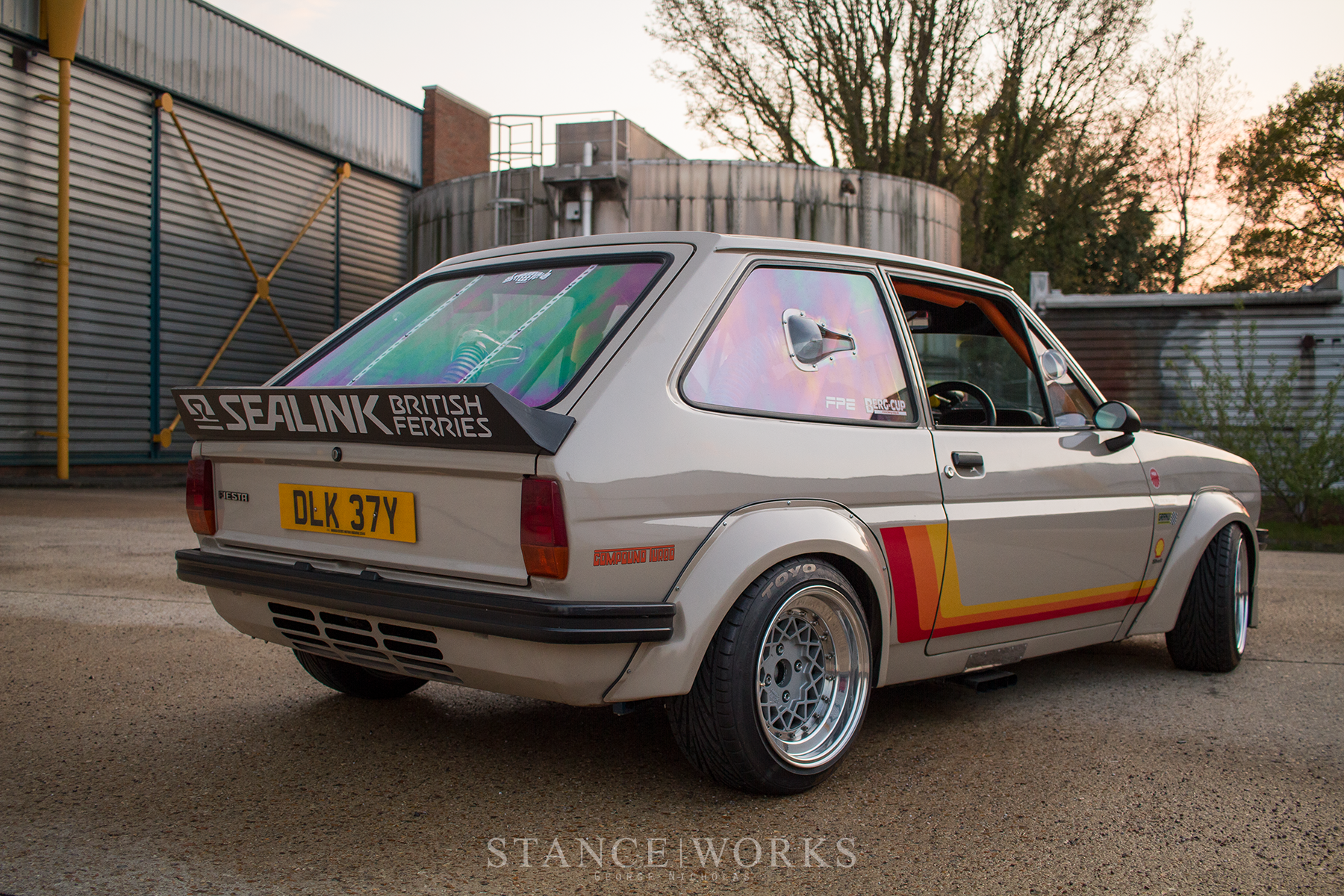

For suspension, the car has been fitted with a complete rose/heim-jointed front end from Kustom Karl Engineering in the United States. GAZ coilovers have been retrofitted to all four corners, with the fronts being modified to accept MK2 Escort adjustable top mounts. The track width up front was extended 2 inches to better fill the wider flares, and a MK2 XR2 steering rack has been installed to account for the changes.
The wide arches come courtesey of Kamei: fiberglass copies of the classic RS rally arches. To fill those arches, Mike sourced a unique set of Graku split wheels that measure out to 14×8 and 14×8.5, and have been wrapped in Toyo Proxes T1Rs. The wheel build comes thanks to Zak at Zewspeed, who lent a hand through much of the Fiesta’s build process. Machining was required to change the offset of the wheels to work for a FWD car, and custom rim halves were made to step the Grakus from 13″ to 14″. The outcome, of course, is phenomenal. Further exterior aesthetic touches include a custom home-made boot spoiler, and stripe/decal work designed and printed by Mike himself. There is of course Mike’s favorite part of the car as well: the boom tube exhaust pipe. In contrast though, he laments about his least favorite aspect of the build… “the boom tube side exit after 2 hours of driving as its obnoxiously loud and my neighbors hate me for it,” he says, in what might be the most relatable complaint ever uttered.
