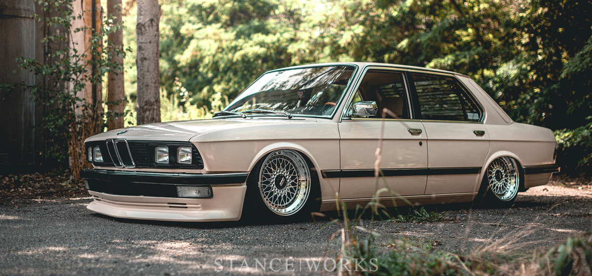

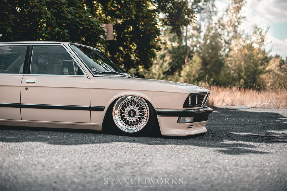

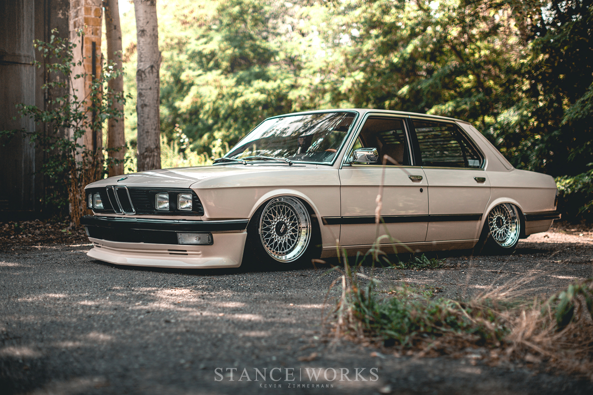

When Kevin bought the car, it was already equipped with aftermarket sporty suspension bits and one-piece AC Schnitzers, but with StanceWorks on his mind, he knew radical changes were in store, and began carefully planning out the E28’s build list. First things first: wheels. Kevin sourced a set of all-original BBS RS 212s in 17×8.5 ET13 square, and refinished them himself. The lips and centers have been polished, with the centers receiving a ceramic coat for protection, and the wheels were reassembled with black hardware and a custom set of conical center nuts. The sizing it spot-on for the E28 chassis, allowing for room to be tucked away under the arches without the need for modification of the body itself.
Following wheels was suspension. Vogtslamn was enlisted to help built a one-off system for the car, which utilizes custom shortened coilovers with air springs and manual management, keeping in line with the car’s simple, no-frills theme in regards to accessories. No electronics, no sensors: just classic manual valve bodies and a few useful pneumatic switches.
Kevin found true enjoyment in the smaller details of the build: “I’m always looking for rare and cool parts to add. This really is the fun for me in building the car,” he says. With so many odd bits and pieces floating around from decades ago, there’s a certain sense of fun found in customizing the car to make it different from the rest.
Kevin first sourced a Zender front lip, paint-matched to the car and given a bit of massaging to straighten the old fiberglass lines that run across the nose of the car from one side to the other. Kevin shaved the front license plate holder, and then sourced a set of clear indicator lenses for all four corners of the car, nixing the amber in favor of something a bit more unique and uncommon on such an old chassis. He plucked the door handles from the car and replaced them with chrome E12 counterparts to match the window trim and the optional factory chrome mirror. The final details: old chrome Mercedes S-Class wiper arms, and body-color matched rocker panels, which frame out the E28’s classic lines and give this car its defining, all-euro all-style aesthetic.
Inside the car, Kevin has fitted a Nardi steering wheel and shift knob, opting to leave everything else alone to preserve its condition. At the interior’s back end, a set of rear window blinds were added, harking to the more-common but too-sporty Auto Plas rear louvers that often fetch hundreds upon hundreds of dollars per set.
This, of course, brings us to the final but most controversial detail on Kevin’s build: the Hofele square headlights. After seeing a set on Scott Saier’s E28, Kevin knew he needed a set for himself, and spent ages tracking down a set. What eventually arrived was what he jokingly refers to as what was the “remains of a set,” and suggests most others likely would have tossed them in the trash. Instead, though, he spent considerable time restoring the parts for their on-car debut. The outcome is undoubtedly one of the most unique changes that can be made to the E28’s overall aesthetic, and Kevin couldn’t be happier.
