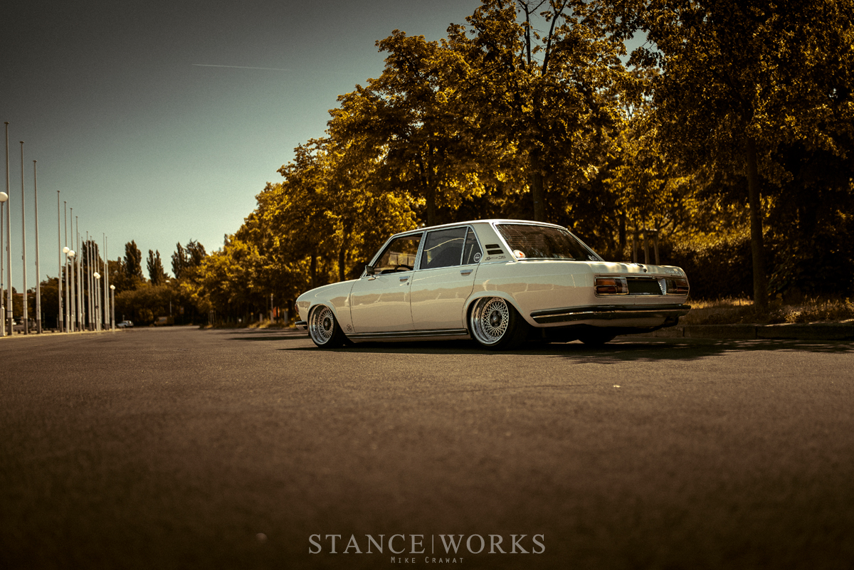

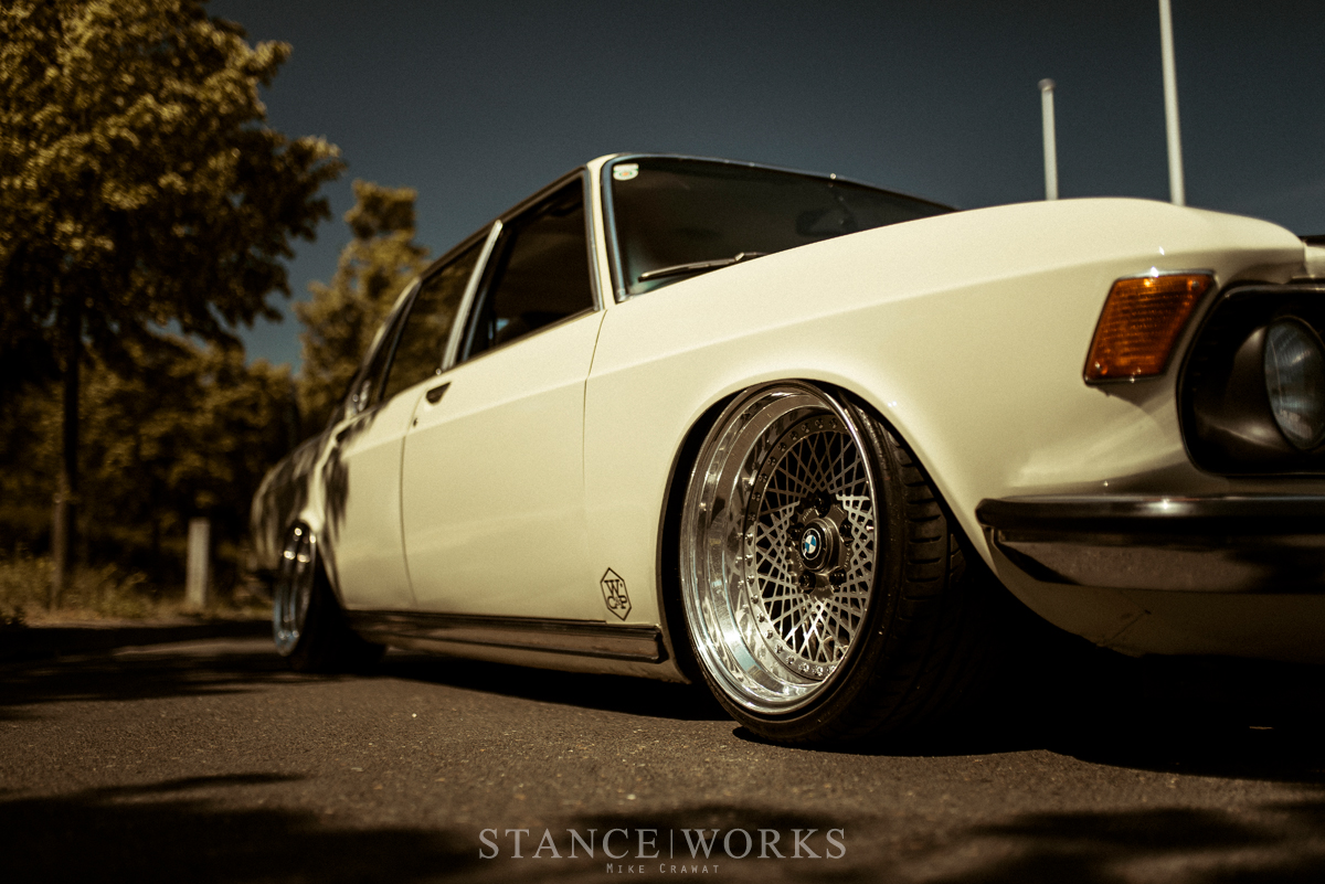

The E3 is, quite clearly, a predecessor to the 5 and 7 series. It was born as a well-trimmed grand-touring sedan, and sports an early take of the now-iconic quad round headlamps. Its pointed nose is reminiscent of the “shark nosed” styling that was popularized in later years, and if you squint, it’s clearly a sibling to the E9 and its race car counterparts. It makes for a wonderful platform, but as this particular example was offered with, a 2.8-liter 6 cylinder motor is far from enough.
WCP turn to the E36 platform for an engine, utilizing the M50 for its ability to handle boost and turn out good numbers. Paired with a GTX30/76 turbo, the old girl now spins the tires through third gear, pumping out an impressive 480 horsepower at the rear wheels.

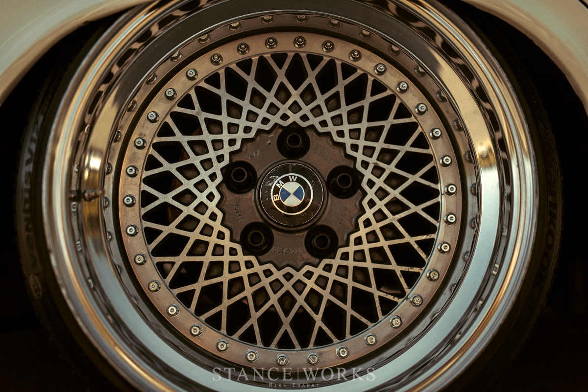

The power is put to the ground through a one-off set of wheels. As is growing in popularity, especially in Europe, a set of 15×7 King wheels were machined and split, and have now been paired with custom wheel halves, making them the only 3-piece set on the planet. The choice was a good one too, with the centers looking like something out of an old BBS or Compomotive catalogue at a fraction of the cost and in a sense, considerably more rare. Measuring out to 17×8.25 in the front and 17×11 in the rear, there’s a considerable stagger between them, with the rear width needed to keep the oldtimer from getting too squirrelly.
