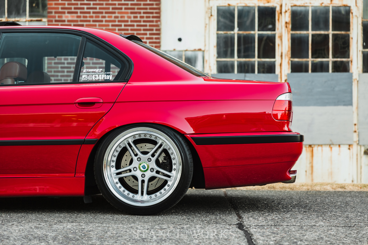

The final part of the build entailed the wheels. “I got really lucky with the wheels,” Scott recalls. “A friend of mine posted a picture of his E60 on Facebook sporting Racing Dynamics wheels, and I joked, telling him to sell them to me.” As luck would have it, his friend replied, letting him know that Mark Perrault had one new-old stock set of RS2 centers remaining. Scott sized out the desired lips and barrels, and left Mark to build the custom set specifically for the 7. The final dimensions measure out to 19×10 et10 and 19×12 et20, wrapped in 255s and 305s, respectively: a well-fitting package that blends aesthetics and performance.
