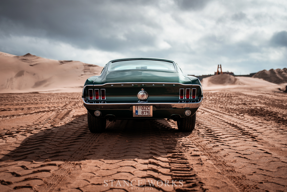

The Bullitt mustang clearly served as a source of inspiration, but the final outcome was never intended to be a clone. Fittingly, though, the car still sports its original Dark Moss Green metallic paint, although completely resprayed as part of the restoration process. All new chrome trimmings were installed to finish out the exterior.
