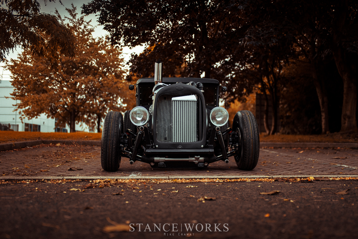

“The Marauder,” he calls it. It’s pretty obvious why, too. Clad in black, and only black, with a turbo perched atop the massive 1,100lb 5.9-liter Cummins 6BT turbo diesel, it’s menacing to say the least. Black smoke billows from its teardrop stack, and an intercooler sits perched behind what used to be a front grille. The Marauder exudes an air of intimidation, and does a hell of a job showing its fellow countrymen, and all of Europe for that matter, what a hot rod can be.

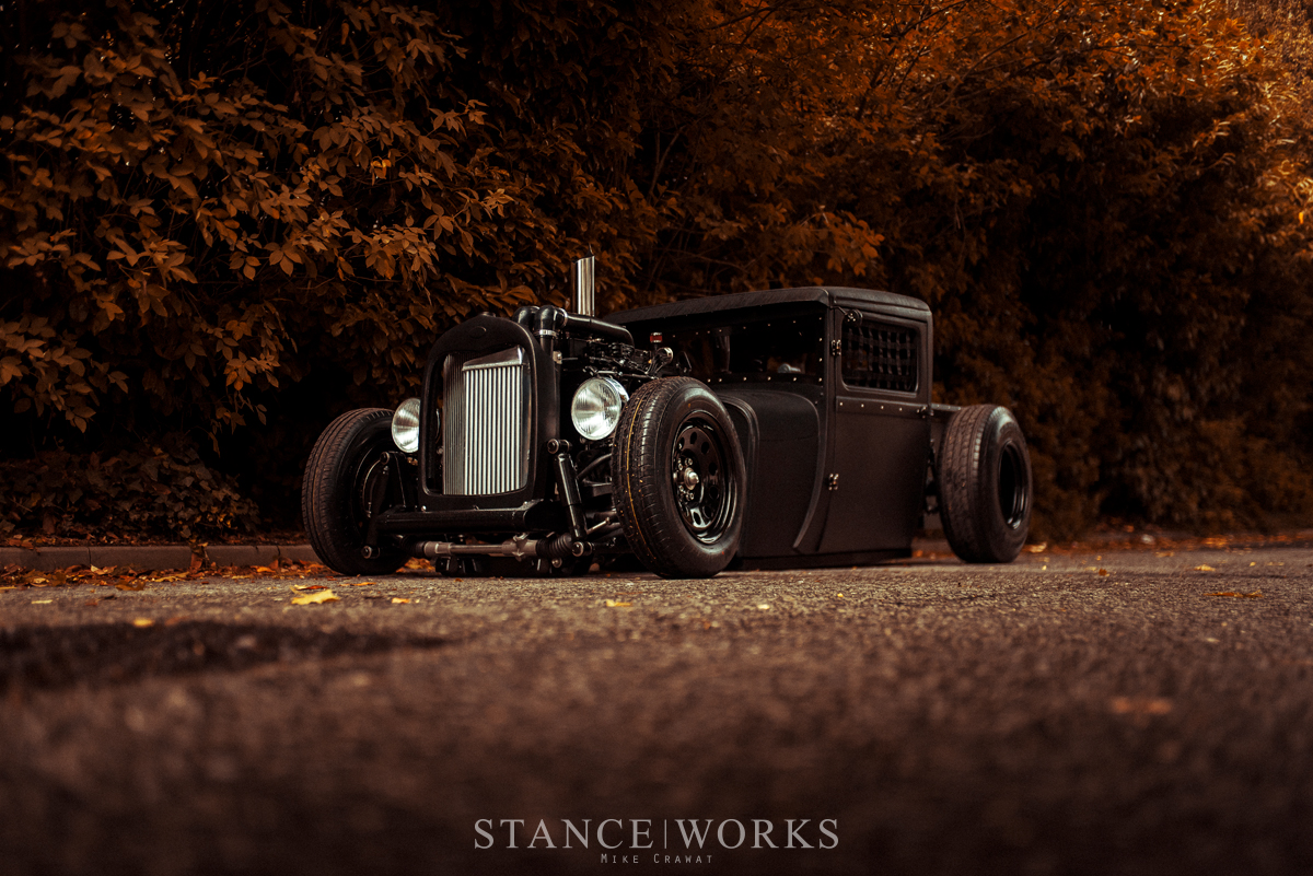

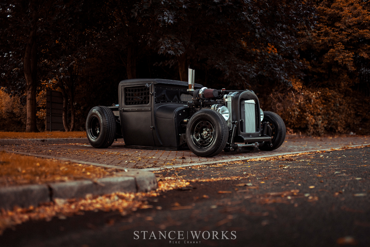

Starting with the obvious, the truck was built around the world-famous 5.9-liter 6BT Cummins Diesel. Known as a “million mile motor,” its one of the all-time greats in the world of diesels. Upgraded with a high performance fuel pin and a 3200RPM governor spring, the massive motor pumps out… 200 horsepower. But that’s not what counts. What does is the earth-turning 600lb-feet of torque, enough to make this classic Ford more than fast enough. The engine has received a slew of new parts, and was restored and refinished at the hands of Hands himself. With the engine sitting proud on the truck’s chassis, it needed to look the part too, and received plenty of fresh black powdercoat and hand-polished parts. If you’re wondering what battery to choose for diesel truck? Check out this site.

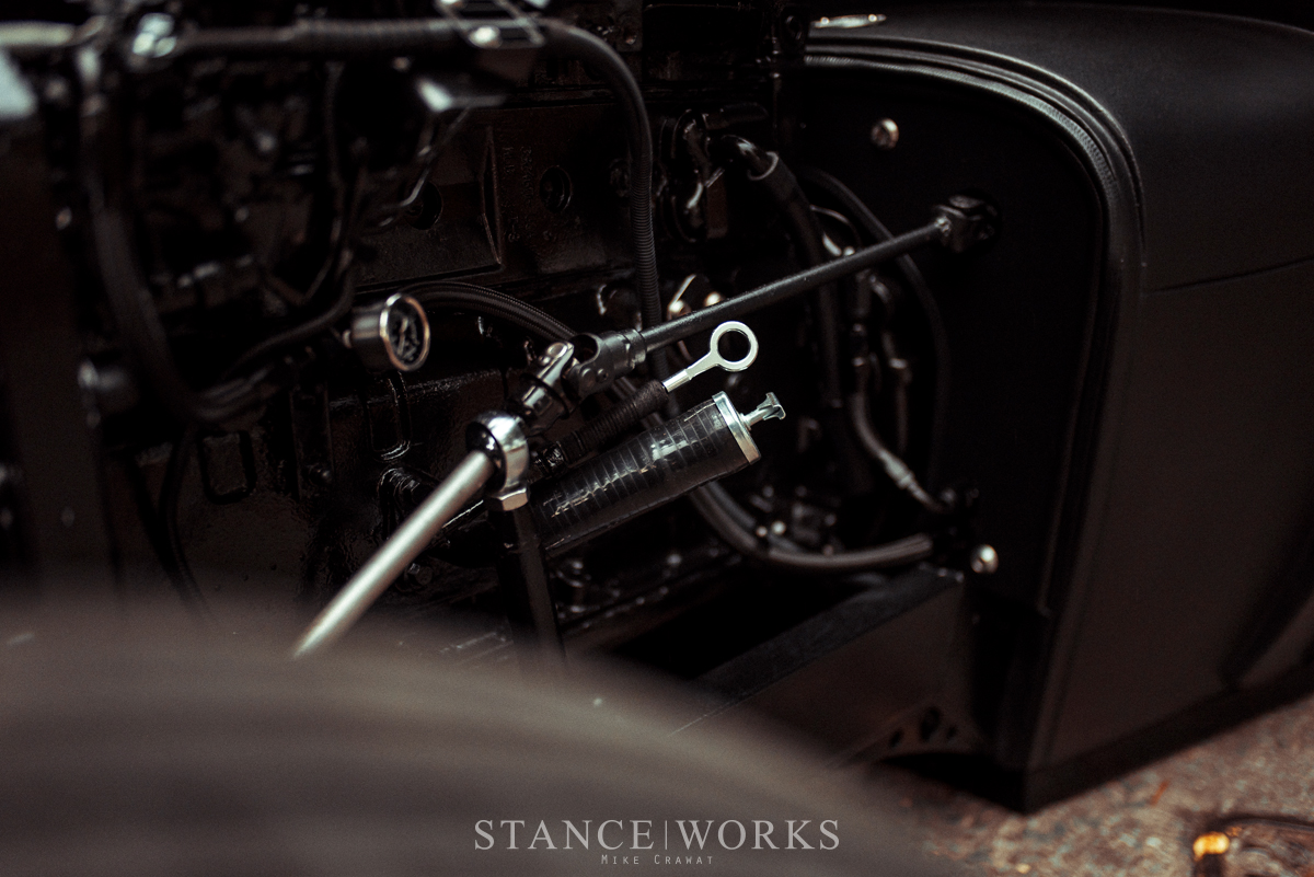

The chassis that supports the enormous inline six is a beautifully built custom piece. With CAD-designed and laser-cut bracketry used throughout, its fit and finish is as nice as they come. For suspension, the front end utilizes a newer Mustang independent front end, modified for use with air bags. Out back is a 31-spline Mustang 8.8, with welded tubes and an LSD, located with a 4-link drag setup and a panhard bar. Being on air bags, the truck is able to lay flat on the tarmac, and when time to drive, everything is controlled thanks to Air Lift Performance’s 3P management and an iPad for control, mounted to the dashboard.
