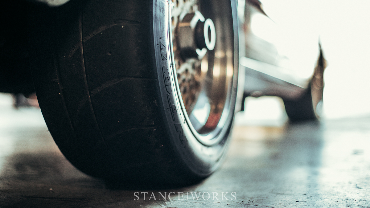

There’s a lot that goes into the science of tires. From snow tires and all-seasons to summer tires and ultra-high-performance rubber, tread patterns and tire compounds can yield a myriad of options, each serving a unique purpose. For the layman, that’s more than enough, but for enthusiasts, tires go a step further, with drag radials, r-comps, and slicks icing the cake. The Nitto tire lineup runs the gamut, and thus I turned to their NT01: their DOT-compliant road-course competition tire. With a 100 treadwear rating, it’s not built to last… instead, it’s meant for all-out performance, and its a tire renowned for its performance potential versus cost, meaning it leads the competition for almost anyone who asks.
I know there’s a bit of technical jargon in there, so if you’re scratching your head, here’s the meat and potatoes: most street tires share similar compositions – the chemical and physical elements that comprise them – and while some street tires vastly outperform others, they all tend to share basic similarities. R-comps, or race compound tires, kick things up a serious notch. With treadwear ratings from 0-100, they forego every expectation of treadlife in favor of maximum grip on dry asphalt. In comparison, a standard commuter all-season tire might sport a treadwear rating of 600 or more. They differ from true racing slicks in that they are road legal, with DOT-approved tread patterns. R-comps like the NT01 and others represent the upper echelon of performance for street-legal tires.
The jump from street tire to r-comp is considerable, and while tire life and audible feedback both go out the window, performance skyrockets. With a quality r-comp, there’s no doubt you’ll be able to make your car dance around the track like never before. It’s worth noting they’re a mess, too: after a few sessions, you’ll find black rubber boogers slung all over your car. Wear them like a badge of honor, though.

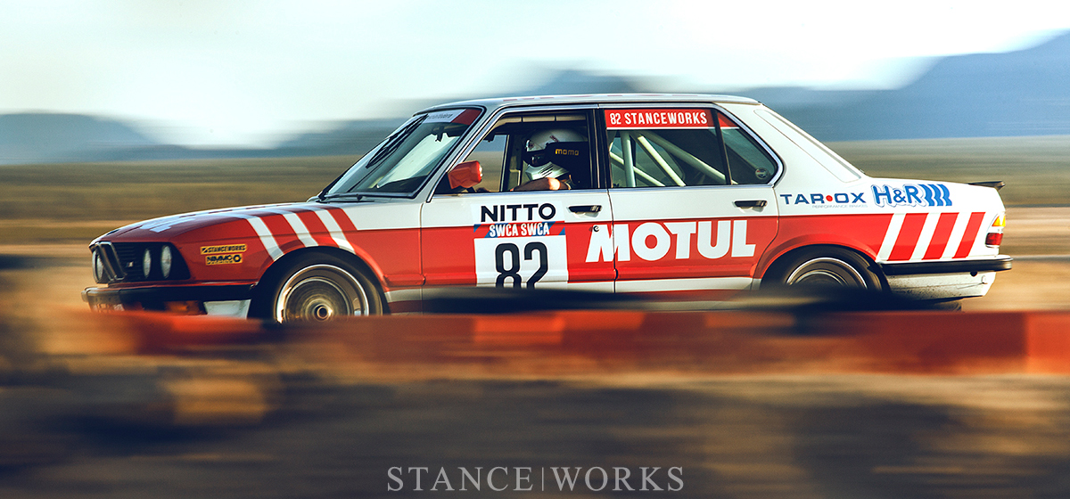

After driving on a handful of r-comp tires, it’s easy to see why the NT01 is a class favorite. Sporting a new set of 245/45s, up from the 225/45s of last season, the “Parts Car” is quicker than ever before. A few sessions at Buttonwillow’s 13CW layout helped to find a second and a half with the increase in size, which the car was begging for.  StanceWorks friend and family member, Cory Hutchison, ran Achilles ATR K-sports and NT01s back-to-back this weekend, and after finding two seconds per lap at Chuckwalla Valley Raceway, it’s safe to say he was raving about the Nittos. Federal RSRs were no match either.
