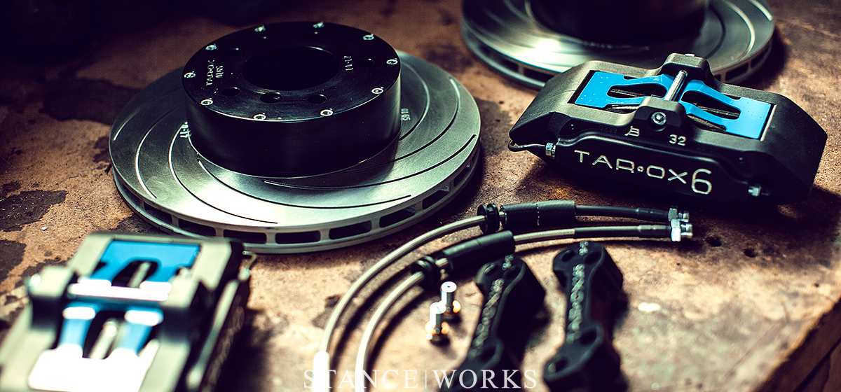

Arriving in beautiful blue boxes from Italy, Tarox sent over what we deemed best for the build. Up front, I’d be fitting a set of their B32 6-piston forged calipers, and with them a set of 310x26mm F2000 rotors and Tarox Corsa street/track brake pads. While Tarox does offer a bigger option, we chose the KMBM0165 kit for the sake of ensuring the system will clear period-correct 16″ wheels, should I chose to run them. If you suspect that your brakes also have some issue, it’s advisable to seek a professional who can do services like car brake repair.
As a direct bolt-on kit, the package from Tarox included everything needed for the install, including the necessary brackets, hardware, and braided brake lines. The calipers themselves are forged, hand-assembled 6-piston units, which are directly derived from the very kit that Tarox launched their “big brake” program with for the E30 M3. The rotors for the kit are built in a two-piece configuration, and are of course, directional for the left and right sides of the car.
