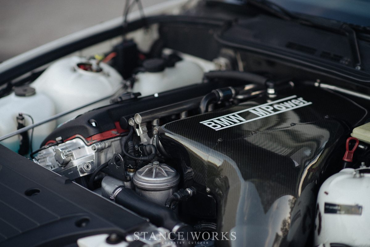

It was the team at Edge Motorworks that helped to shape Shafique’s emphatic attitude for the track, but it was Castro Motorsport that pushed him to the deep end, towards the holy grail of BMW inline sixes: the S54. Shafique shipped the car to SoCal for the swap, letting the Castro team work their magic. However, with the car hundreds of miles away, and with nothing to tinker with, his aspirations for the car grew.
When the car was finally returned to him, Shafique wasted no time sending the car off to Performance Technic, to handle yet another round of upgrades – this time, Shafique sought to replace everything else on the car, all with the best components possible.

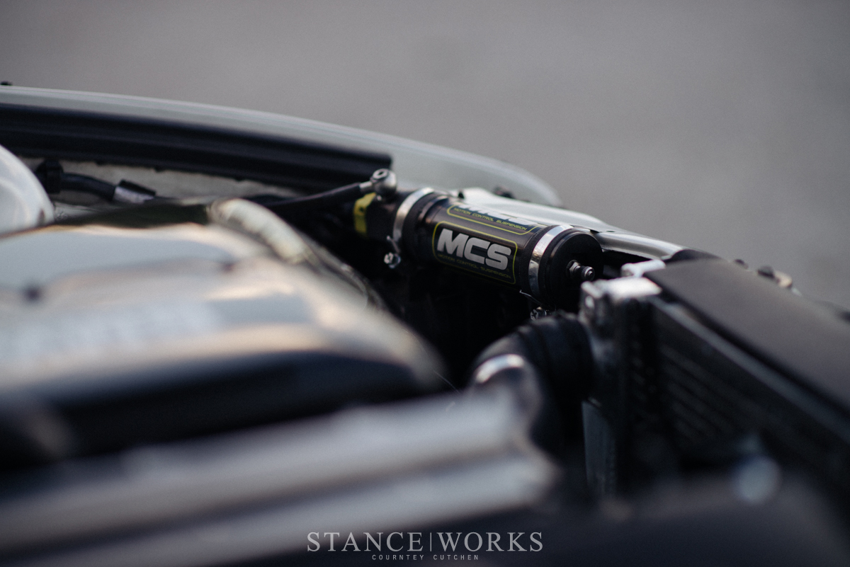

Under the hood, the S54 retains its stock internals, with air pumped in through a Bimmerworld carbon airbox, and out through Epic Motorsport race headers and a Performance Technic 3.5″ exhaust. An RKTuned Alpha N setup boasts a rather serious 341whp on 91 octane fuel.

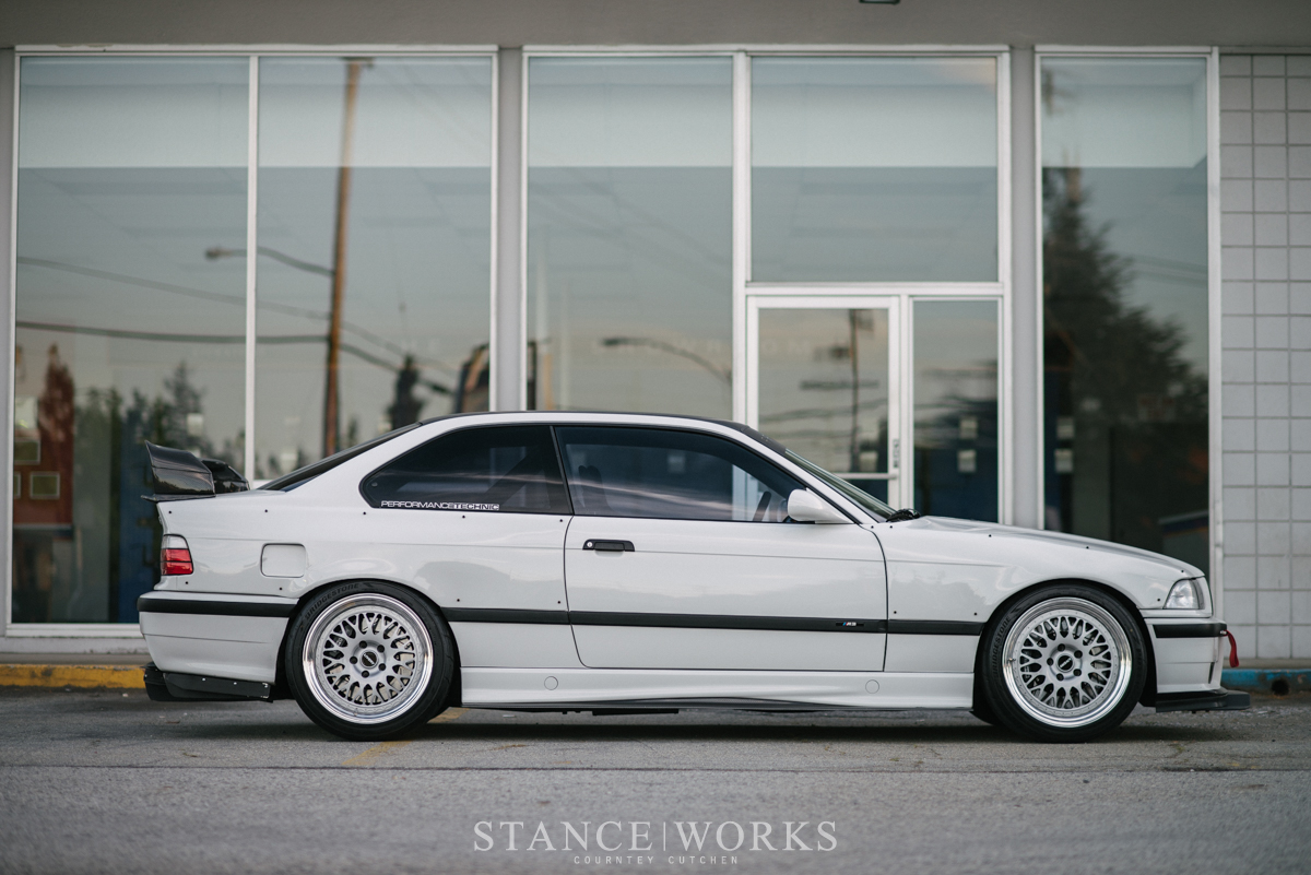

For suspension, there’s no holds barred. Motion Control Suspensions 2-way coilovers suspend the car, paired with Vorschlag camber plates. Turner Motorsport adjustable rear trailing arms and adjustable sway bars offer the necessary tuning adjustment to sort the alignment and handling characteristics out. A Z4 M Coupe steering rack was fitted, along with an OEM LTW lower front cross member. Stopping power is provided by StopTech, with a 355mm 4-pot kit in the front and a 328mm 4-pot kit out back.
The enormous StopTech brakes are hidden behind a set of custom-built Livery Proto wheels, finished with silver faces and a polished lips for a classic, timeless look. The wheels measure out to 18×9.5 in the front and 18×10 in the rear, and are wrapped in Bridgestone RE71s – 265/35/18 and 275/35/18 respectively.

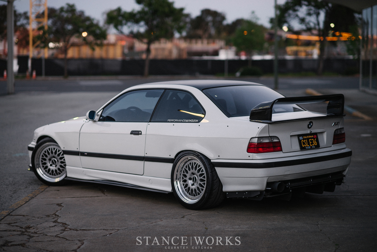

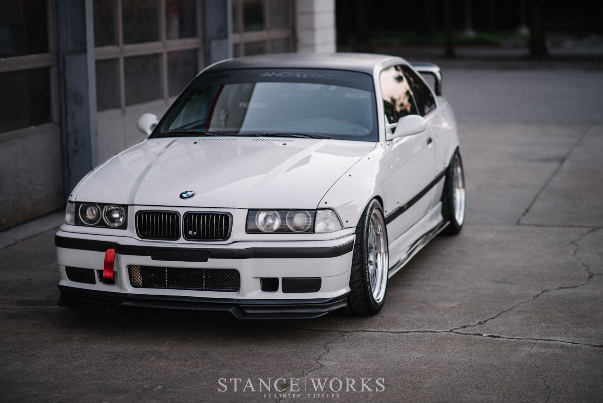

To complete his vision of the ultimate track-day E36, Shafique turned to the car’s exterior, embracing the mantra “What’s the point of going fast if you don’t look good doing it?” The Livery wheels act as a centerpiece, hugged by a set of Felony Form overfenders. An OEM LTW front splitter, fog lamp delete, and tow hook accentuate the front end of the car, while a carbon LTW wing, Mateo Motorsports rear diffuser, and carbon side skirt splitters complete the rear end. Painted in white, the car harks to BMW Motorsport’s color of choice, and the complete package creates a car that could have been a factory race option of sorts.
“When you put the ‘CSL’ name on your vanity plate, its not something to be taken lightly,” Shafique Bhimani says, and we’re inclined to agree. However, between the refined motorsport styling, the powerhouse S54, the trimmed weight, and his sheer passion for the E36 itself, we’ll give Shafique’s CSL plate a pass, and we bet you will too.
