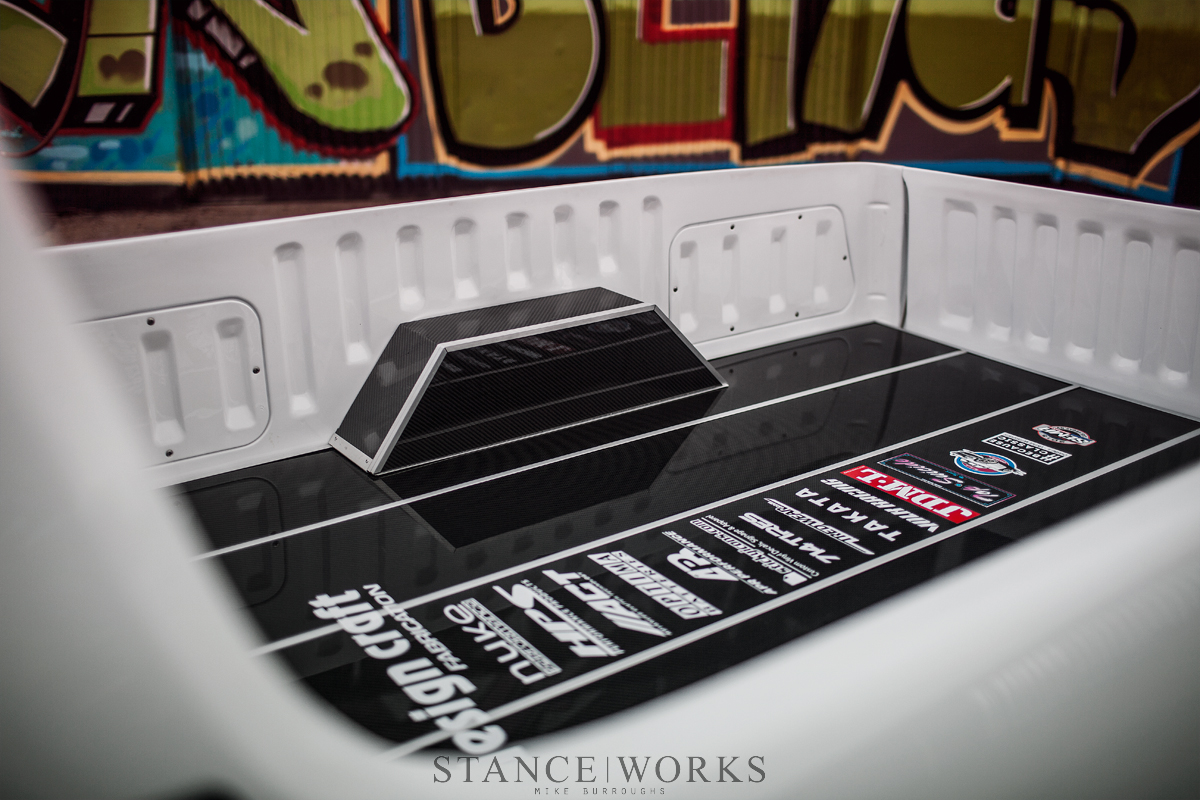

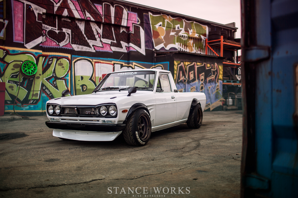

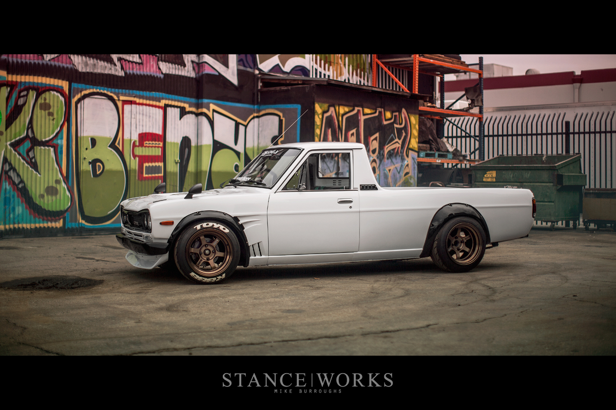

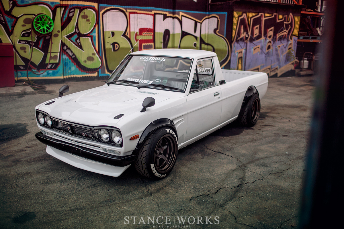

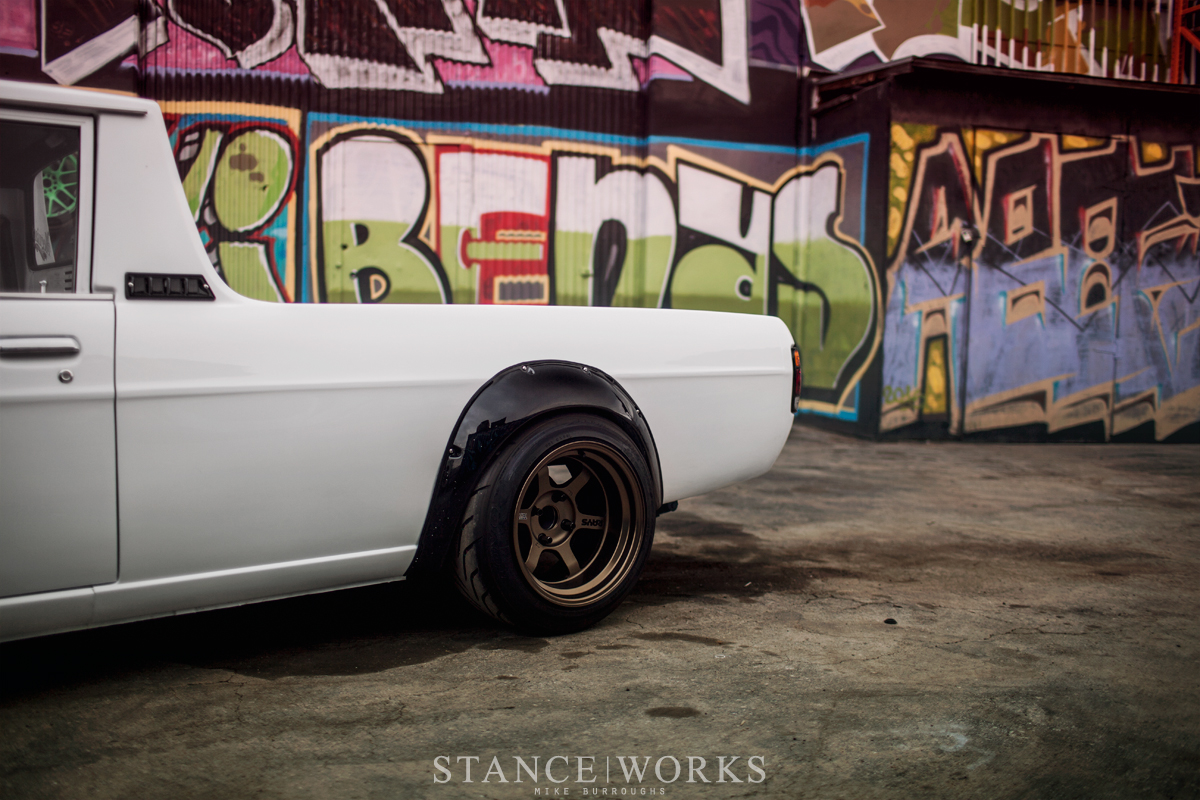

First and foremost for the build was the bodywork, and most notably, the front-end conversion. Sourced from 09 Racing in Japan, the Hakosuka front-end for the Datsun Sunny pickup is composed entirely of dry carbon fiber. The fenders, hood, and nose panel pieces make up the 09 Racing kit, while the lighting components themselves are genuine Skyline parts, purchased new from Japan. The carbon work continues throughout the truck, moving towards the back by way of dry carbon Hakosuka Skyline headlight covers, mirrors, and rear fender flares. Dominic went so far as to re-floor the truck bed in aluminum and carbon as well. Hidden underneath the glossy white paint, even the truck’s tailgate is a carbon composite.

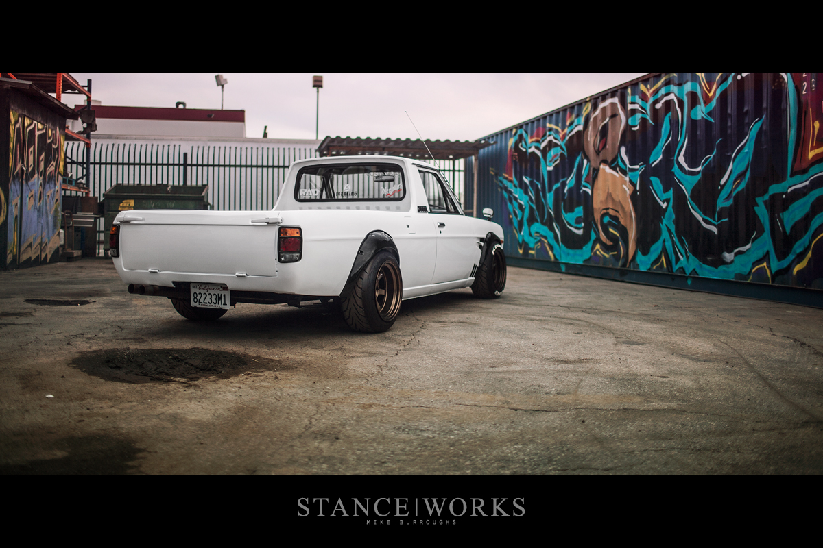

At the back of the truck, touches of custom work will undoubtedly go unnoticed by most. The bed’s cargo hook rails and the rain tray were shaved entirely, smoothing the truck’s profile lines to match the Skyline’s sleeker aesthetic. Countless hours were spent straightening and smoothing the body in an effort to give the Datsun a level of “flow” it never possessed, even new. “Although this is a Frankenstein build, I didn’t want it to look like one. I wanted clean lines so that everything would look like it was made originally from Nissan,” Dominic claims.

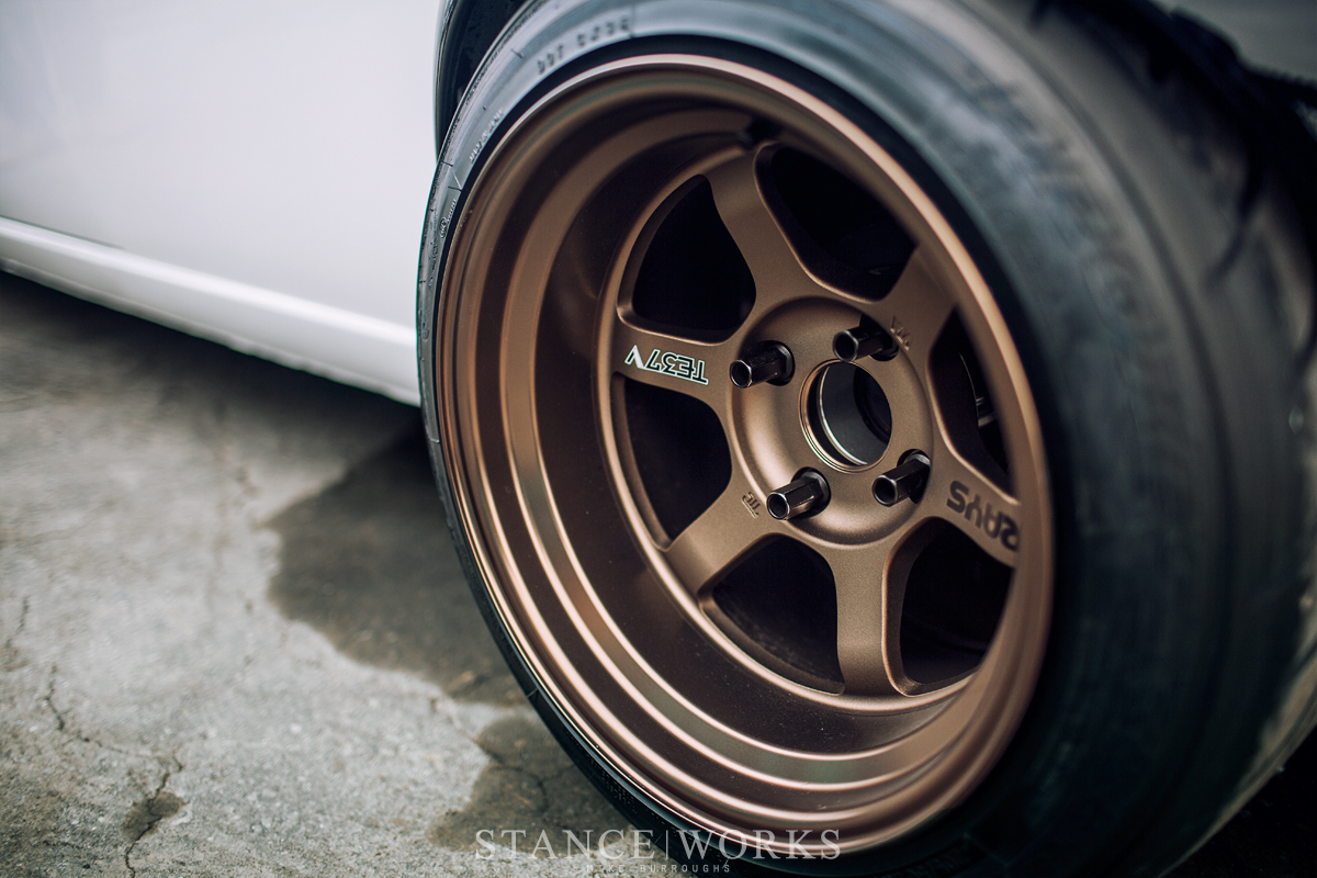

For suspension, Dominic aimed for continuity. Under the carbon fiber bed of the truck is a set of original NISMO leaf springs – an item we’d never have guessed existed. The frame itself was C-notched to allow better suspension travel, and a NISMO LSD gives the truck its squirly attitude. For the front suspension, custom Chasing Js coilovers, camber plates, tie rods, and control arms were all fitted, allowing for infinite adjustability and a solid quality ride. Affixed to the struts are Wilwood disc brakes, and attached to the hubs is a set of 15×9.5″ and 15×11″ Volk TE37Vs, wrapped in Toyo R888s.

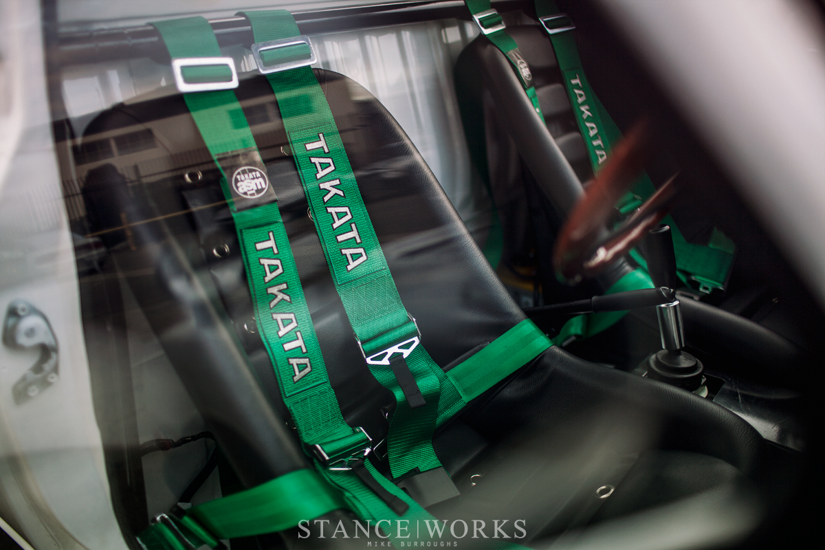

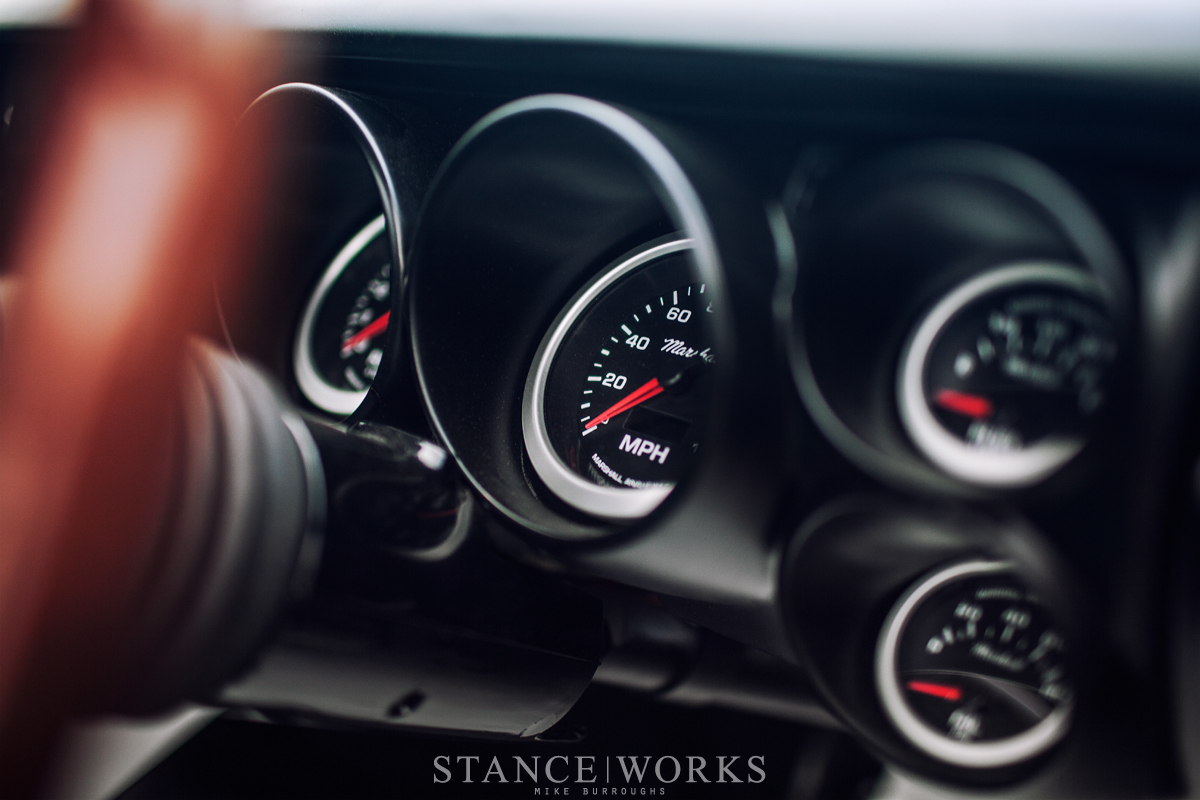

Inside the car, the details continue. A custom Hakosuka Skyline dashboard and center console were fitted to the truck, complete with marshall gauges and a Nardi wheel. Dominic finds himself seated in a set of Autolook lowback race bucket seats, and wrapped in Takata harnesses, affixed to a DesignCraft harness bar. Although the interior is cramped, it affords Dominic just enough room to wrangle the SR20DET mounted under the hood.

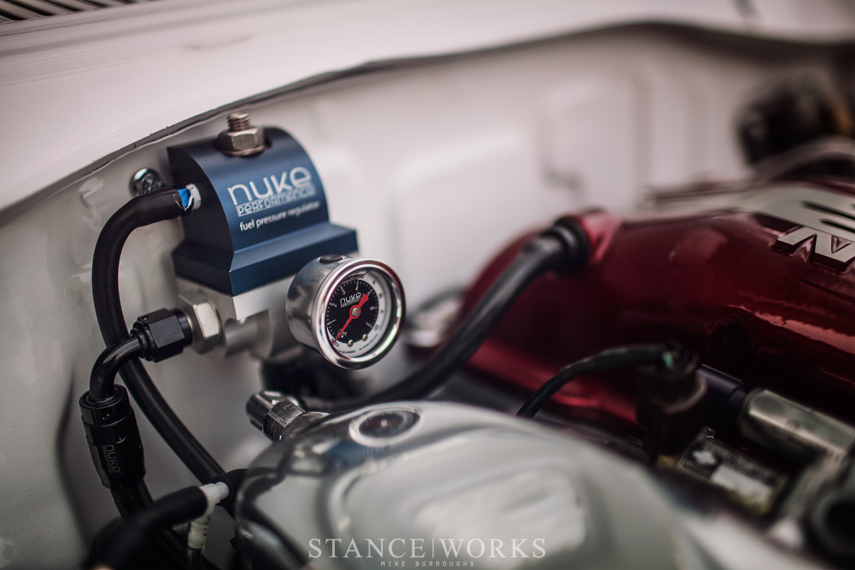

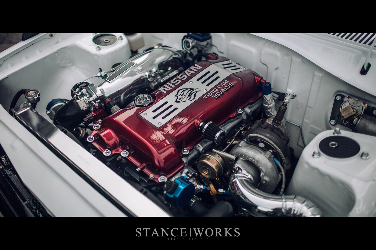

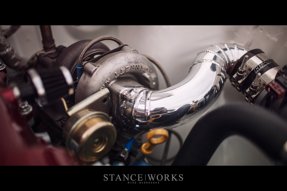

The engine bay is just as well crafted as the car’s exterior, with an S14-sourced SR turbo 4-cylinder acting as the centerpiece. Inside, forged H-beam connecting rods and a forged crank hold up to the power, while Tomei cams, rocker stoppers, titanium valves, and a slew of Greddy parts help to get things flowing. Of course, a few Nuke parts, such as the blow off valve and fuel pressure regulator, are present too. An ACT 6-puck clutch and lightweight flywheel send the power to the driveshaft, and the end result is a truck that is both enjoyable to drive and frightfully fast.

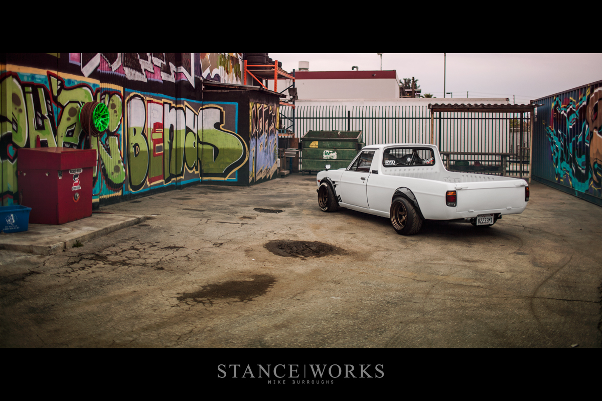

Tipping the scales at just 1800lbs, and with 450 horsepower on tap, Dominic’s Hakotora is more than a hand full, and Dominic suggests that while the power to weight ratio is one of the truck’s strongest points, its also perhaps its weakest. “Since the rear end is so light, all the power of the truck can’t be fully put to the ground.” Hardly a downside, if you ask me. If anything, it simply means Dominic Le has built a truck that looks phenomenal and has the performance to match.
