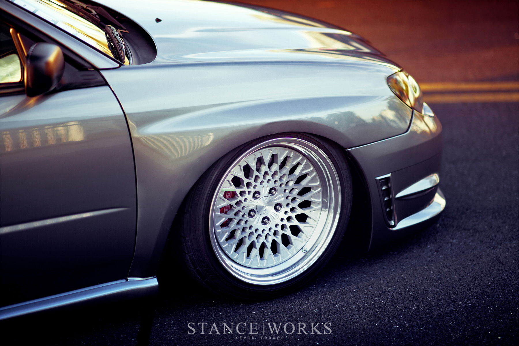

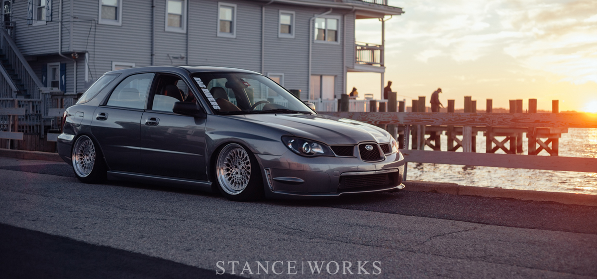

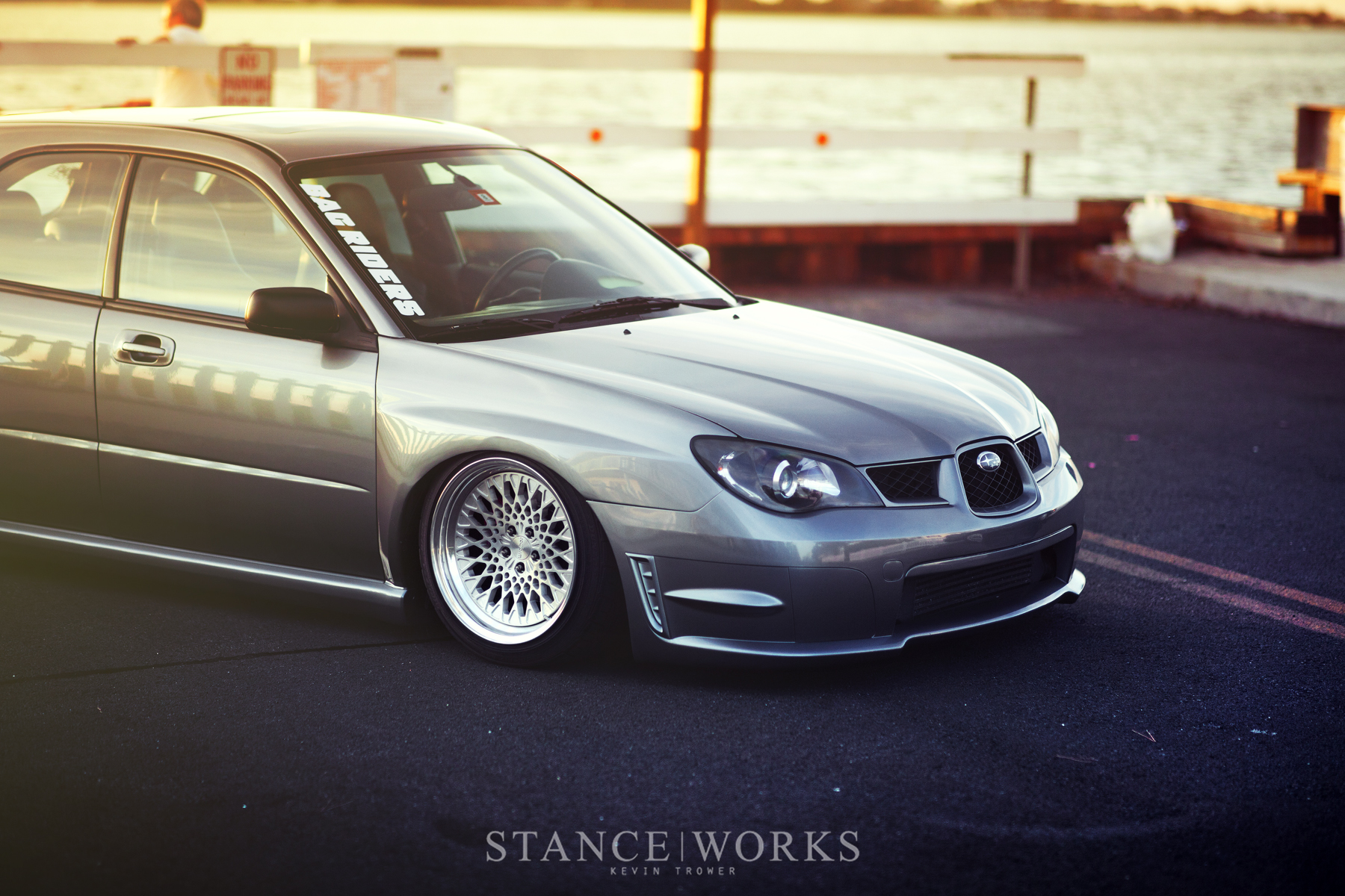

With the WRX wagon in his possession, and a plan in his mind, John got to work on the execution, beginning with the bodywork, along with the help of Cyrus House of House Motorsport and Jack McCaffrey of Many’s Autobody. “Well, long story short, it’s basically two cars made into one,” John tells me. As mentioned, nearly every panel on the car has been modified or swapped out to attain the look, fit, and finish. The nose of the car received sedan boxed front fenders, and the matching front bumper, which was smoothed and shaved.. The WRX hood was ditched in favor of the 2.5i hood, which was scoopless and sleeker in design. The side skirts were swapped from WRX units to 2004 RS parts; “I just prefer them to the WRX ones, I think they’re clean and simple.”

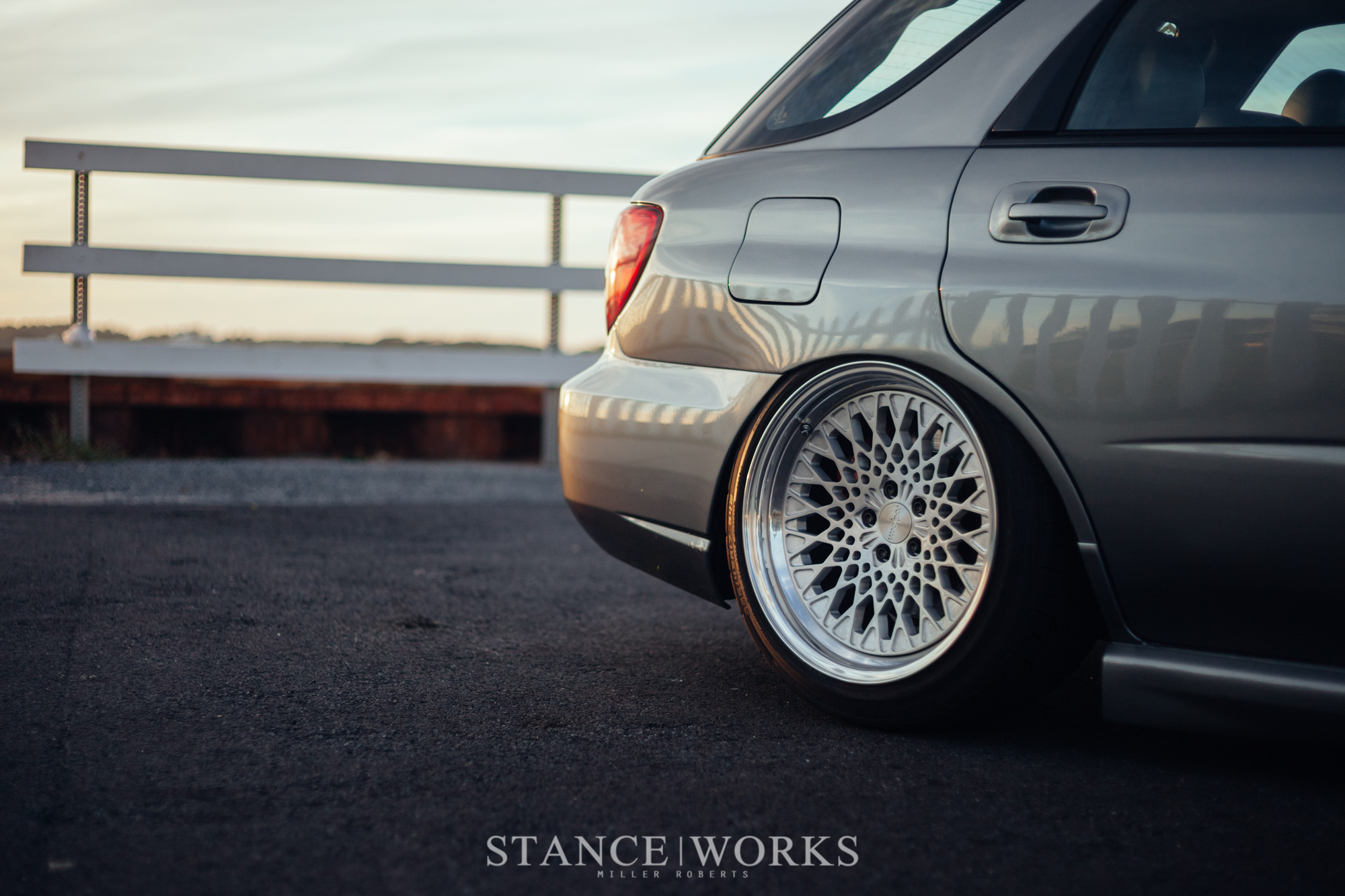

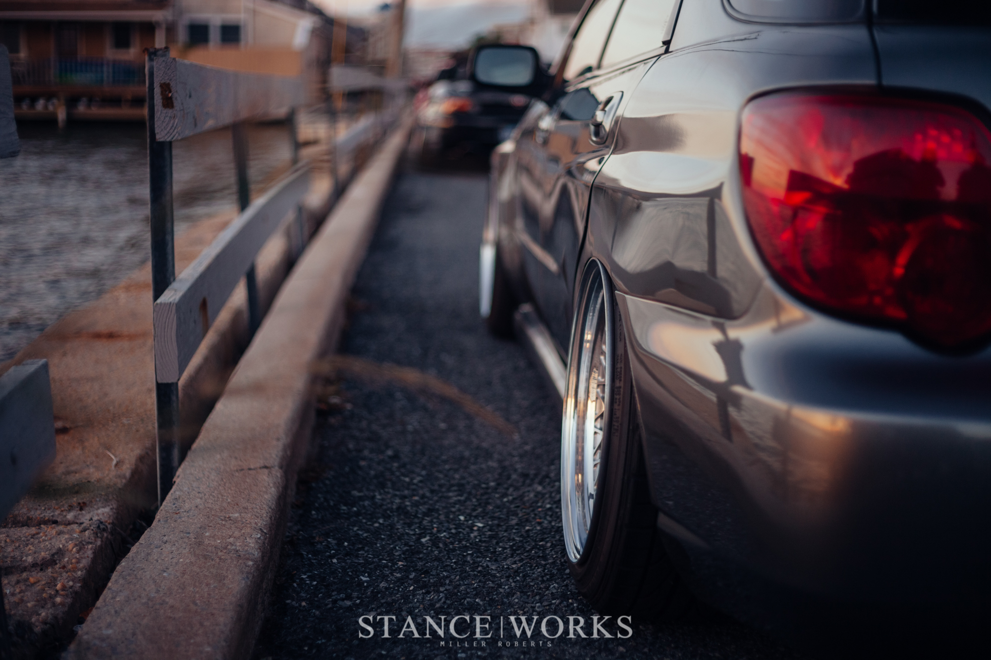

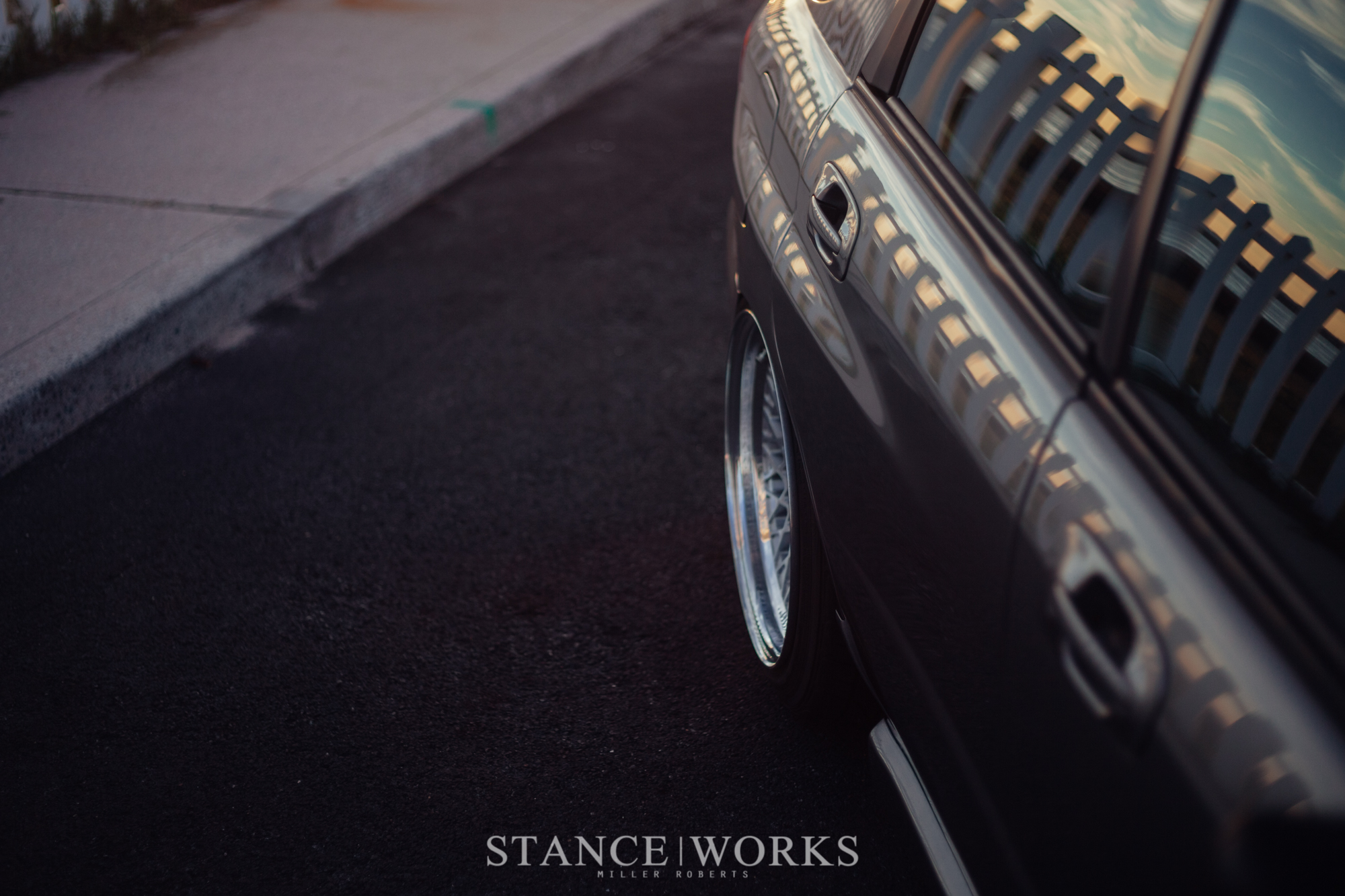

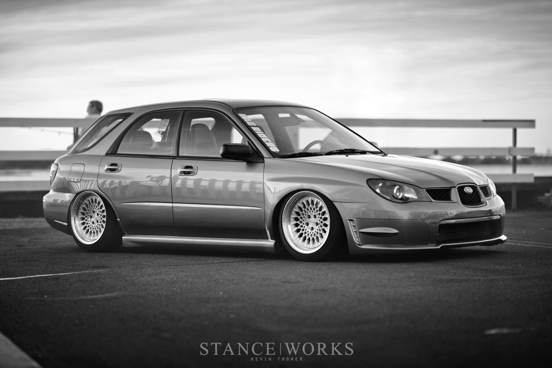

The tail end of the car is where the bolt-on and part-swap work ended. The quarter panels were cut off the car, and the inner wheel wells were extended to fill the void. Afterwards, the sedan quarterpanel was fitted to the wagon. “Lining up the body line with the rest of the car, especially the doors, was the biggest part of the conversion,” he says. John then had to swap the rear doors, also sourced from a sedan, to complete the new fender lines. “After the quarters were all done, the rear bumper had to be trimmed a bit to line up with the new body lines.” Lastly, the hatch has the emblems and spoiler removed, with all of the holes filled for a clean look.

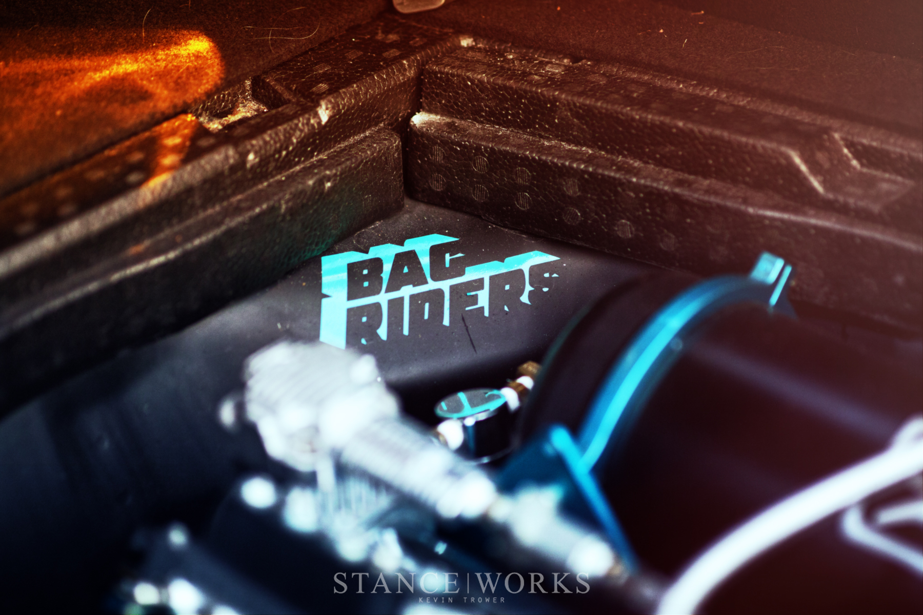

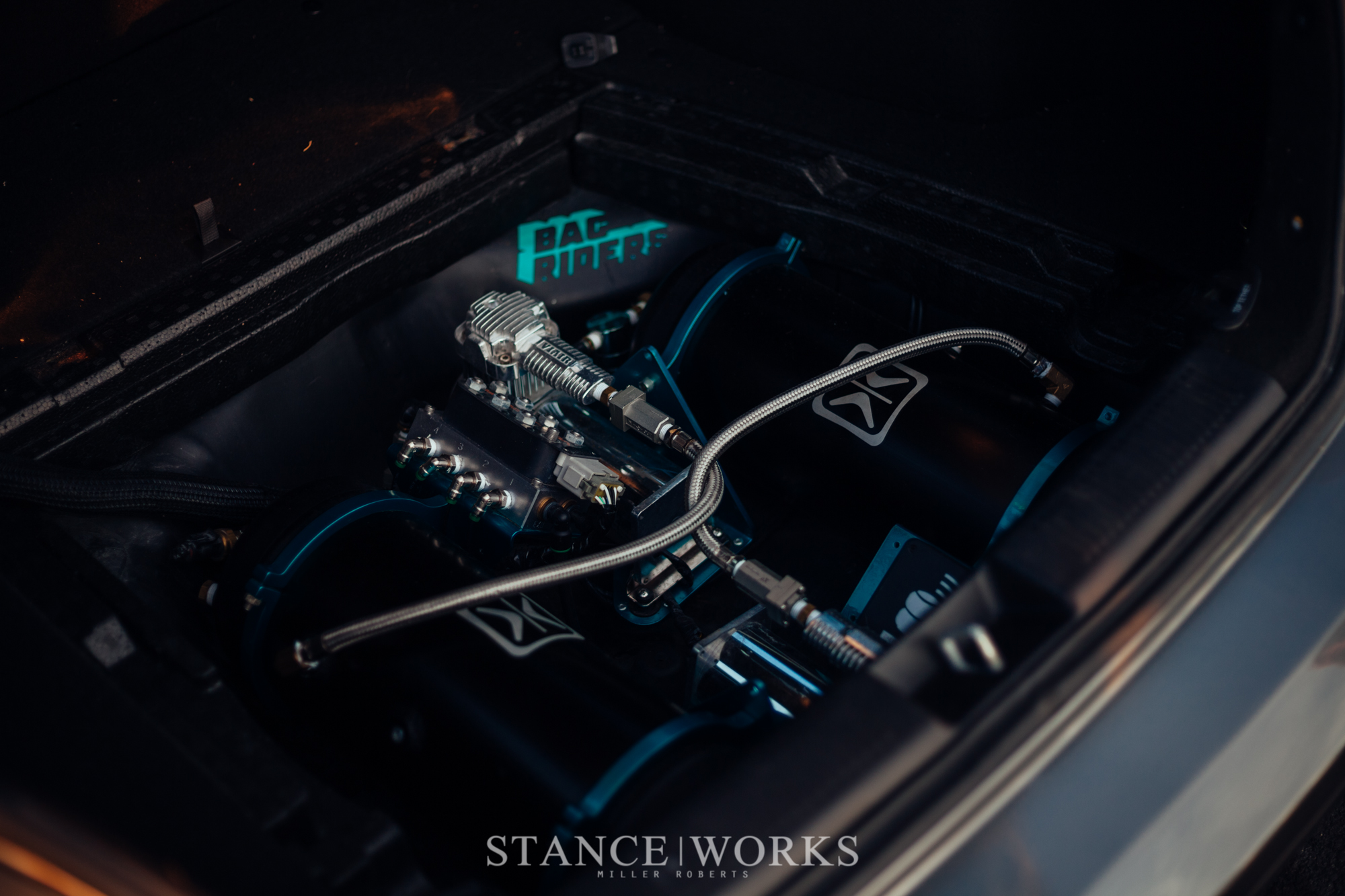

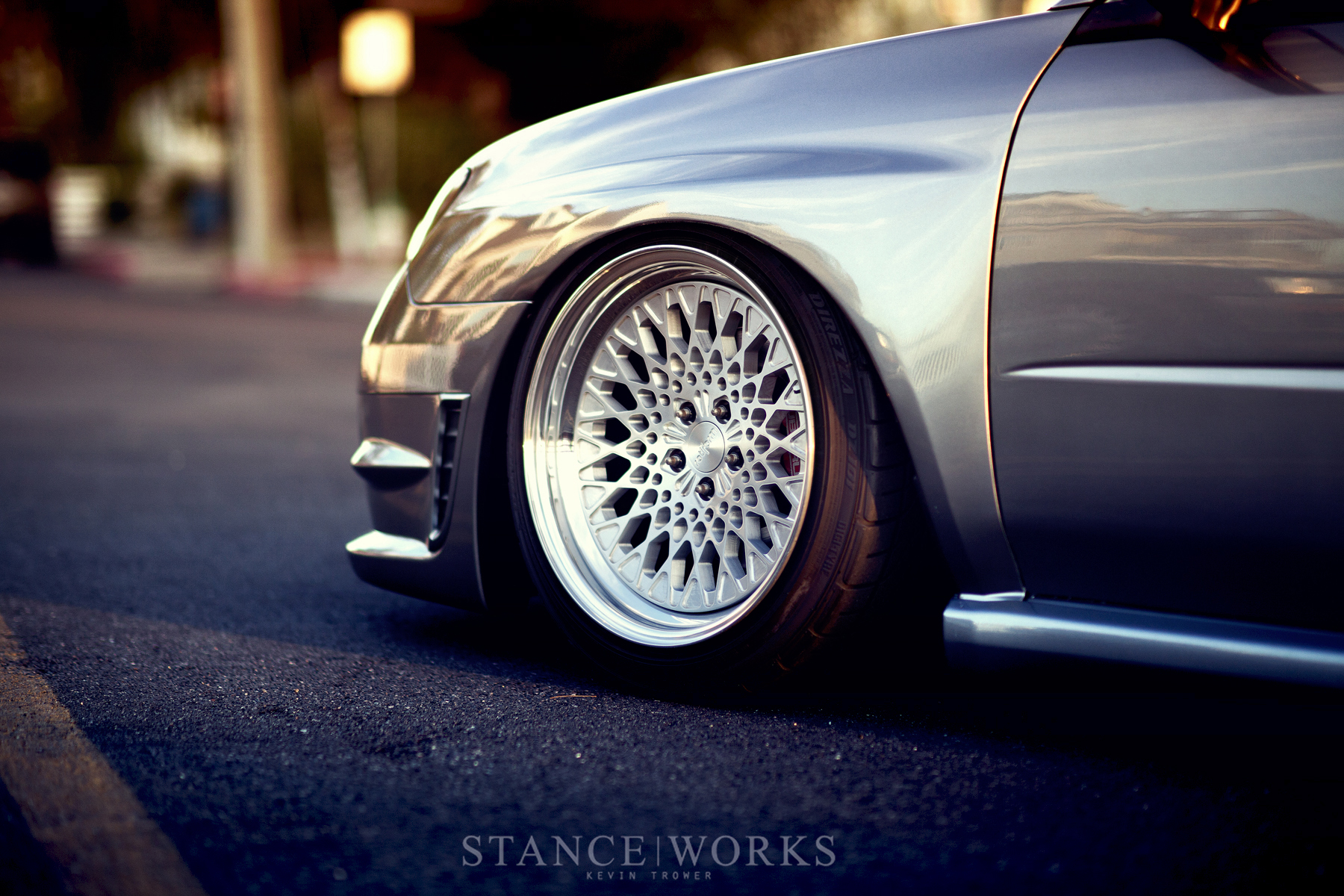

The amount of work in the body changes alone are enough to put John in the deep end of the swimming pool, but the changes themselves are as subtle as can be. To bring life into what could be mistaken for a stock car, John moved on to the suspension and wheels.  It should go without saying that Bag Riders was the answer to the problem at hand, and as Bag Riders’ IT director, John was driven to push the car’s suspension to perfection. Air Lift Performance front and rear struts, which the Bag Riders team helped to develop and bring to market, brought John’s car down to the ground. Digital management keeps things working in unison, with Zaetech digital pressure gauges allowing John to keep his own eye on things.
John didn’t stop with the struts; H&R Camber Bolts, A Whiteline 22mm swaybar, and Kartboy front and rear endlinks help to round out the setup. Lastly, John sought out his wheels, and finally decided on a set of Rotiform 3-pice LHRs, measuring out to 17×10 on each corner. Concave faces, hidden hardware, and stepped lips create a perfect combination, and things are wrapped up in Dunlop Direzza 225/45s.
