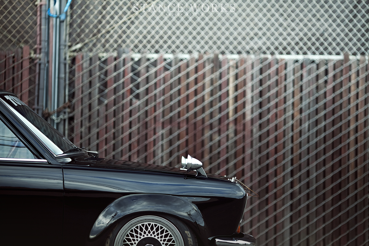

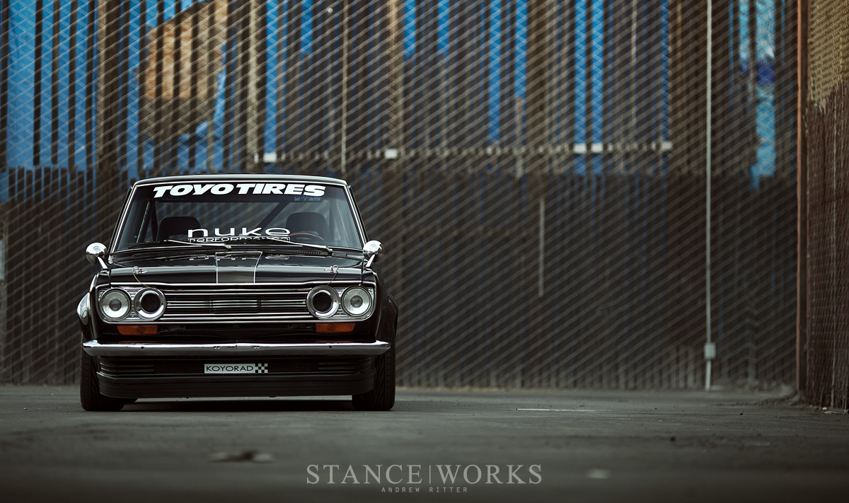

As an ’80s child, Dominic grew up seeing Peter Brock and the BRE Datsun team dominate on the pages of magazines and on TV, dreaming to one day afford one. After purchasing the wrecked coupe, and facing substantial bodywork, he looked back to his childhood inspiration of Datsun race cars, and began the project with BRE fender flares. “I wanted a very sleek look, as if it was to roll out of the Datsun factory back in the ’70s… Clean and simple was my goal.” Months of time was sunk into the fenders alone, his decision to paint he car black forcing the need for perfect bodywork. Much to the chagrin of fellow 510 lovers, Dominic cut away the fenders in order to achieve the BRE-inspired OEM aesthetic he desired.

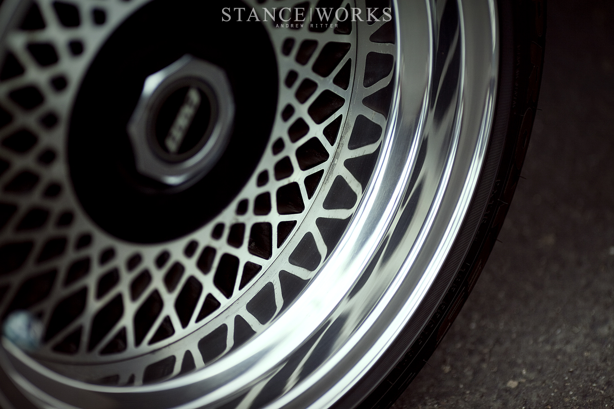

With the fender work completed, Dominic turned to the suspension, wheels, and tires. Not one to leave any part of the car a simple off-the-shelf solution, Dominic sourced Datsun 280zx struts and shortened FC RX7 Tokico shocks fitted with QA1 coilover perches and custom camber plates for the front. In the rear, the crossmember was modified with a custom camber adjustment system, and KYB AGX shocks were fitted with QA1 coilover adjusters and Eibach 300lb springs. Lastly, the rear differential was swapped out for an R180 Subaru STI unit. To fill the arches, Dominic went with ’70s-Era Enkei EK64s, sitting at 15×8 ET -7 in the front, and widened in the rear, out to 15×9 with a final offset of -15.

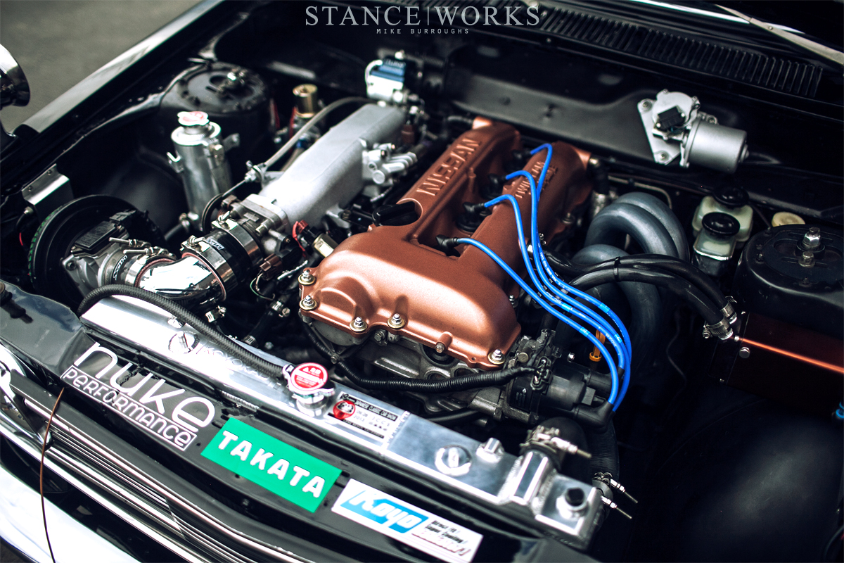

It seems, at first glance, that Dominic followed the status quo – a Nissan SR20 can be found under the hood, as is the standard. However, instead of the Japanese turbocharged counterpart, Dominic kept with the naturally aspirated USDM version, sourced from an S14. “I had built turbo SRs in the past for friends, and they are great engines, but I just wanted to push myself a bit more and see what I could build with a naturally-aspirated engine.” He admits that it would have been cheaper to stick with a turbo, but he’s happy with the outcome.  “I had never really worked with NA SR20s, so I did a lot of research to see how it produces power.” Finding NA build parts proved difficult, as most shops carried parts only for the turbocharged version.

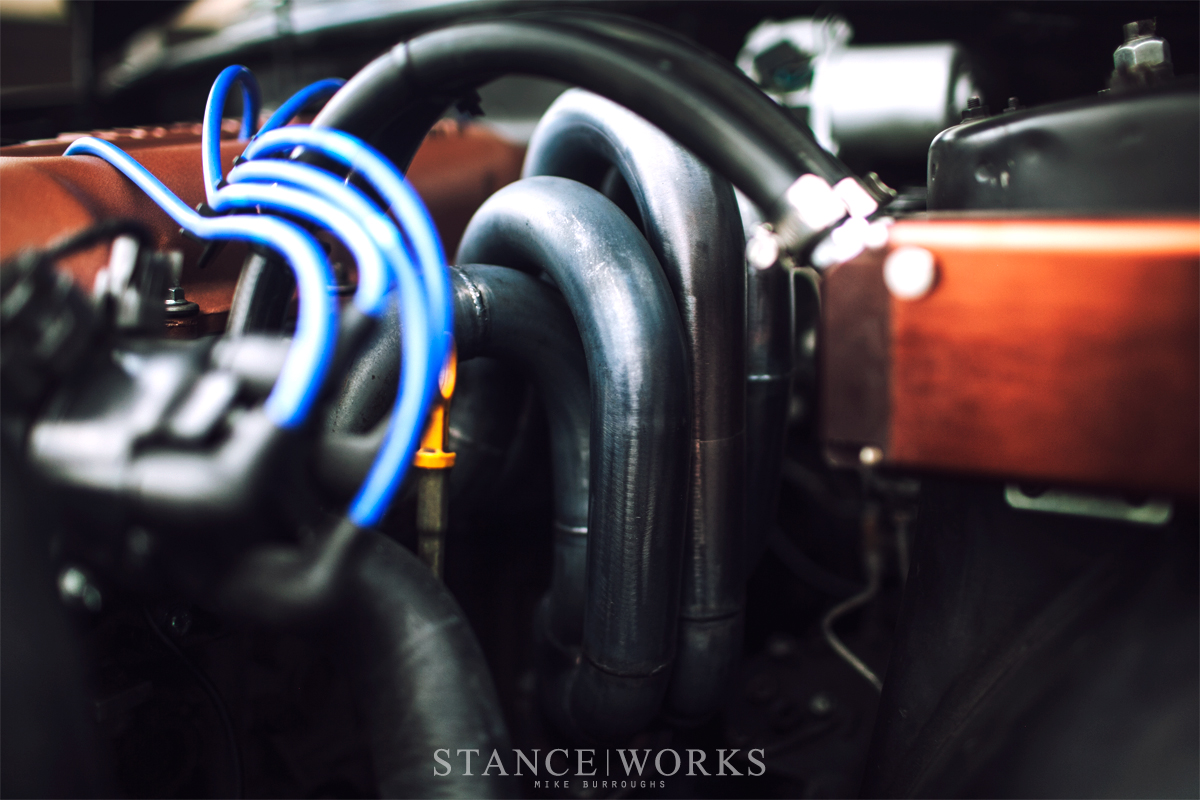

In the end, Dominic turned to Tomei for a 2.2-liter stroker kit. His goal was to pump out 200 horsepower, which is a fair gain over the 140 horsepower stock rating. He had the throttle body modified, added in bigger injectors, and KA24DE headers, but the outcome was 20 horsepower short of his goal. “At this point, I could have built two simple turbo SR engines for the price I had sunk in, just to make 180 ponies. However, it did give me 9000RPM of rev range, and it pulled well.” Finishing out the engine build, Dominic had a custom set of high-rise long tube headers made for a boost in low-end performance. All that’s left is to source a set of Tomei ITBs. “It’s a Datsun, and no Datsun owner ever finishes their build.”

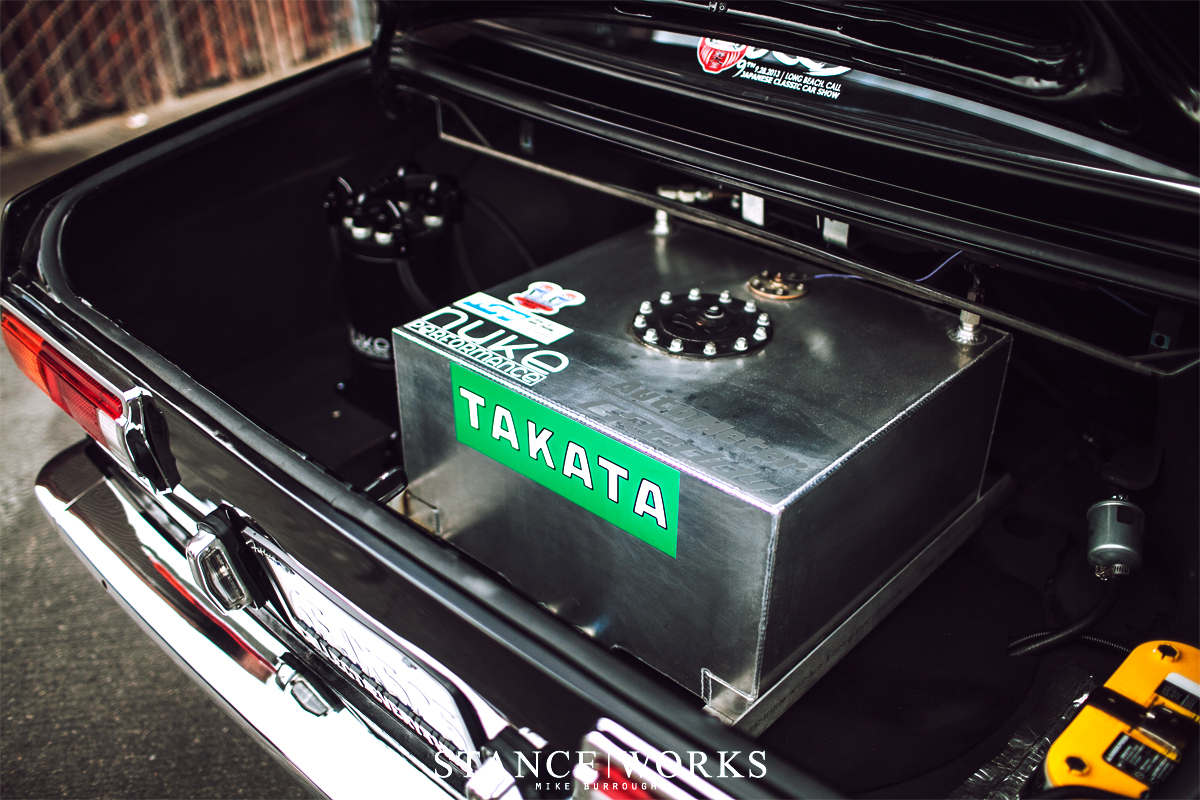

Under the trunk, things are just as impressive – a custom fuel cell sits perched over the spare tire well, and next to it, a Nuke Performance surge tank and fuel filters keep the engine from running thirsty. The setup offers the perfect chance to showcase some of his products – when he’s not building cars, Dominic works to build companies, with his days spent split between managing budgets and the financials for Mitsubishi Motors, and working to bring Nuke Performance fuel systems to North America. Having grown over the past decade into prominence as one of Europe’s top surge tank and fuel system components manufacturers, Nuke looks to launch its products stateside in January, which Dominic humbly yet proudly suggests will redefine the market in North America.

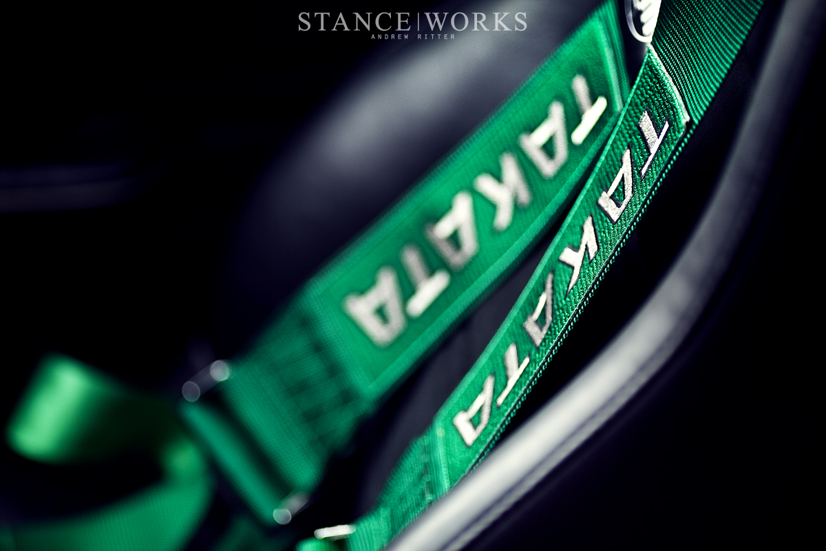

Moving further inside the car, Dominic admits the interior is likely his favorite part. “I had the help of my mother to sew up the leather headliner and door panels. I hadn’t really worked on interior, and this gave me something new to learn and the result turned out pretty good.” A traditional set of Takata harnesses accent an otherwise black interior, with the modern gauge faces hinting at the performance goodies that lie at the front, rear, and underneath the car.
