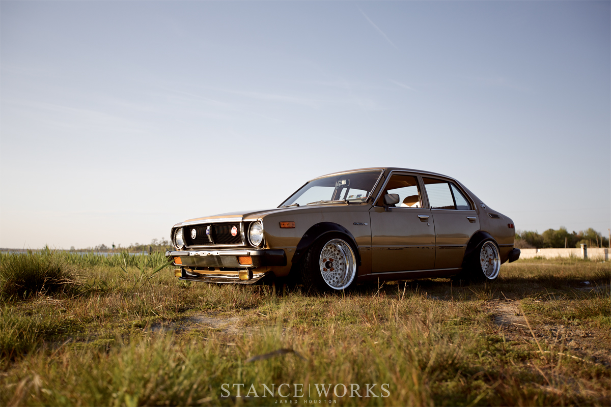

Justin, having had his beloved 240sx stolen, found himself searching through Craigslist for his next project. He stumbled upon a 100% bone stock and original 1979 Toyota Corolla TE31. The car had been listed for just two short hours, and it was in fantastic shape, representing a prime example of the Corolla’s third generation. Justin had been looking for the best “bang for his buck” due to his current circumstances, and he quickly plucked this classic Corolla, which fit the bill perfectly.
With his love for vintage Japanese cars, he knew that he wanted to create something with a classic and period correct ambience, but a car that also displayed an aggressive look. To accomplish this look, Justin had modify a chassis, against the approval of some diehard Toyota fans, since they would be irreversible changes to an original TE31. This wouldn’t phase Justin though, as he focused in on the vision that had formed in his mind just after this Corolla fell into his hands.

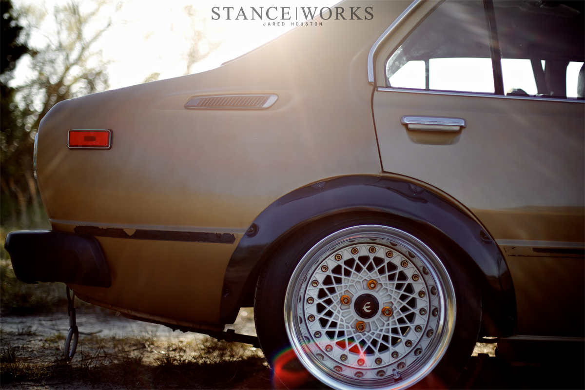

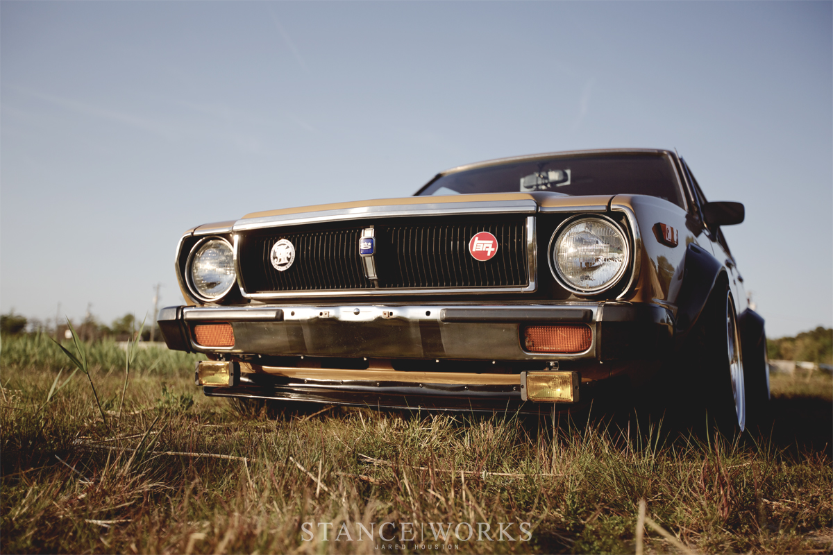

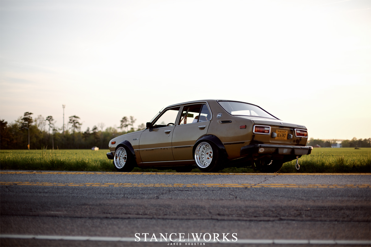

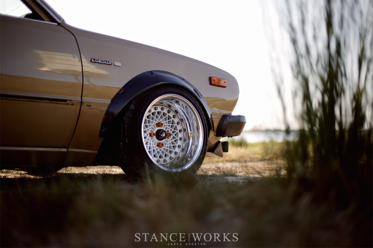

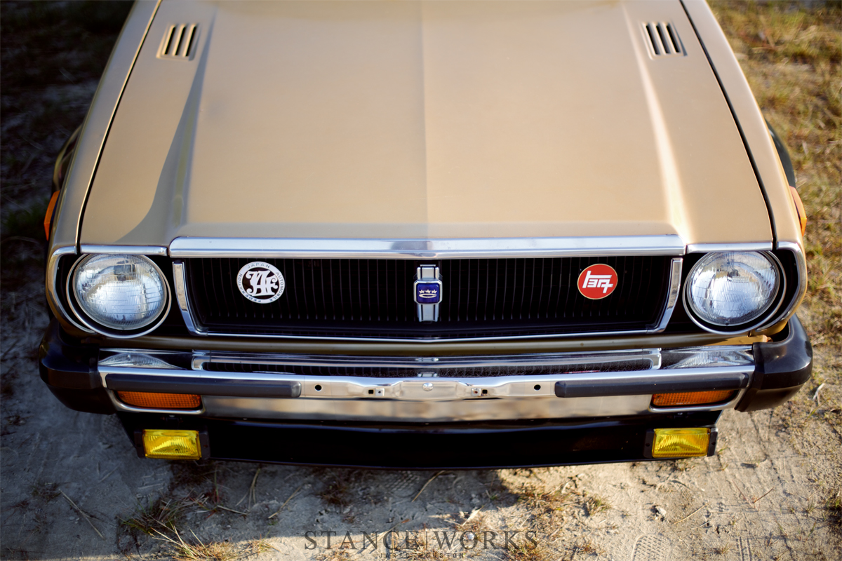

Even though Justin’s Corolla was in impressive condition compared to most coming off the east coast, he knew that some serious modification would have to happen to fulfill his desires. First up was trimming the arches to allow a more aggressive wheel to be shoved under the TE31, which was then accompanied by Datsun wide 2G flares. Subtle changes like tucking the US Spec bumpers and also fitting a TE72 TRD style chin spoiler were also made to keep a period-correct look, but with some attitude.

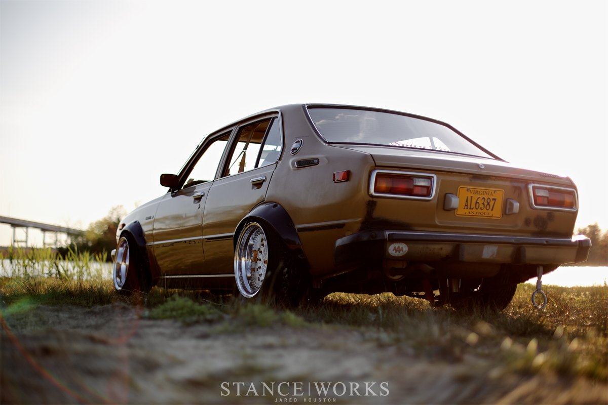

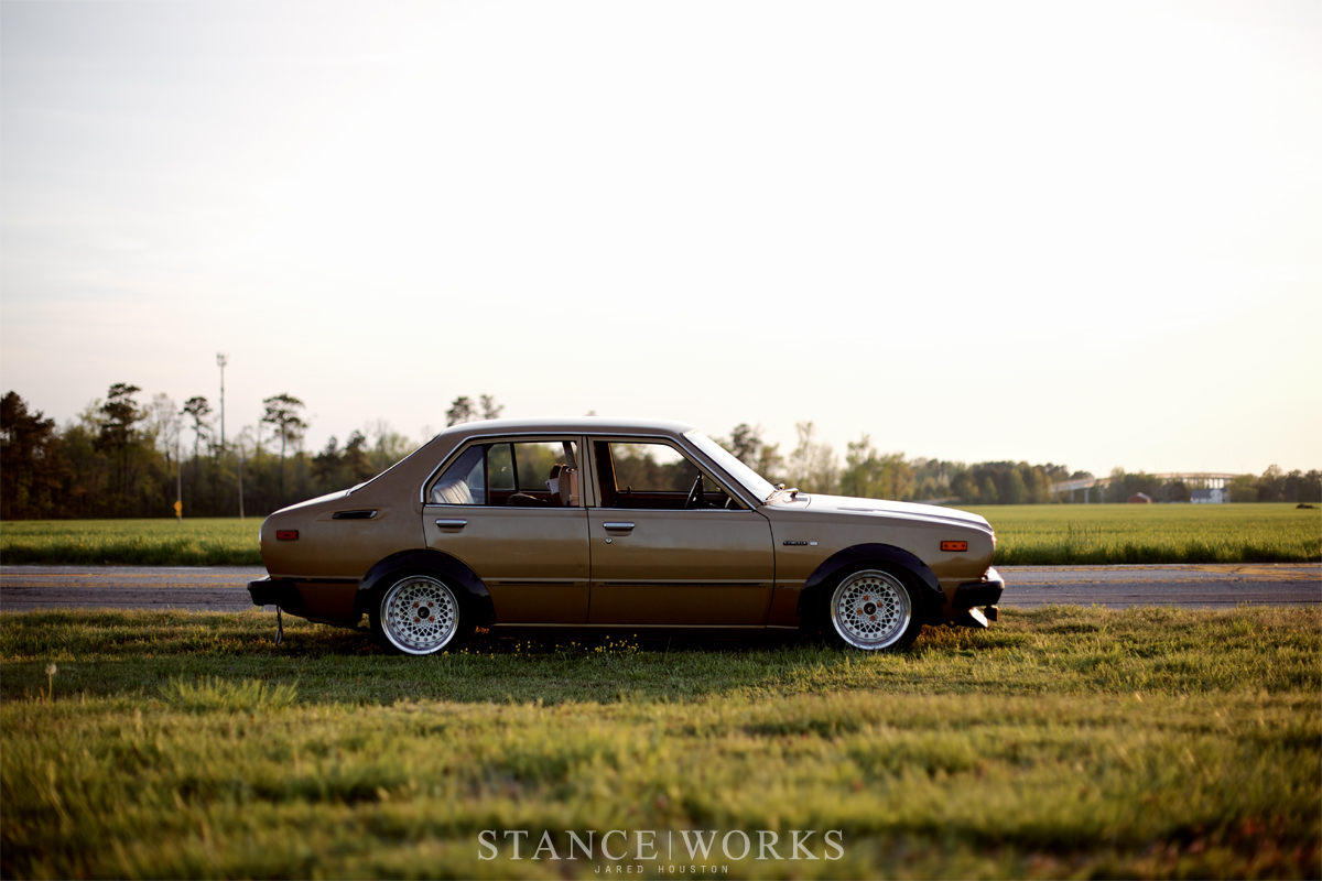

To fill the massive space that had been created by modifying the arches and adding flares, a set of Epsilon mesh wheels were rebuilt to the size of 15×8 up front and 15×10 in the rear. With the wheels built and the flares finished, Justin dialed in the offsets to -63mm in the front and -50rnm out back with the assistance of 25mm adapters. These changes in the suspension have completely changed the look and feel of the car, giving this over-looked generation of Toyota’s most successful chassis a menacing look that lingers in your mind.
Since the vintage Corolla chassis lacks aftermarket support especially when it comes to the more in-depth modifications, Justin had to get creative with his suspension setup. Up front, he did a custom short-stroke AE86 coilover conversion using weld-on Ground Control sleeves and MR2 KYB Struts. In the rear, Justin went with Chevy S10 4″ lowering blocks paired with KYB Camaro rear struts. It’s a setup that took time and precision, but paid off when the chassis sat back on the pavement.
