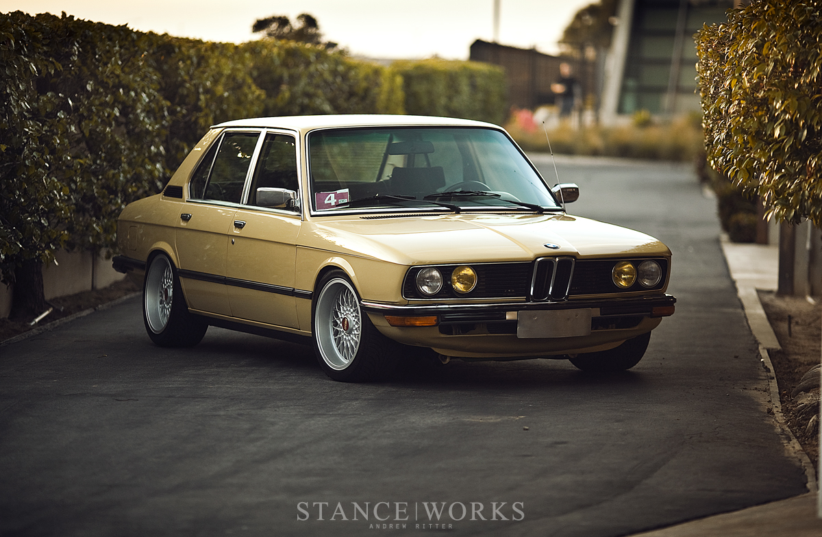

But where BMW Motorsport left off, Ron Perry picks up. The latest project to roll out of Perry's well-established shop is this gorgeous Sierra Beige E12, which began its own life as european 520 (six cylinder, M20-powered) example. What attracted Ron to this example was its sparse options list: a total "strippo" model, as he put it, with only a heater for luxury. Aside from the six-cylinder engine, it was as base-model as they come. It was the perfect foundation for a stripped-down lightweight no "BS" Bavarian hot rod.
When Ron purchased the car, it hadn't been run in a number of years. The tired, old M20 was in need of affection, but it was far from anything Ron was concerned about. The car's deep shine and good paint condition were reason enough to not leave without purchasing the car. Even the awful green interior and the automatic transmission weren't a concern - Ron had plans to tear everything apart to see his idea to fruition.

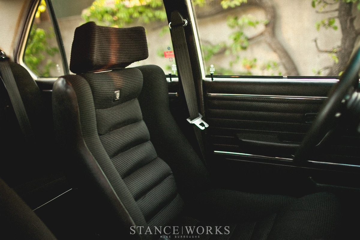

In typical Perry fashion, it wasn't long before every facet of the car was receiving attention. Inside the car, the green trimmings all received a deep black dye, and the front seats were replaced with period correct Scheel bolstered sport seats, which Ron had been waiting for a chance to use for years. He went through the effort of sourcing a perfect black carpet, which brought the interior together. Black was the only option.

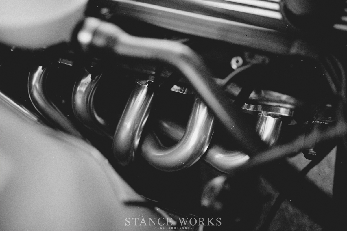

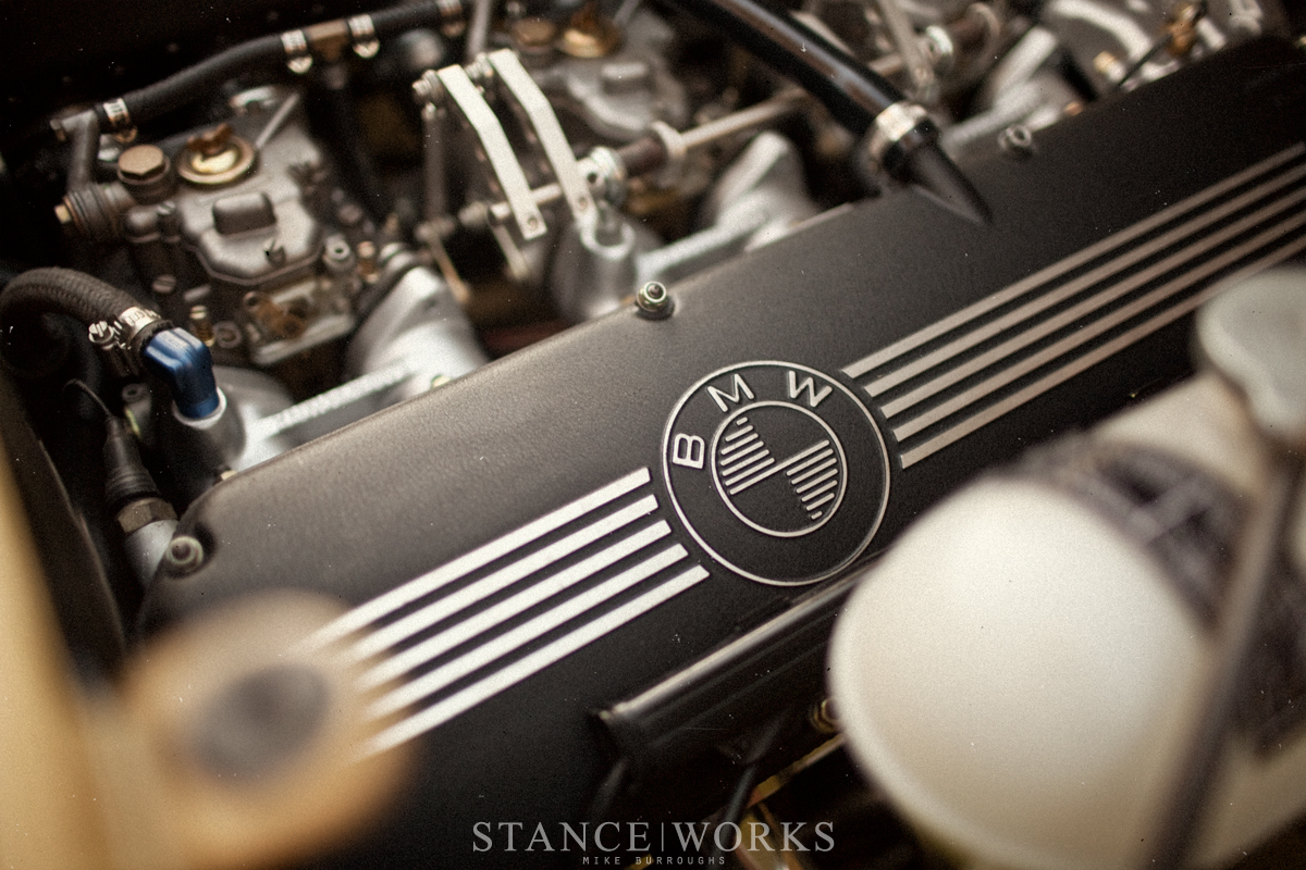

However, truth be told, I don't think "upgrade" totally quantifies what Ron has done. While it's no 700-horsepower swap of sorts, in BMW terms, it's just shy of the holy grail. The heart of the E12 was sourced from a Group 4 3.0 E9 CSL Ron has been restoring. Built by Dinan years ago, the punched out 3.9-liter stroker M30 sports a 306 cam, with air piped in through triple 45DCOE Weber carbs and a truly rare Dinan airbox, and out through an all-stainless exhaust. The high-strung NA lump makes the subtle E12 scream its way down the road.

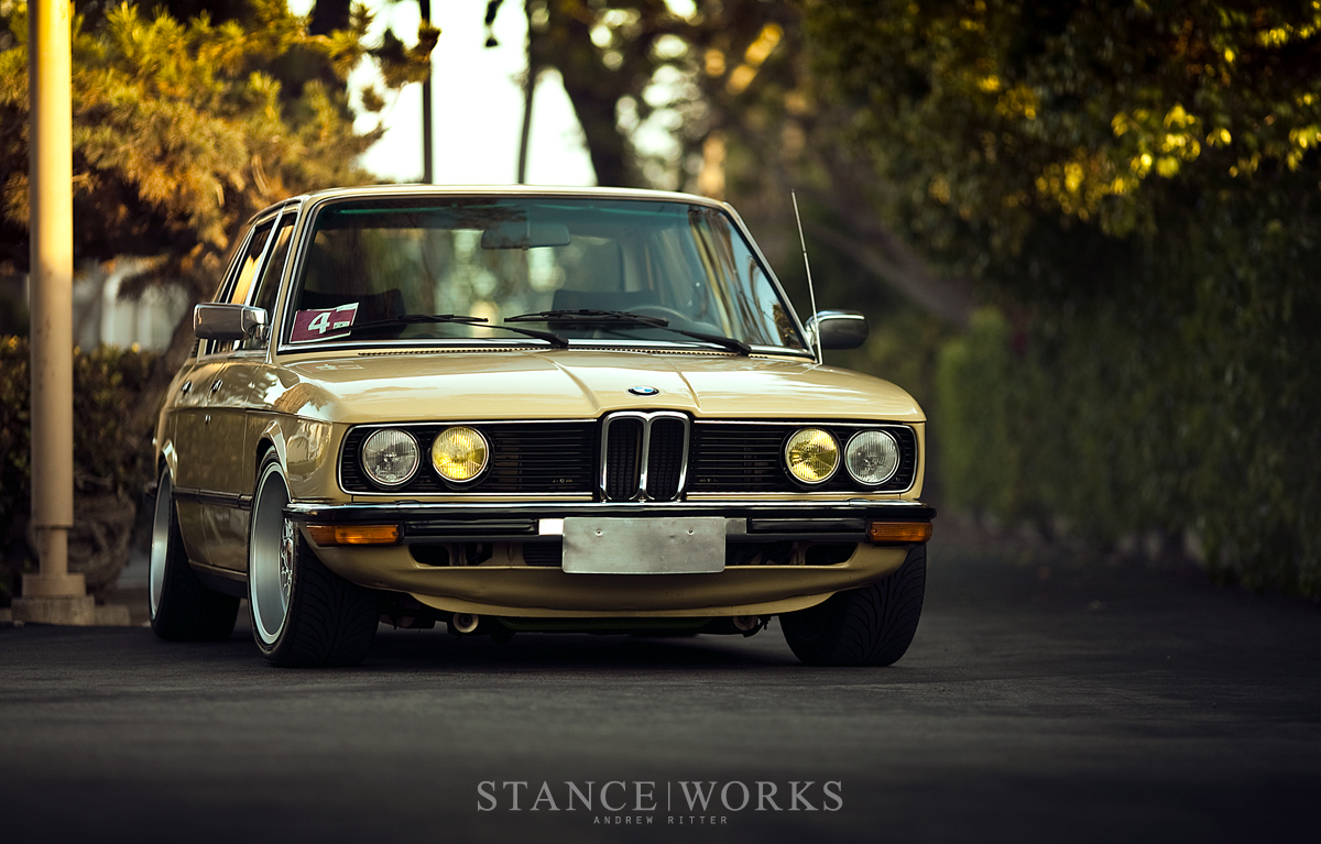

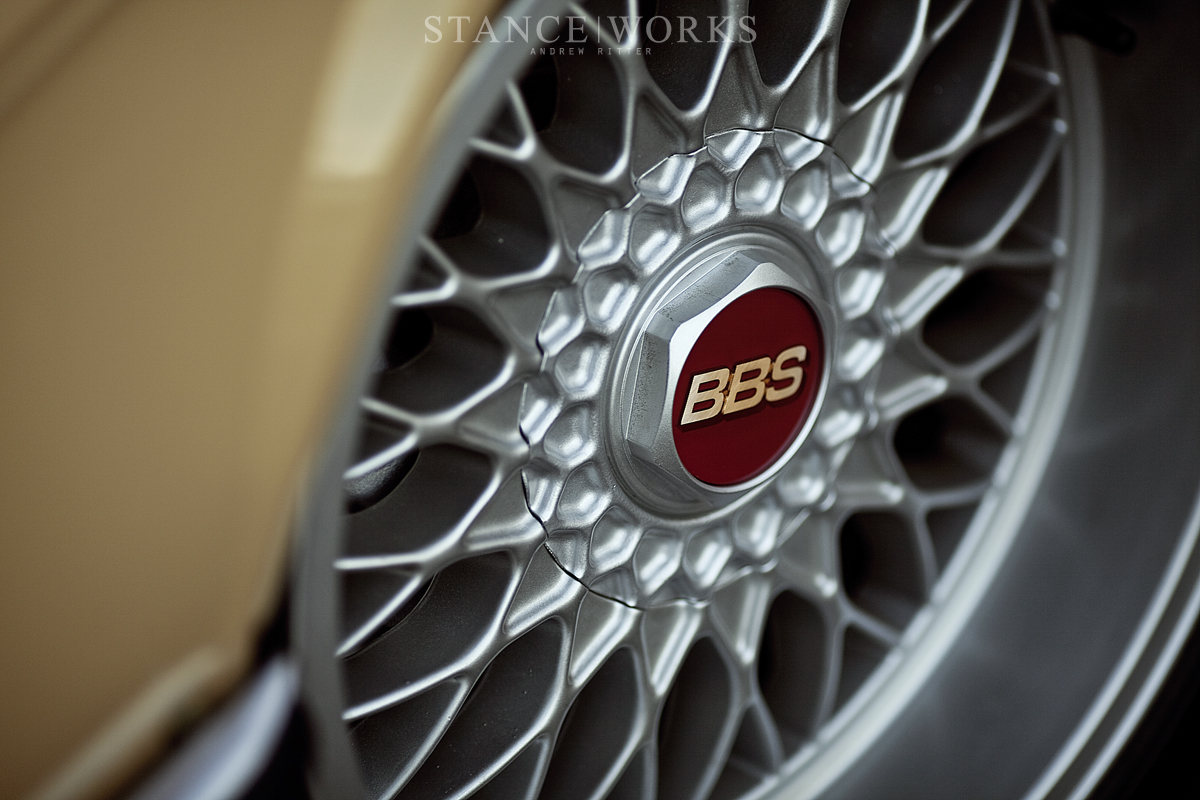

With the subframes off the car, Ron opted to powdercoat and refinish every component of the suspension and underside of the car. New Bilstein sports and B&G springs made it onto the car, with ST swaybars keeping things planted. 17x8.5 BBS RZs keep an OEM+ look to the car, meaning no one expects race-car power from the quiet little sedan.
The complete package is delightfully understated, blending everything that made the E12 special with everything even the most fanatical could dream up during the car's heyday. With the perfect sleeper attitude, Ron Perry has built one truly fun Bavarian hot rod.
