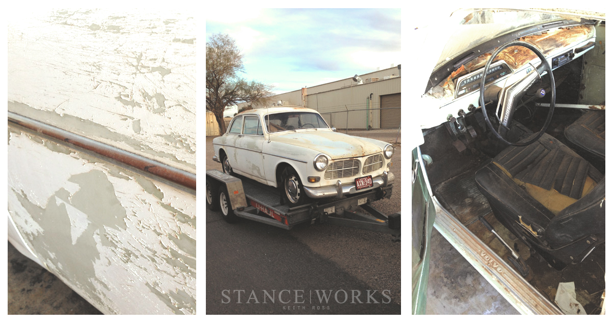

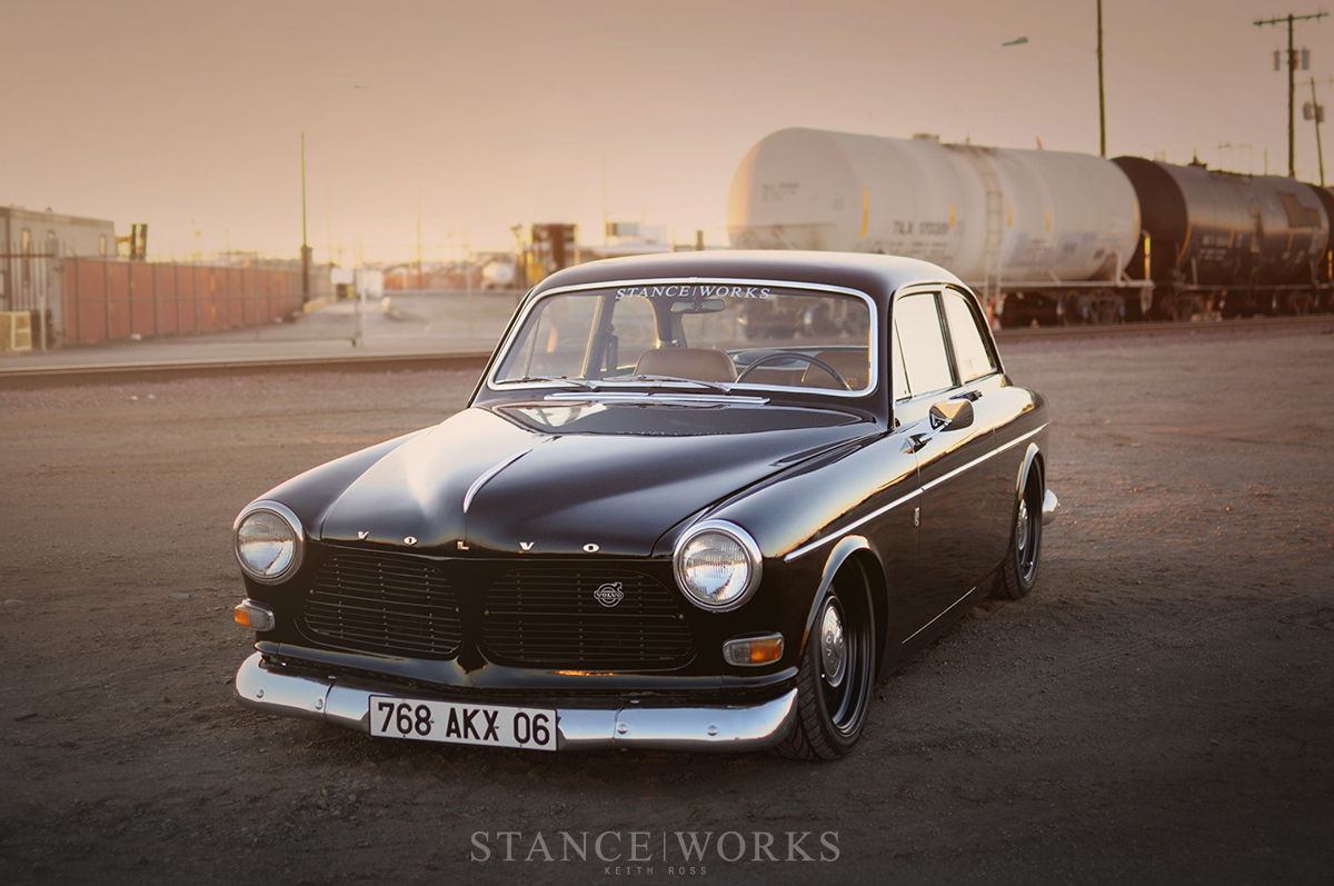

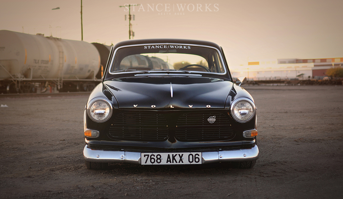

After only a year, the Volvo 122 has come a long way. The car was in rough shape when it came into Keith’s possesion. A white roller paintjob was flaking off of the old tired green that originally adorned it from the factory. The interior had suffered the test of time; and the rubber bushings, balljoints, and weather seals had all but deteriorated entirely. The car was really showing its age, but Keith was determined to restore its original elegance with a dash of his own style. He felt that black would be the perfect color to play off the chrome accents that lent such a classy look to the 122. A new glossy paint job coated the panels and extended onto the grills, bringing a new color and shine to the round lines of the Amazon’s body. The old hazy bumpers were replaced with shinier examples and the overriders were left off for a sleeker profile. In need of a side mirror, he looked back to the classic American cars to find a part that would flow with his Volvo’s original American influences. A mirror reappropriated from a ’68 Camaro was the perfect match and was bolted to the door low enough to ensure proper function of the window vents in hot weather. The new chrome additions sparkled nicely against the car’s black bodywork and completed the work on the exterior for the time being.

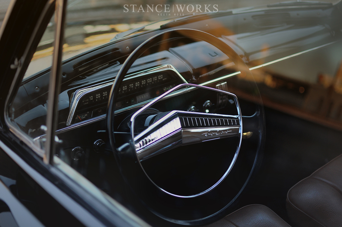

With torn leather, dirty panels, and the interior in disarray, it was time for a complete restoration inside the cabin. The dash was removed and painted black as the instrument panel was replaced with one in working order. Details ranging from the steering wheel to the switches were polished and painted while his upholstery guy worked hard on the seats and panels. New peanut buttery leather covered the seats and brought a bit of warmth and class to the color palette. Like magic, an old ratty interior soon became one that emanated with craftsmanship and Keith was able to focus on the fitment where his interests truly lie.

I watched the new photo updates appear in his build thread on the StanceWorks forum (For a full build thread click here) with great anticipation and I knew it was a car that would grace the StanceWorks blog one day. Keith took an old worn out classic and reinvigorated it. He introduced his own modern touches to the build but he did so while staying true to the original nature of the beautiful 1966 chassis. The outcome is a European car that remains elegant and classy while also exuding a tough gangster demeanor reminiscent of 50s Americana. Without striding too far away from the standard lines, Keith put together a car that captured our attention and the attention of many others. I applaud him for his recent restoration and I eagerly await any future updates that he has in store.
