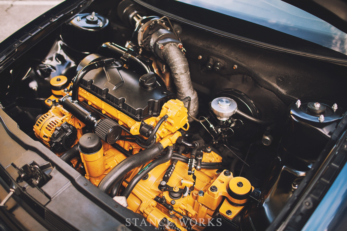

It was only a brief hiatus before Mike was back at it. After attending H2Oi, he was inspired once again. Unsurprisingly, the GTi was torn down once more: the engine was pulled, the turbo kit was parted out, and this time, Mike began to hunt for a TDI motor. I chose the Pump Deuce for many reasons: compatibility of electronics, potential for power, and cleanliness of the engine itself when stripped of all the OEM plastic.” His sights were set, but it took months of planning and searching before the right PD100 (Pump Deuce 100) engine was found. The engine swapped in mechanically without much effort, but the electronics proved difficult. Mike stated that Volkswagen wiring harnesses had little continuity between engine types, and a mishap between the wiring harness and a rogue pair of wire cutters resulted in a longer swap timeline than expected.
Once the diesel heart was in and running, Mike hit high gear. “All of the planning and searching was coming together. During all this time, much research had gone into the potential for compound turbo setup for the TDI. Compound turbo setups are very common in the US in the truck tuning world, but very little has been done to VWs.” Compound turbocharging differs from a standard twin-turbo system substantially. While a twin-turbo system often uses split manifolds to feed two turbochargers directly off of the engine’s exhaust, a compound turbo system, somewhat common in the diesel world, uses one large turbocharger, fed off of the exhaust, to drive another smaller turbo. To simplify: twin turbos work in parallel, compound turbos work in series. Fortunately for me, there was a build happening here in the US that was very similar to what I wanted to embark upon, so with the help of the tdiclub.com group, I had my baseline established.”
Ryan Parkin at Dark Side Developments was contacted to source the high-pressure turbo, a Garrett GTB2056vk, and Bullseye Performance supplied the low-pressure turbo, an S247. As luck would have it, Mike’s good friend Lee Brozyna had a brother that fabricated custom exhaust manifolds and was going to be in town just in time to lend a hand. The two mocked up the turbos in the engine bay and began to construct the one-off manifold. After a day and a half, the two had what they needed, and it was passed off to Jesse at JDL Auto Designs for final welding.
