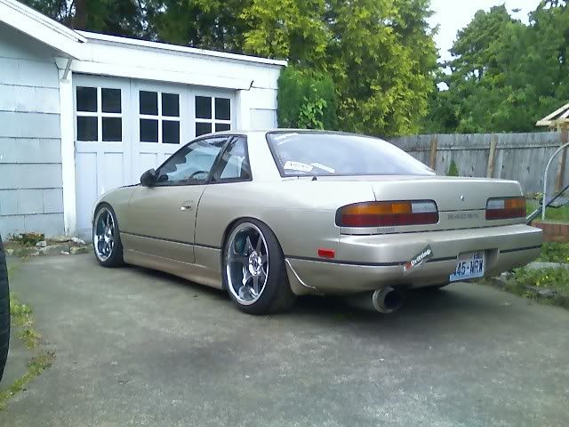

    So, bought this thing prolly around 3 years ago? I've lost track. Bought it from a local dealers back lot for $600 with a "blown motor", which turned out to be a bad mafs
    From when I first got it, after some cusco coilovers and aweful wheels:
    2nd set of wheels (15x8 +10 are straight mesh):
    3rd set of wheels, no pics on the car (15x7 +0 enkei 92)
    4th set of wheels (18x8 +20 18x9 +20 axis widetrack)

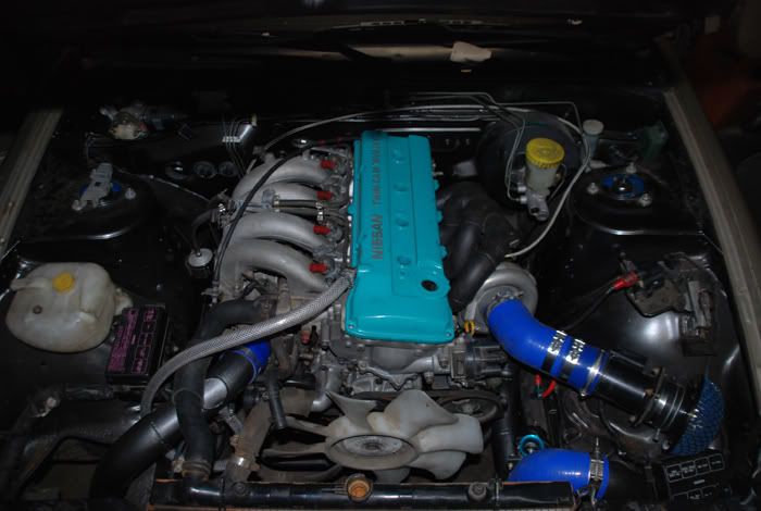

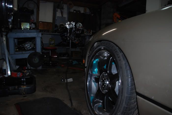

    Drove it around like that for about 6 or so months before the motor really did blow. Luckily, I had been building the ka24de out of my first s13, so I decided to drop it in
    This is kinda neat, it's a 350z clutch on an rb20 factory flywheel. Will supposedly hold up to 500hp! And at nearly half the cost of an uber horsepower set up specific to the ka24de! Look at the size difference!

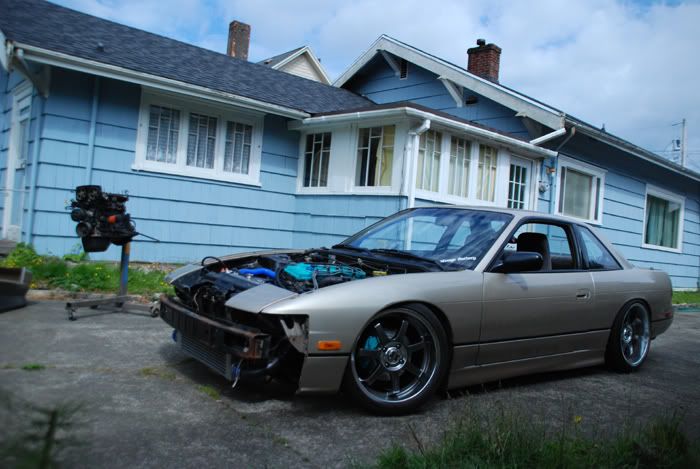

    Woohoo! All assembled... that's good right?
    No, it isn't. Because it doesn't fucking fit... Turbo hits the brake hardlines.

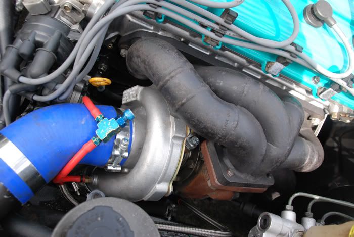

    So I sold the turbo manifold and the huge v-band t4, and went with a revhard cast manifold and a smaller t3/t4, which still didn't fit. The revhard manifold had the same exact fitment as my stainless manifold did. Even with an on-center turbo, I had no clearance! So I sold THAT setup also, and found a nice used custom manifold built by a shop in florida. Came with a nice downpipe and also a tial waste gate for $500! Couldn't pass it up, and it looks tits on the motor too!!
    So, it is currently running well. I need to sort a few little things out before I can drive it too much though. The manifold it very very close to the brake hardlines, and I am worried about the fluid boiling, which would suck. Also still running open dif, which blows terribly, and the dp is nearly touching the floorpan, so I am going to need to do some modifying there also. The car needs to be painted pretty badly too. You can see all the different shades of rattle can I used in some of the pics, lol. It's kinda pieced together, but all it really needs is paint, and it'll look super slick . (keeping the same champagne color).
