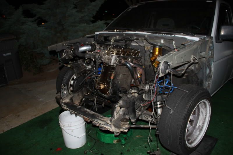

    so im the second owner of this truck and ive had it for about three years, and since its been in my possession and mostly my garage it has evolved into something completely different.
    my original plan was a dd autox slammed beater, but then i realized i want to slide the damn thing and never looked back.
    here is is when i got it 60k mile virgin stocker
    first things first make with the low
    spray bombed with te37x's
    autox
    the workshop btw thats a 67 impala frame
    first three link set up (failed)
    in front of my HS
    konig countersteer's i know i know rays sticker fail...i got them like that and since then have been removed
    og 6lug riken meshies
    revised 3 link
    autox again
    s13 intake
    random snap
    i spy a bozo tip
    front coilover set up
    was turbo for a little then blew up (fail)
    so motor swap time =]
    went with a stock s13 ka24e...dont worry fellas i got something BIG going in soon
    high angle steering knuckles =]
    push button start and panel
    integra da strut bar hydro handle WTF? lol
    diy over fenders
    pathy front
    super loud side exit exhaust

    oh sorry i forgot to mention my future plans....
    my boss has an sc400 thats getting scrapped im getting the motor and harness for free .....wut? 1uzfe drift d21? =]
    have my cage paid for gotta go get it installed
    s13 front suspension
    toyota 5 lug rear axle with disk breaks
    w58 swap
    1 piece driveshaft
    new bucket seats
    hella dope fitted wheels
    and of course MOAR LOW LOW

    i like this, but your rear suspension engineering needs addressing. the first setup was really bad and the current is still not ideal. specifically, if you're building a three link, dont also have a panhard bar. the two arcs are conflicting and will end up either wrecking your joints or arms. either go with a panhard bar and a single top arm (not triangular). not both. if you've added the panhard bar because your top arm wasn't strong enough, make it stronger (it looks too weak imo). also, the chassis notch should've been done properly or reinforced better before it fails. im not ****** on this, i can just see that you like to drive it hard, and i can't believe it has been engineered like it has.
    if you've built it yourself, do more research into chassis design and setup. if someone else has built it for you, go to a different workshop in future...
