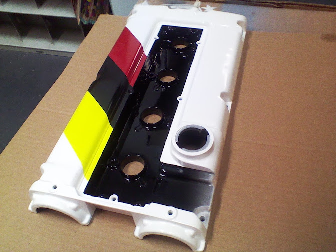

    Here is one currently, from when I bought it shaved and after some more cleaning and primer... to where it sits today awaiting more paint and then the final layers of sparklespangle and some clear coats.
    Its for a 4G63 from 90-99 in case anyone was not sure.
    Not happy with the lines, redo...
    EDIT: Also if you can include as much info as possible about what type of materials used.
    This has dupli-color high temp white base and regular indoor/outdoor red and black, and then krylon flourecent yellow. Next should be a effex mid coat and a 2 part auto clear coat finish.

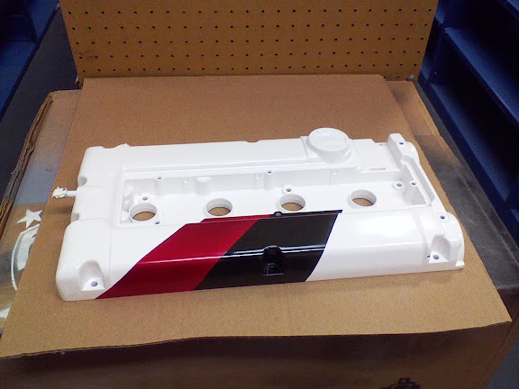

                      Had to redo the yellow and the red, redo some lines and now its all ready for a color sand, prep, and then onto final clear coats.

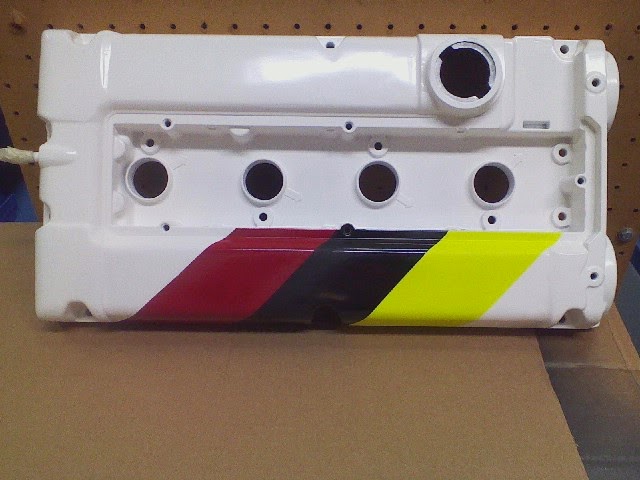

                            Here is a little more to my first one.
