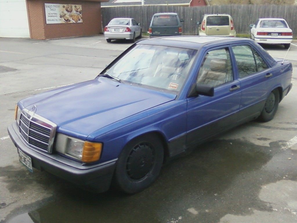

theres probably a lot more to it then that, all i know is the car still rides the same as it did before after getting 4 coils cut off all 4 corners
this is the car that brought all of this up though after i posted a picture of it on a local facebook group and all the people who have probably never had cut springs before started bitching about how bad it is to do it
the $600 '85 mercedes 190e
Fix your picture! :POriginally posted by JC.'Stance' doesn't have to be scraping your car along the floor, that is simply the scene that has caught on. As long as your car looks amazing (in your eyes) while your rolling down the street, that is your own personal perfect stance.
