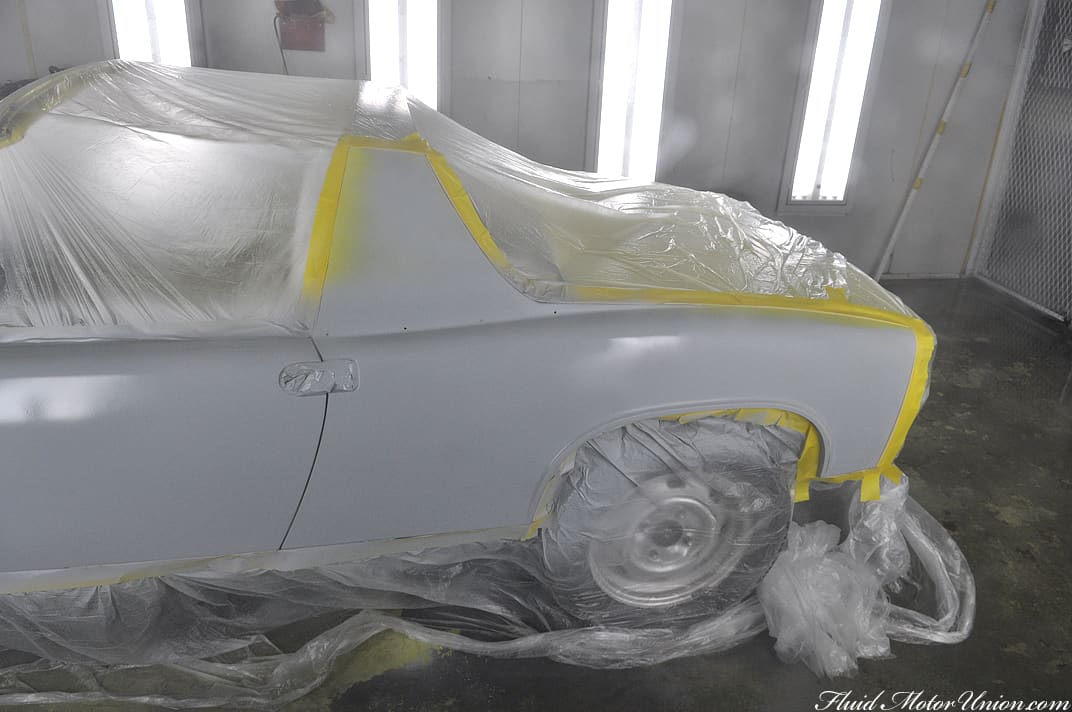

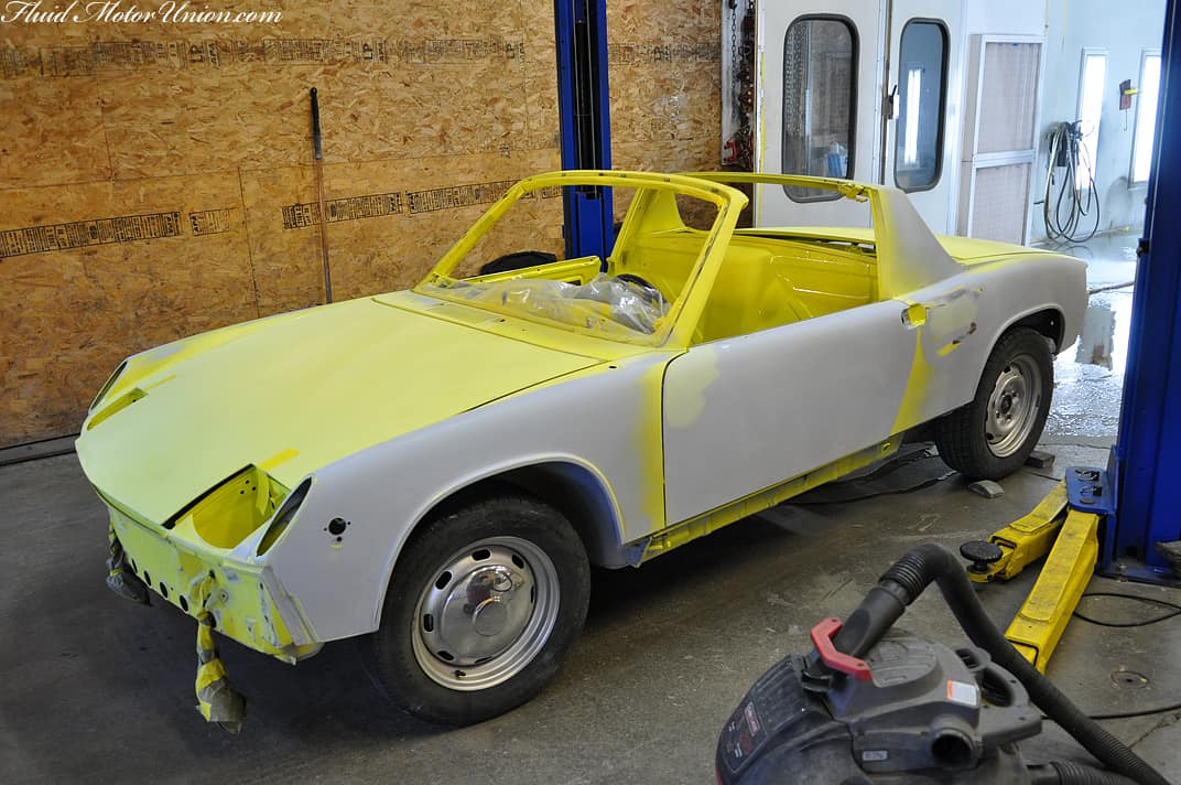

Prior to laying down the yellow coat, we had to deliver one last primer blast to the driver’s side.

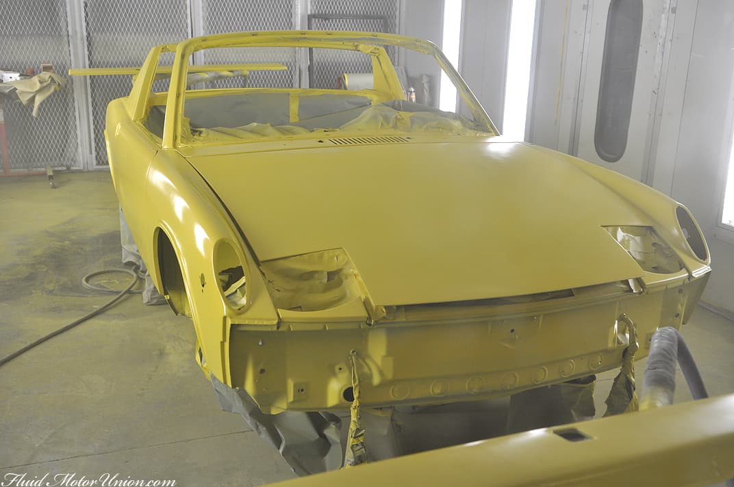

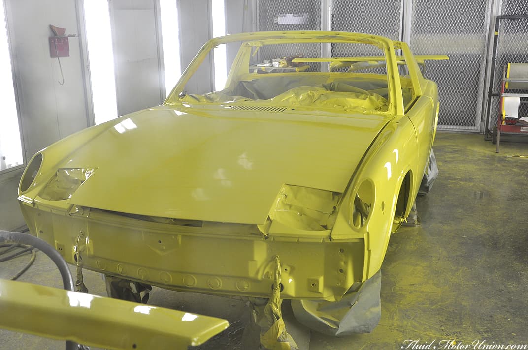

Once the primer dried, we removed the plastic sheeting from around the car. We then jacked the car up, removed the wheels and began masking every single inch of the vehicle that wouldn’t be touched by the paint — suspension components, engine bay innards, we covered it all. Once we’d used a whole country’s worth of paper and tape, we laid down the first coat of the 914’s OEM yellow tint.

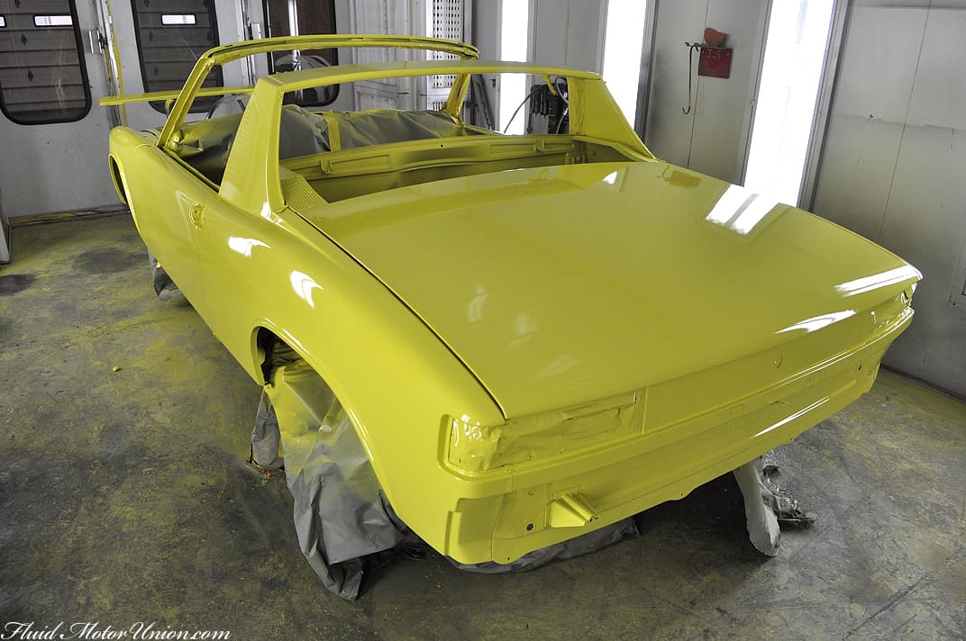

After the first coat of yellow dried, we applied more coats, as well as the clearcoat.

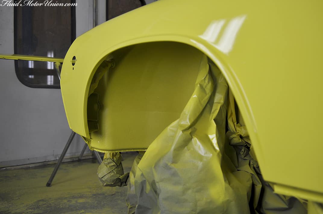

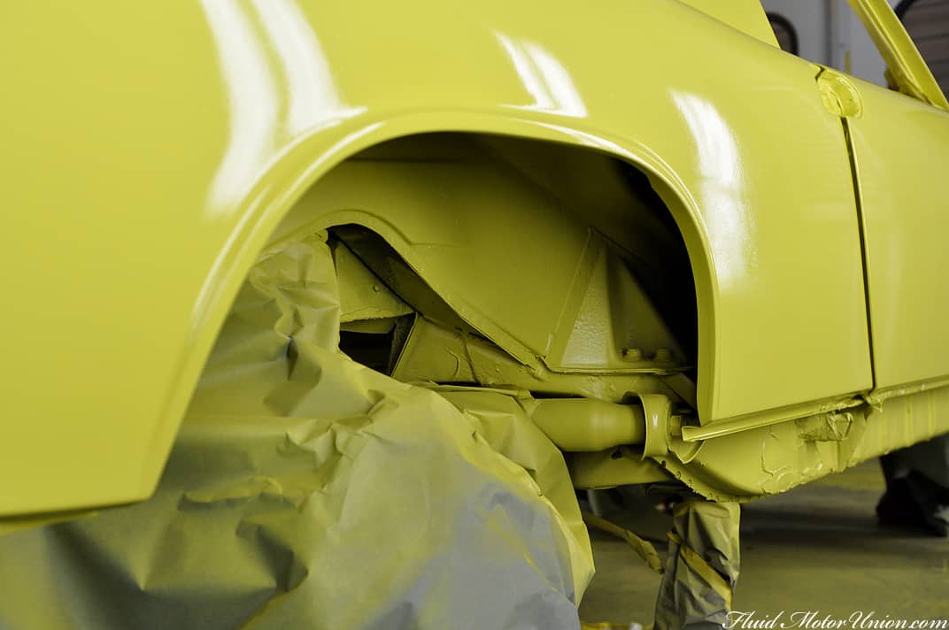

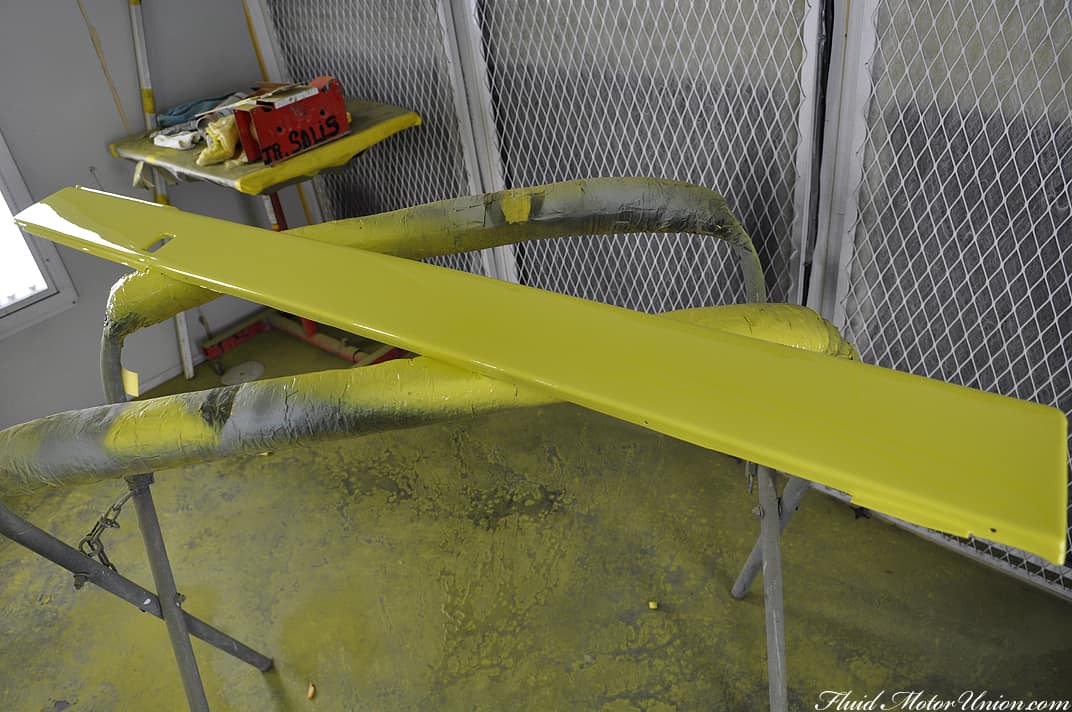

With the masking how it was, we were able to hit the fresh yellow paint on every surface that required it, including all the metal in the wheel well areas and underneath the rocker panels. We had the rocker panels removed and off to the side to be painted separately; that way, hopefully the 914’s owners will be able to stave off another rocker-based rust attack for many years to come.

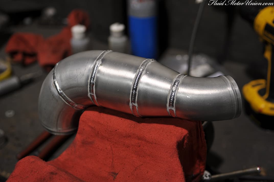

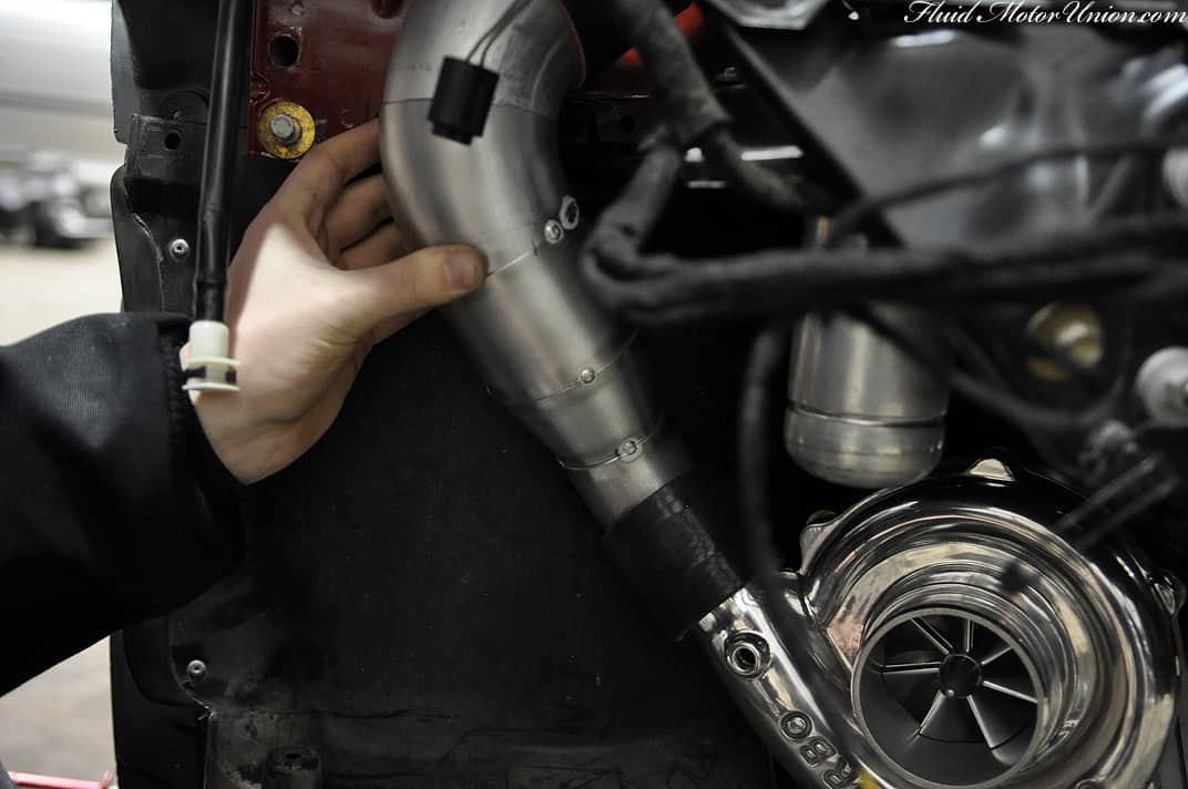

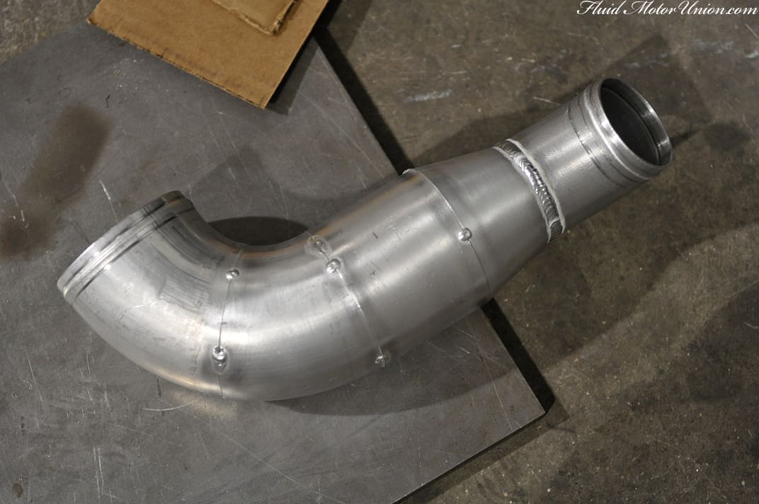

While we let the 914 dry over the weekend, we move quickly over to fabrication, where the mysterious build has a few pictures to show off. Granted, they still don’t give away much about the build, but what we can say is that we finished the pipe between the turbocharger housing and the air-to-water intercooler. The air will be compressed in the turbo, where it then moves through the intercooler to cool down and condense, finally making its way to the airbox atop the throttle bodies. It’s just a single pipe, but hey, because weld porn.

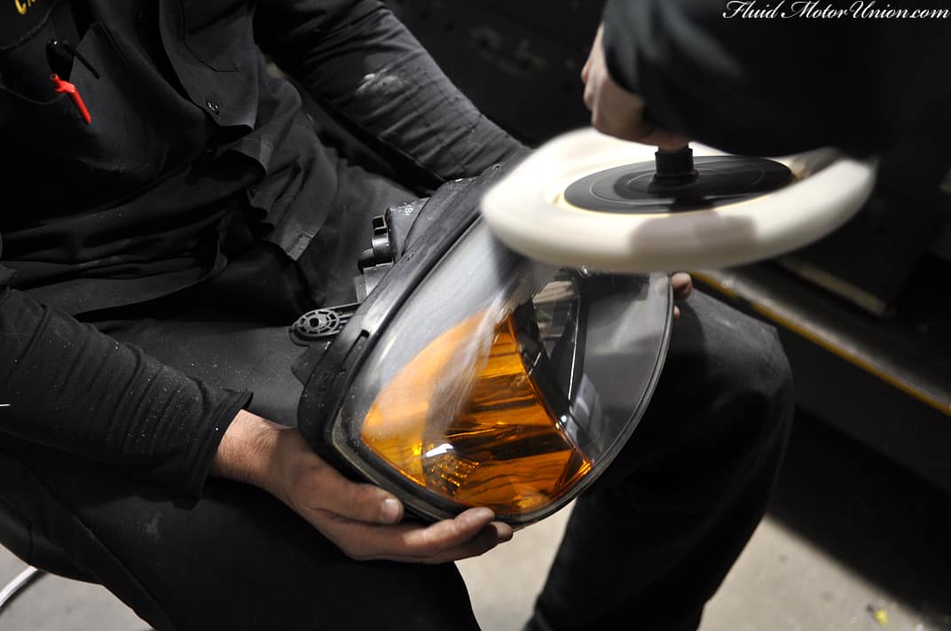

Also, we just released the Accent back to its owner, Dan, and he was blown away with the final product. We’ll have those pictures for you after the New Year’s break, but for now here’s a quick shot of us buffing up his headlights to remove the yellowing haze that appeared over them. Yeah, it’s not on the bill, but we’ll knock it out over the course of an hour since it’ll really help to improve the exterior aesthetic of the freshly bagged Accent.
