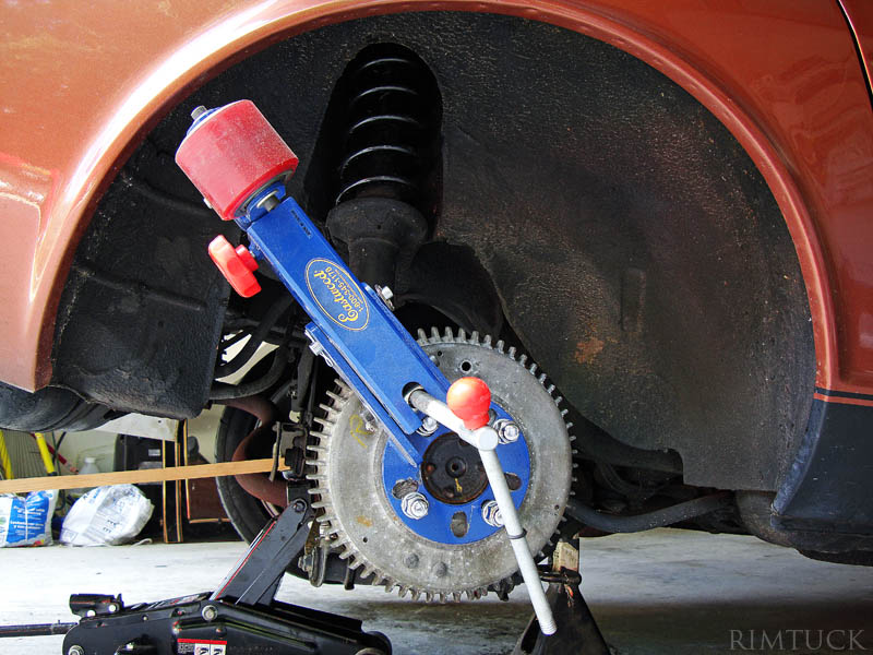

Mounting the fender roller tool:
Adding the lug nut washers:
Lug nuts on, and slightly tightened:
What the tool looks like fully mounted:
Since I'm working on the rear, the e-brakes will need to be released.
Tool is positioned with slight pressure on the panel lips.
Red knob tightened to lock the tool length in place.
Head roller angle is also tightened and locked into place:
With slight pressure already on the panel lip, rotate the tool left and right several times. Lip starts to slightly curl:
Use the lever to add more pressure on to the panel lip, and rotate the tool left and right several times again. Repeat this step until the panel lip is folded enough to clear the tire:
Some paint cracking depending how much the lip is folded:
(Paint cracking maybe reduced if a heat gun was used prior to rolling)
Fender rolling completed:
(The dimple shown is a factory spot weld, but is not visible on the outside)
Finished:
