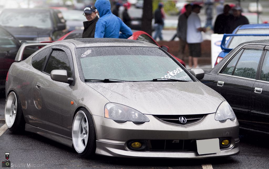

    Hello I am new to this forum and I hope I'm in the right section for this! I am a noob and need some help, I'm 17 in high school and I'm in the process of making my rsx pretty low.. I have a job and bought my car on my own and all the parts for it, I bought racelands (don't judge I'm broke) i also bought skunk2 rear camber arms and eibach front camber bolts, I plan on buying the saleen rep wheel that's 17x10+20, can I make them fit? I'm pulling and rolling my fenders, also what tire size should I run? I'm fine with a little negative camber and I'm alright with a slight stretch! I just want my stance to look good and to not look bad! If I had the money I'd buy some better wheels/coilovers but this is what I'm stuck with! So help me work with what I got I'd deeply appreciate it!

      What size tires are those on the last picture?

          I ran these wheels with my 05 RSX.
          17x10 +20 will need a decent fender roll in the front and rear. My coils were maxed out in the front and I had to bend the tabs and remove the fender liner.
          I ran a 215/40/17. You could get away with a 225/35/17 for a better stretch/fitment.
          If you have any questions, feel free to PM me.
